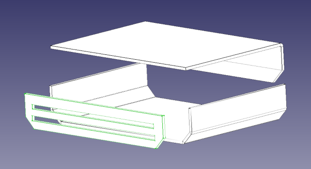

Another idea would be bent acrylic: One U shape, one L shape and a laser cut spacer for the front. Again, I don't have the equipment or experience for this, and it may be too fragile for handling. You may still need some 3D printed parts to assemble everything.
