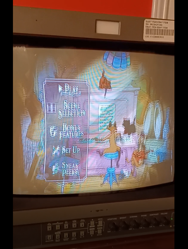

Pincushion Distortion with Sony PVM Monitor

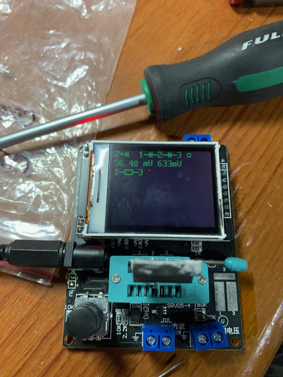

Started work on the transistors today. I have a spare "organ donor" 14M2 that I'm using to sanity check the readings on my parts
Q501
Q503
Q501 I removed, tested, tested again with the multimeter and seems fine, so nothing to see here
Q503 is helfully not in in the service manual of on the diagram, but it clearly there in real life. top work sony engineering QA team!

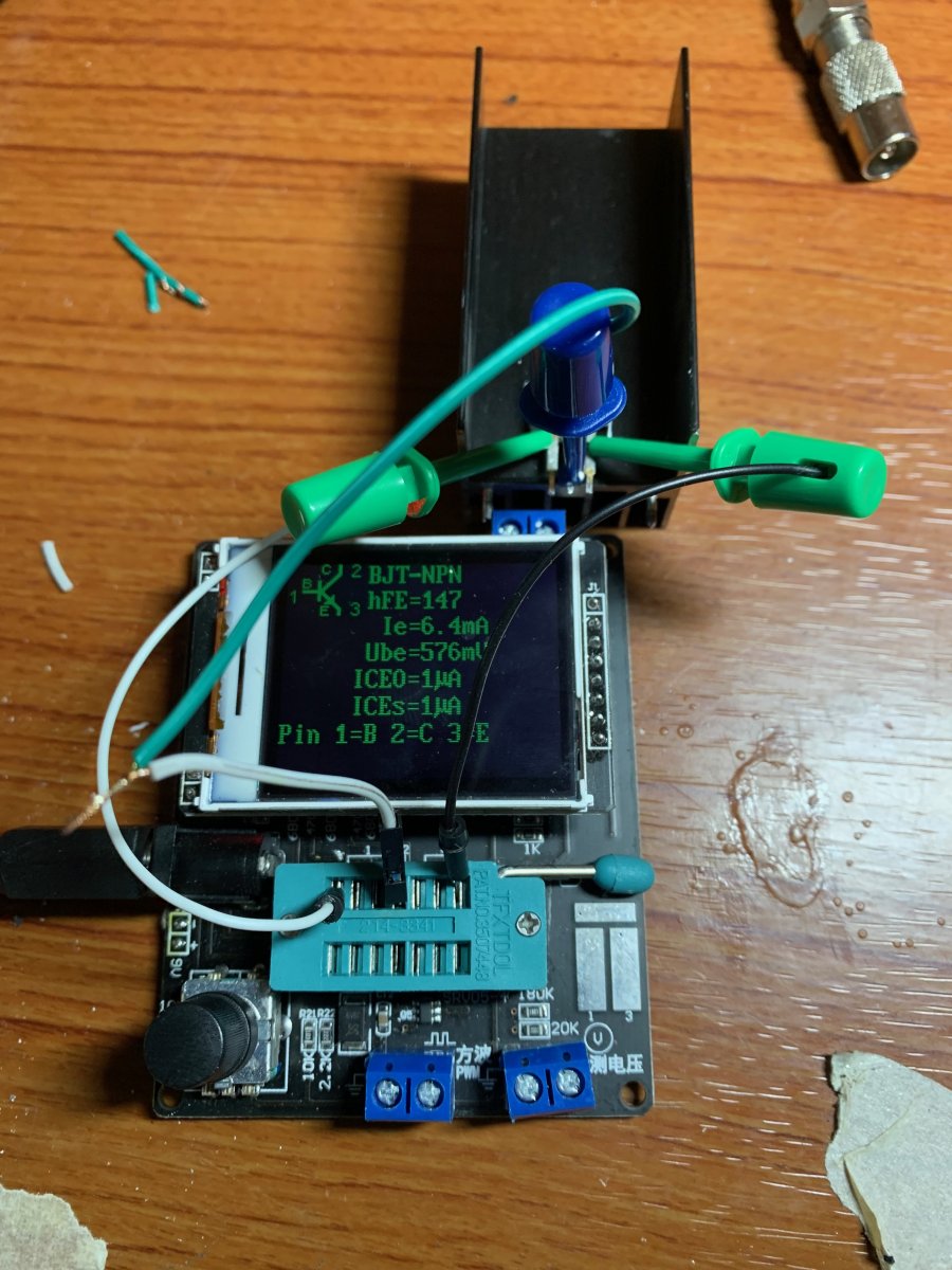

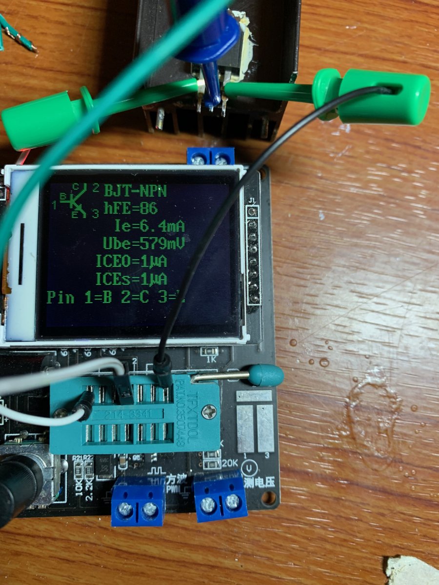

Anyhoo Q503 was a bit more interesting - its a D1133 and there are three classes
class B HFE = 60-120
class C HFE = 100 - 200
class D HFE = 160 - 320
The suspect one showed HFE = 147 and the one from spare parts showed HFE = 86 - not sure if that's the problem but I'll probably swap them around and hope fo the best.
Because if it's NOT that then it will probably be IC509 and changing that is an enormous pain

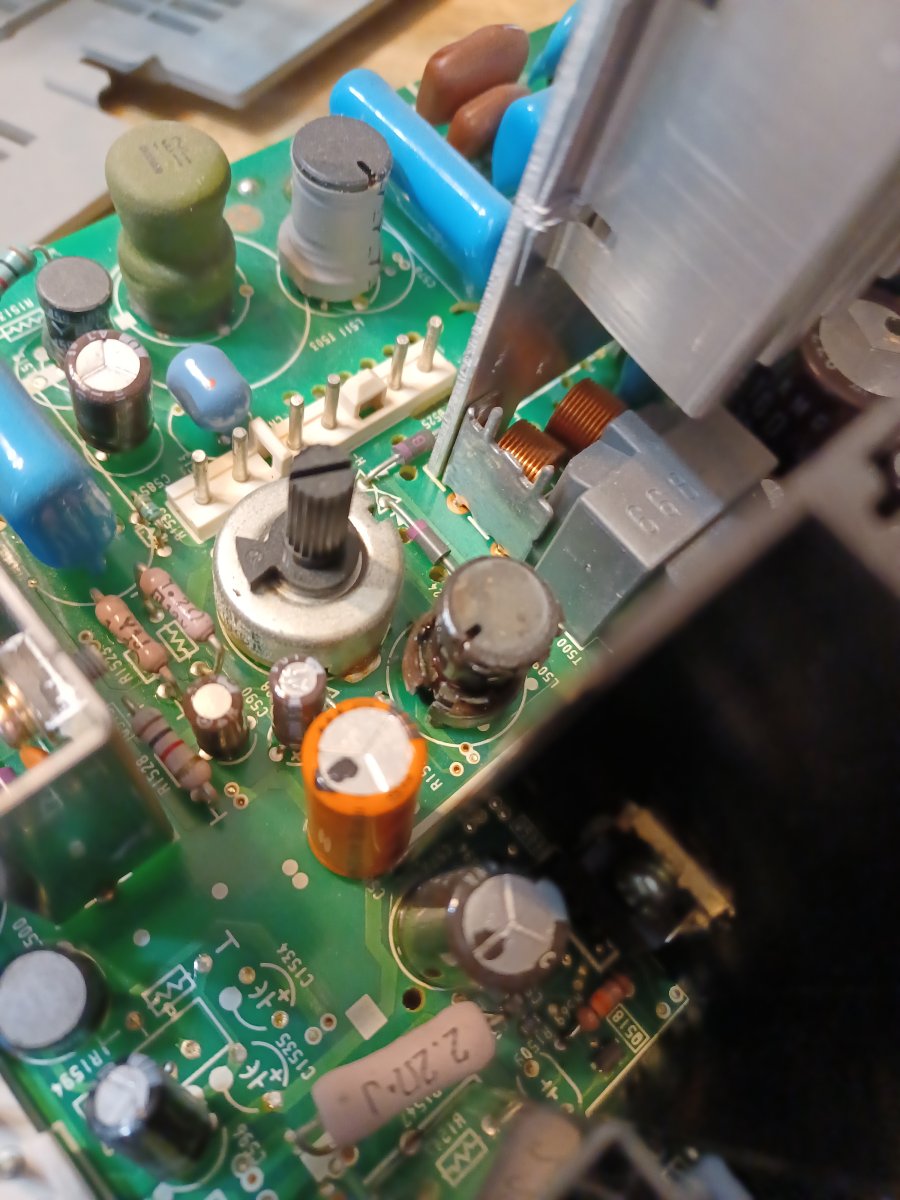

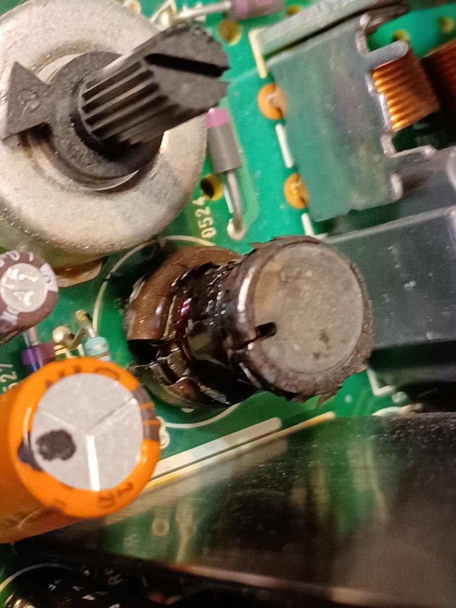

Okay, I got as much as I could off and open to get to the A board, and just going off of looks I think it's very safe to say that L509 is the problem. Just look at it! I won't be able to test it until tomorrow at the soonest, but it's clearly all torn up and busted.
Dont judge that inductor too harshly based on appearance - they very rarely (never?) fail but they often look like a dogs breakfast.
Next step is to carefully remove it, reassemble the PVM, power it back up and see if the horizontal stretch is gone

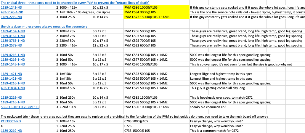

Would it be too rash of an idea to just buy new replacements for all the capacitors listed that could be faulty (L509, Q503, Q501 etc) and replace them all in one go? I can't imagine these cost very much and I'm willing to pay for them if it means eliminating the tedious testing process of opening and closing the TV over and over.
Absolutely! The shotgun approach is my normal one with these old TV's because taking them apart is such a PITA :-)
If you've got one more re-assembly/disassembly in you I strongly suggest you L509 and see what happens while you are waiting for parts tho. That will tell us if it's the transistors or the diodes that are bad
Ok great! Looking at the manual (and at my TV) I'm having trouble finding out which capacitors are of what type. Where can I go to buy replacements, and how can I tell which is which? And also, how much of this should I expect to replace by applying the shotgun method?
So there are two different things going on here
1) recapping PVM's is highly fasionable
2) our current problem (probably) has nothing to do with bad capiactors so recapping wont fix that
So if you do re-cap this monitor you can expect no improvement whatsoever to the horizontal stretch problem - for that we need to remove L509, trace the problem to either the transistor or the diodes, and replace the faulty component(s)
But if you are absolutely determined to replace those capicators here is my list - these are the same ones on the Savon Pat list.
the first column is the part numbers for www.digikey.com this should go straight into a digikey cart no problems
The second column is the quantities, only need one of each unless you plan to recap multiple monitors
the third column is the spec of the capicator. The mf (capacitance) needs to match, the v(voltage) can be the same or greater
the fourth column is the size (diameter x height x leg spacing) it's important that they ARE this size as otherwise themy may not fit in the space
the fifth column is the description of what cap they are (CXXX) this is critical information otherwise you will have a big bag of parts and no idea what needs to go where
These are really expensive caps, If i was doing this again I would use much cheaper ones for everything except C586, C584 and C572.
So you're saying that the capacitors in this list are the capacitors I've already bought from the kit assembled by Savon Pat on Ebay that I posted about a few weeks back?
Edit 2: Yes, that does look like these are the same capacitors as Savon's kit, just checked. :)

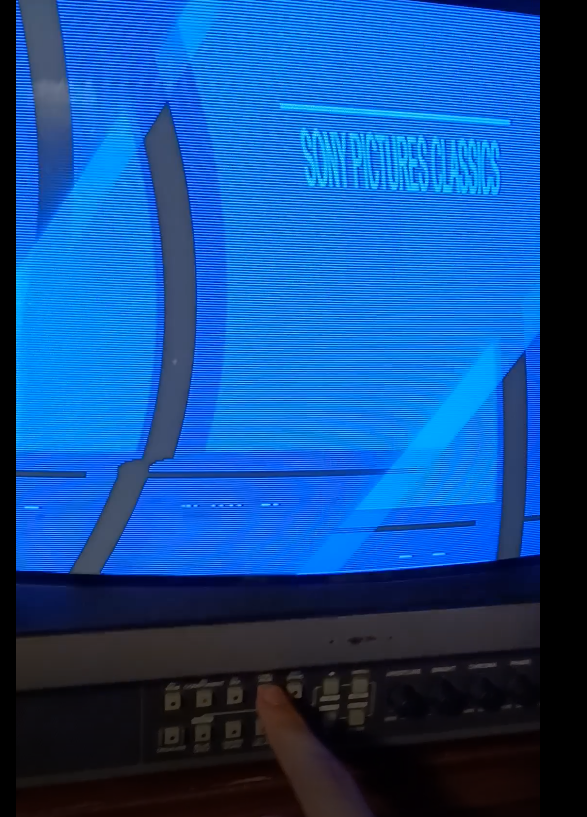

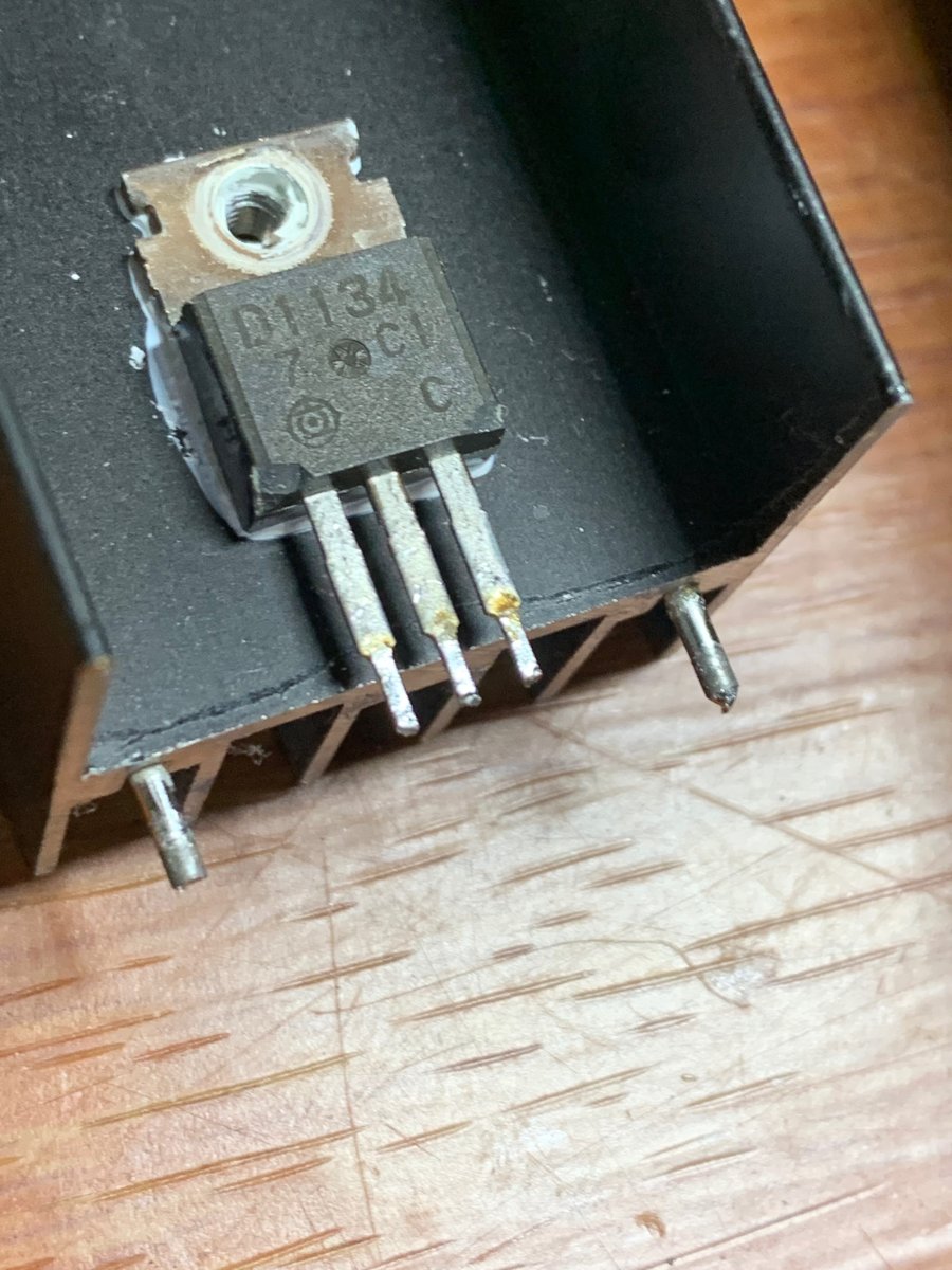

Alright, good news. I was able to get L509 out through desoldering. I reassembled the unit and tested it out. There's good news and bad news.
Good news is that the image shrunk back down to normal as seen in picture 1, so I know it's Q503 (or hopefully not IC509) that is the problem.

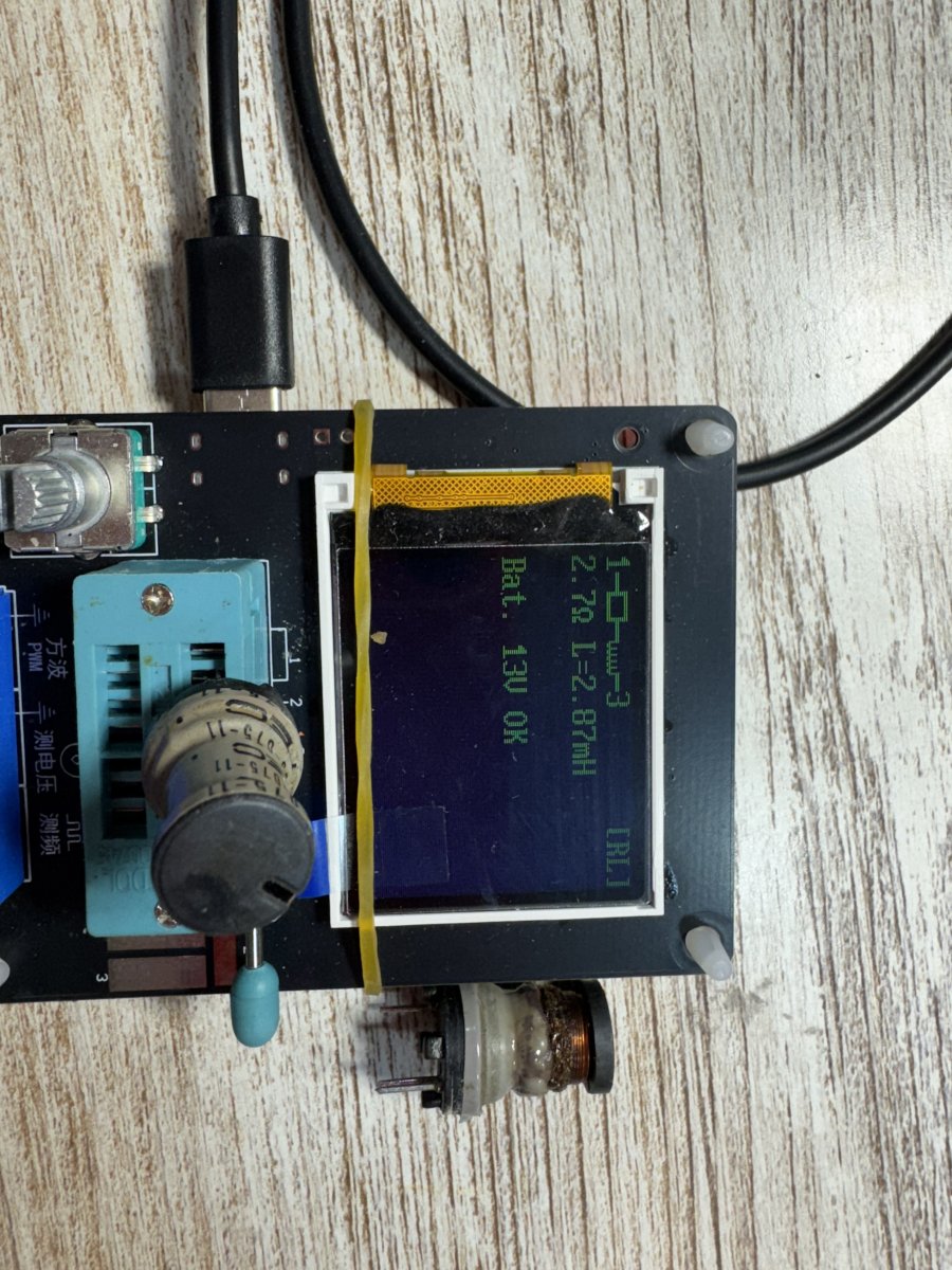

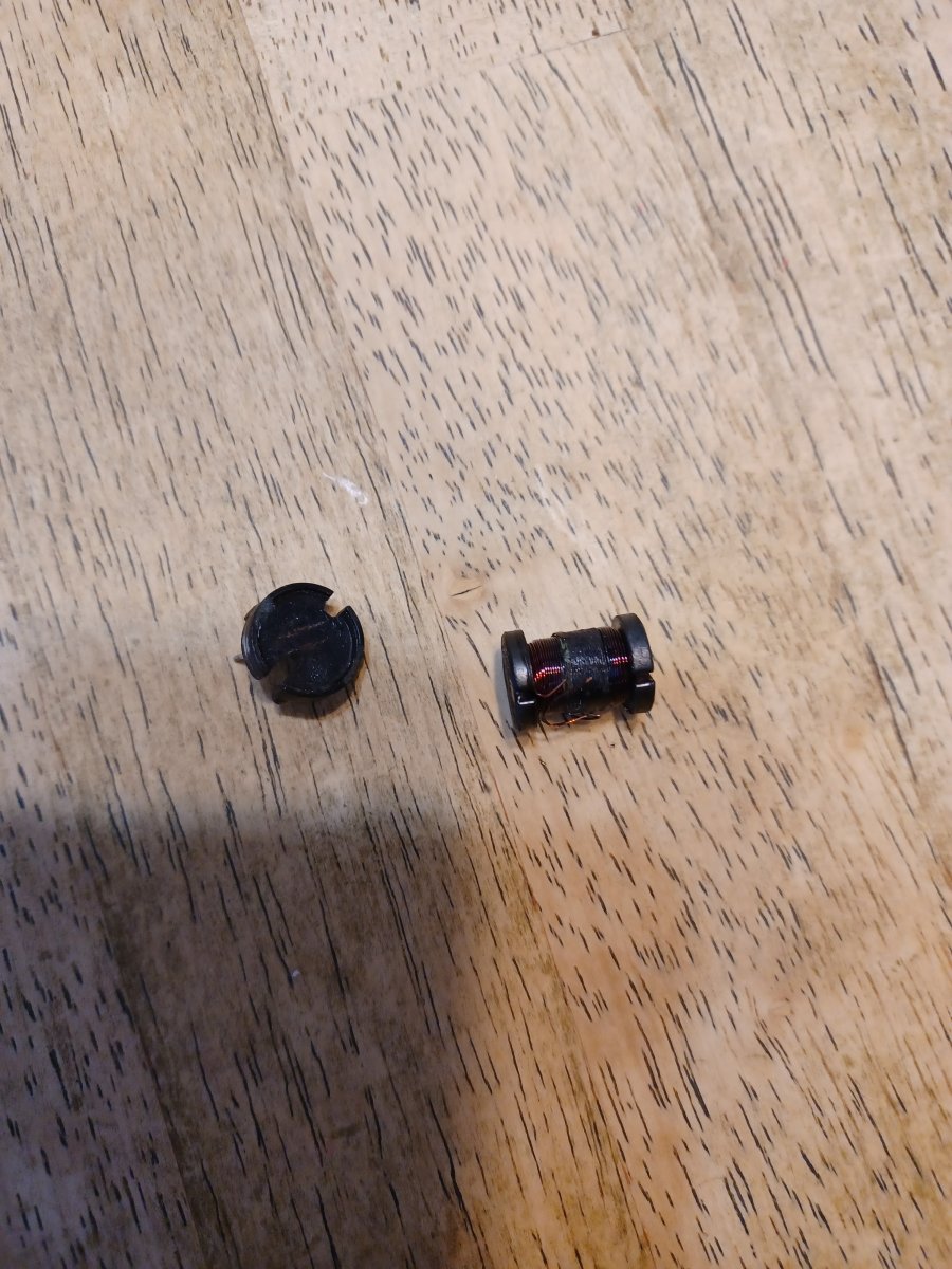

First bad news is that I believe L509 has broken. it snapped when I pulled it out, seen in picture 2. Do you know where I can get a new one (if it is broken?)

So, I think that leaves me with nothing else to ask but where can I buy Q503, since it's not listed on the service manual?

Wow, lots going on here!
Lets start with Q503 which is a hitachi 2SD1134 like this one https://pdf1.alldatasheet.com/datasheet-pdf/view/62992/HITACHI/2SD1134.html
These are hard to buy from the big component suppliers, but they are all over ebay and aliexpress
this guy claims to have the genuine sony part https://www.ebay.com/itm/384401334353?hash=item59801ae051:g:DV4AAOSwA~phRa0u
or these ones maybe https://www.ebay.com/itm/282404630019?hash=item41c0a0ae03:g:D7MAAOSw32lY0X2n
Before buying new one it would be worth testing the existing one to make sure it actually is faulty. These do actually test out as a proper transistor on a multimeter so it should be reasonably easy to test it (unlike Q501...)
The inductor L509 is going to be harder. I've never actually seen one break before; I thought they were pretty much indestructible.
It's going to need to be replaced - luckily inductors havent changed much in the last 50 years so once you know what you're looking for it should be not-too-awful to source a new one
The sony part number is 1-459-075-11 - what we need is the value.
Normally it would be OK just to read this off the top of the component - but I cant make out the markings on yours. will check mine tomorrow and have a look. In the meantime someone on this forum might know right away https://shmups.system11.org/viewforum.php?f=6
Suggest not worrying too much about the component input or sound just yet, that geometry is the key thing at the moment.
the inductor doesnt look broken, just pulled apart - you can glue the shield back on it.

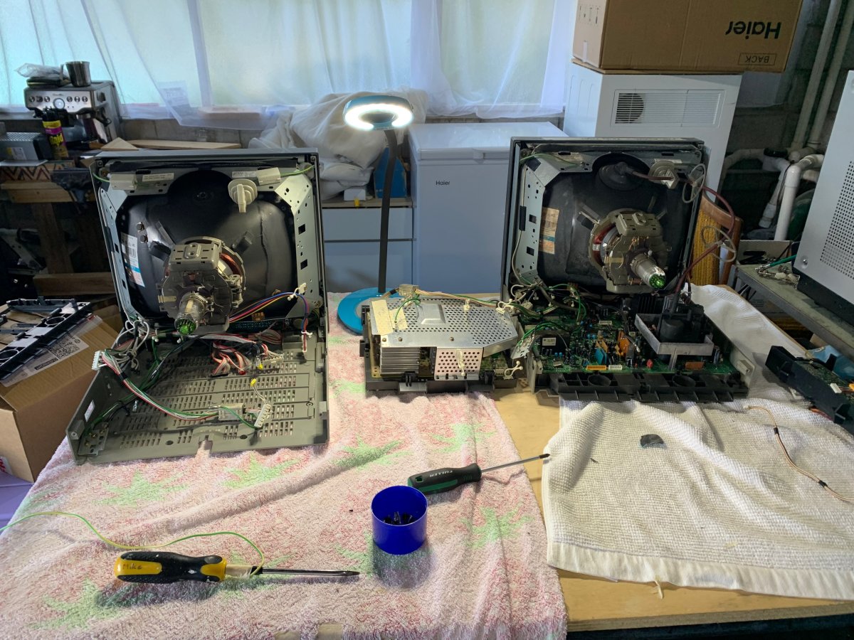

@hatmoose Were there any more installments in this adventure? I've got two 14M4A's that each have different problems, one won't sync on a PAL signal, and misses the first 20% of an NTSC one, the other has this pincushion issue - basically identical. I looked at the board and came to the same conclusion with respect to IC509... I don't have a hot air station atm and the idea of trying to get to the bugger is not appealing in the least.

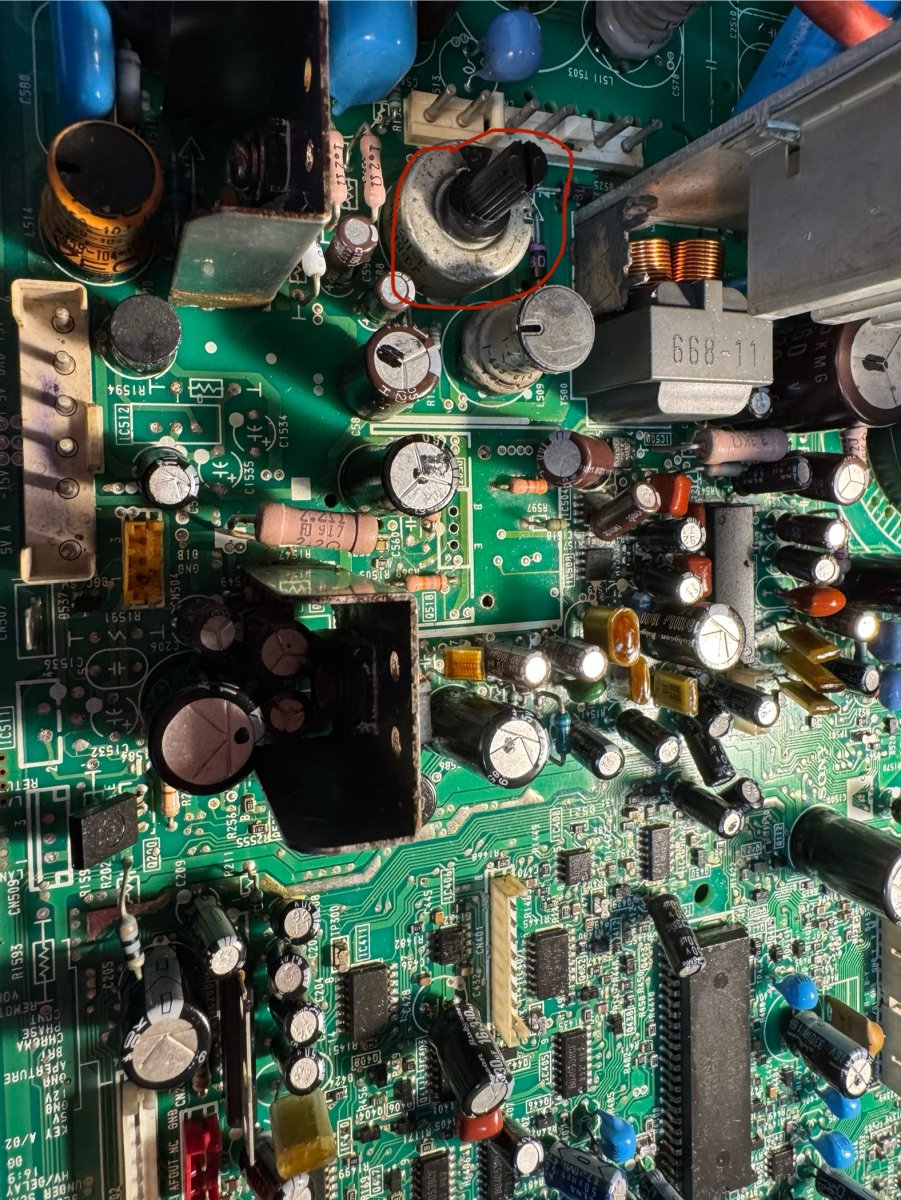

I noticed that in my case, the positive leg of C579 had a lifted pad. Initially, I didn't think too much of this because it was still in continuity with the next part over, R1508. However once I checked the schematics, I realized that this meant that the via wasn't connecting on the other side of the board, and it was directly connected to the Vcc of IC509 =O.
I checked for continuity between the positive leg of C579 and pin 8 of the IC (very difficult as this was underneath the capacitor, used a jumper wire attached to my probes) and confirmed no continuity. So I wrapped a resistor leg around the joint and added a bit more solder to make a good joint, confirmed continuity and when I fired it up, it was fixed!
Here are some pictures
Now from my understanding, this circuit can fail at a few different points, this just happened to be where mine failed. Its best to start at the diodes and work your way from there. I'd start by looking for any short paths to ground across D506, D502, D512 and C525, as well as C514 and C2510. You can do this by checking the resistance across the components using the heatsink of Q501 like this: from the red circle to the four yellow circles, as well as across A and B. You can also do this across the legs of C514 and C2510, resistance should be in the kiloohms or higher (mine was about 53kohms). Also thank you to MKL over at the Shmups forum!

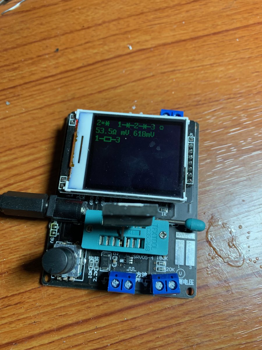

Q503 can also be tested with a multimeter in diode mode once removed from the board. With the red probe on the left leg and the black probe on the middle and then the right leg. You should notice around 0.5-0.7v, with the latter combination being slightly higher. All other combinations should show O/L.
I'd recommend one of the cheap component testers from Aliexpress (like the one @hatmoose has above) if you're looking to desolder and individually test components. They're worth every penny.

In the image there is an element circled in red. If the inductor burns, this element may become misaligned. As soon as I can, I will check its value. Checking the resistance is enough.
