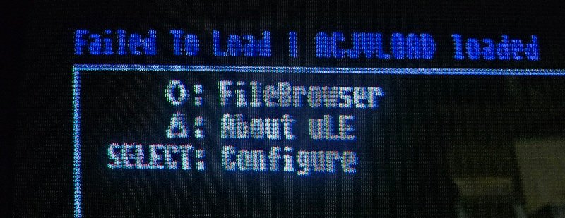

This is the error message, pressing buttons or joystick on the control panel has no effect. I don't have a PS2 pad to plug in.

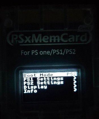

For "Boot Mode" it only offers PS1 or PS2, chose the latter.

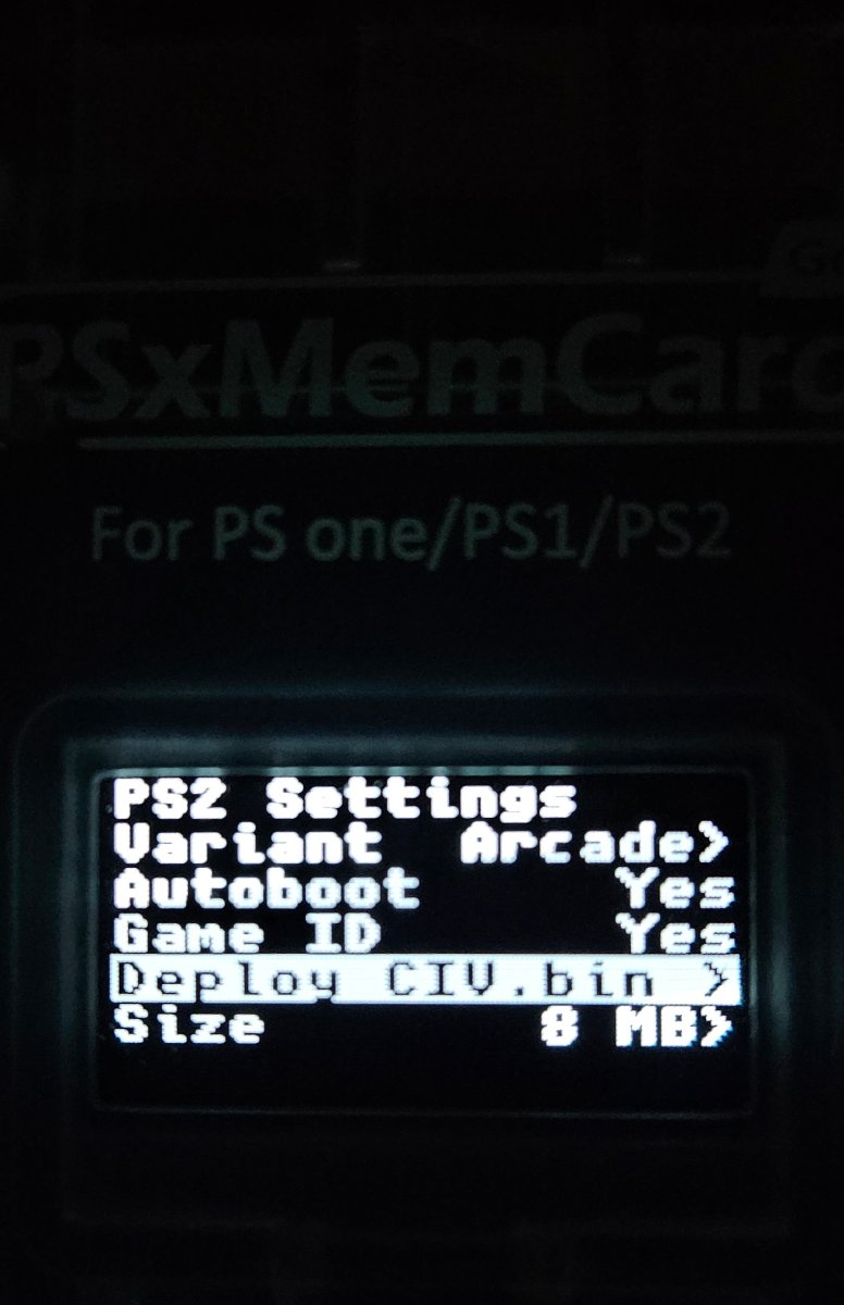

Under PS2 settings it gives me the option to choose the variant "Arcade," so I did. The civ.bin file says it was deployed successfully. Not sure what size to choose at the end.

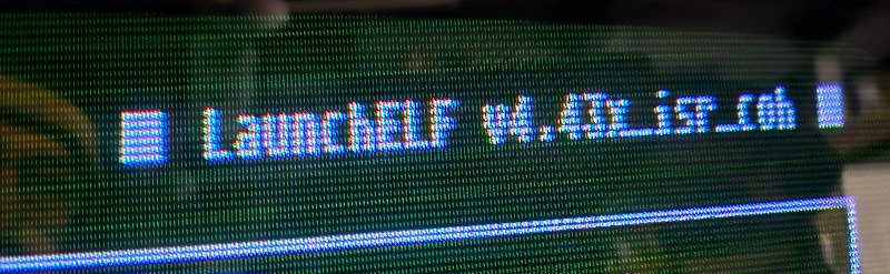

There is no error message there, the card booted wLaunchELF for arcades, Wich is informing on that message it could not load it's config file and that the video display firmware was successfully uploaded
Okie dokie. Well, how do I move forward? Is there a way to correct the issue with not loading its config file? Do I have to find a PS2 pad to manually close out this dialog?

4. Deploy CIV in the menu under PS2.

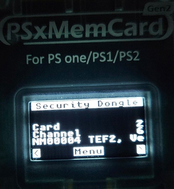

3. select the dongle you want to boot
