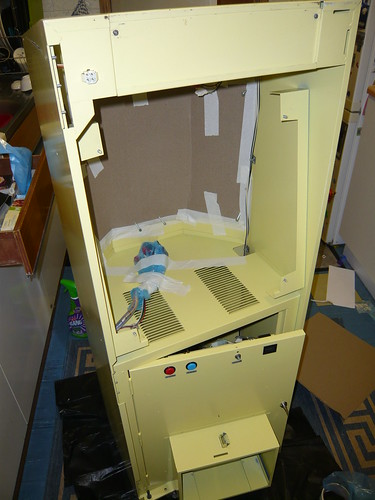

Since the back of this arcade is removable (cardboard area in images) one compromise could be to create a back panel that accommodates the larger monitor and keeps all other dimensions of the arcade near to the original. This piece can be optional and be switched with one that would fit flush if using a smaller monitor. The new panel can even be designed to maintain the patterning capability of the arcade (lining them up back to back or in a circle.
All this is assuming that there is no other way to fit in the K7000 and the dimensions must change.
