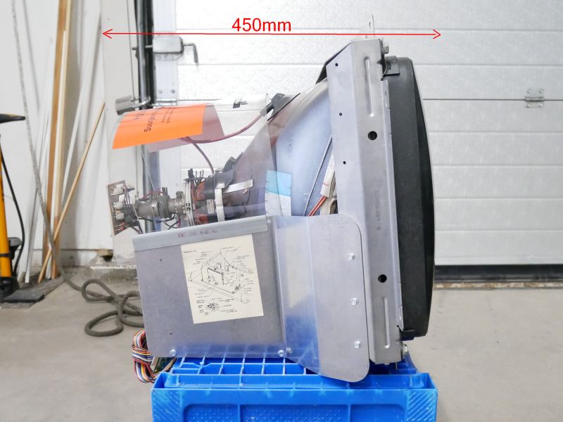

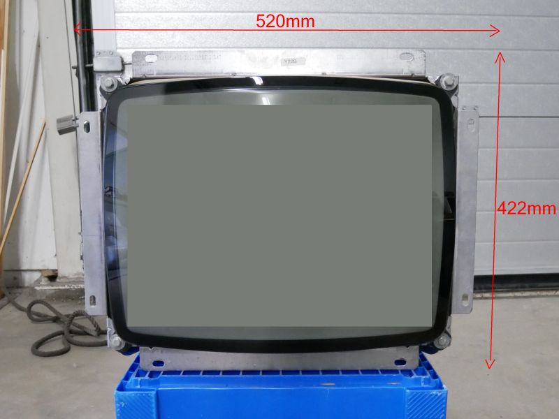

a tray fastned to the tube.
Is this not, almost exactly what a frame is? It's big metal bit, fastened to tube, that holds the chassis. Which is what we've been talking about, and hursit has been talking about redesigning.
But what we do know is the orginal frame won't fit in the cab. You yourself confirmed this.

if the frame grounds the tube and you want to leave the frame off why not just run a big wire from where the frame normally attaches?
I'm of the opinion that leaving the frame off is the worst of the possible options.
It'd be best to first find out if the frame will fit or not. Then if not: make a new one. Because as I mentioned before, going frameless means at least one person is going to neck this thing. It happens enough in cabs that are designed with a mech, nevermind loose ones if the wires are improperly routed (and since they're being assembled at home, seems like an easy oversight).
