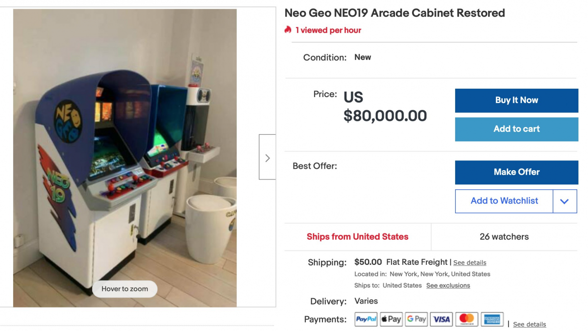

Nah, you're definitely not wrong. Some people collect stamps. Some people collect PCBs. Some people collect being kicked out of communities. He was booted from KLOV, so he came to Pinside. He was permanently banned there (which is hard to do, Robin is a softie). He got run out of NeoGaf, and those people made it mean, because well, it's NeoGaf. That's what they do. Then someone sent me this tonight:
Same old story. This has been going on for years and years now, nothing changes. Anyways, he's not that interesting, but it is funny to me that I was mocking some idiot for that $80k auction recently and then found out exactly who that idiot was. He's not someone you want to associate with or have anywhere near your hobby, drama always follows. I shouldn't even talk about him, he'll probably rant about me on his podcast again. Anyways, good for you making sure that he didn't vulture up another community resource.

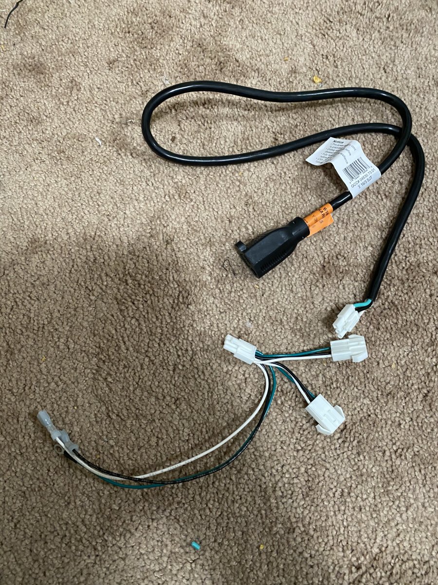

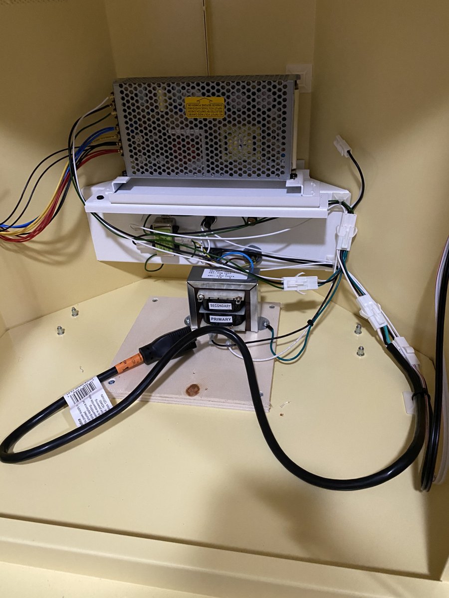

Mine arrived Saturday morning. Unpacked and laid everything out. Thankfully the kids went to a friend's house most of the day Sunday, so was able to knock out assembly. Can't wait to get the last remaining pieces in (monitor, iso and iso harness) and have this up and running! Planning on putting Daimakaimura (Ghouls n Ghosts) in initially. Might do a switcher as well to do some classics, neo geo and shumps. Not a ton of room to mount several boards, but we'll see what fits.

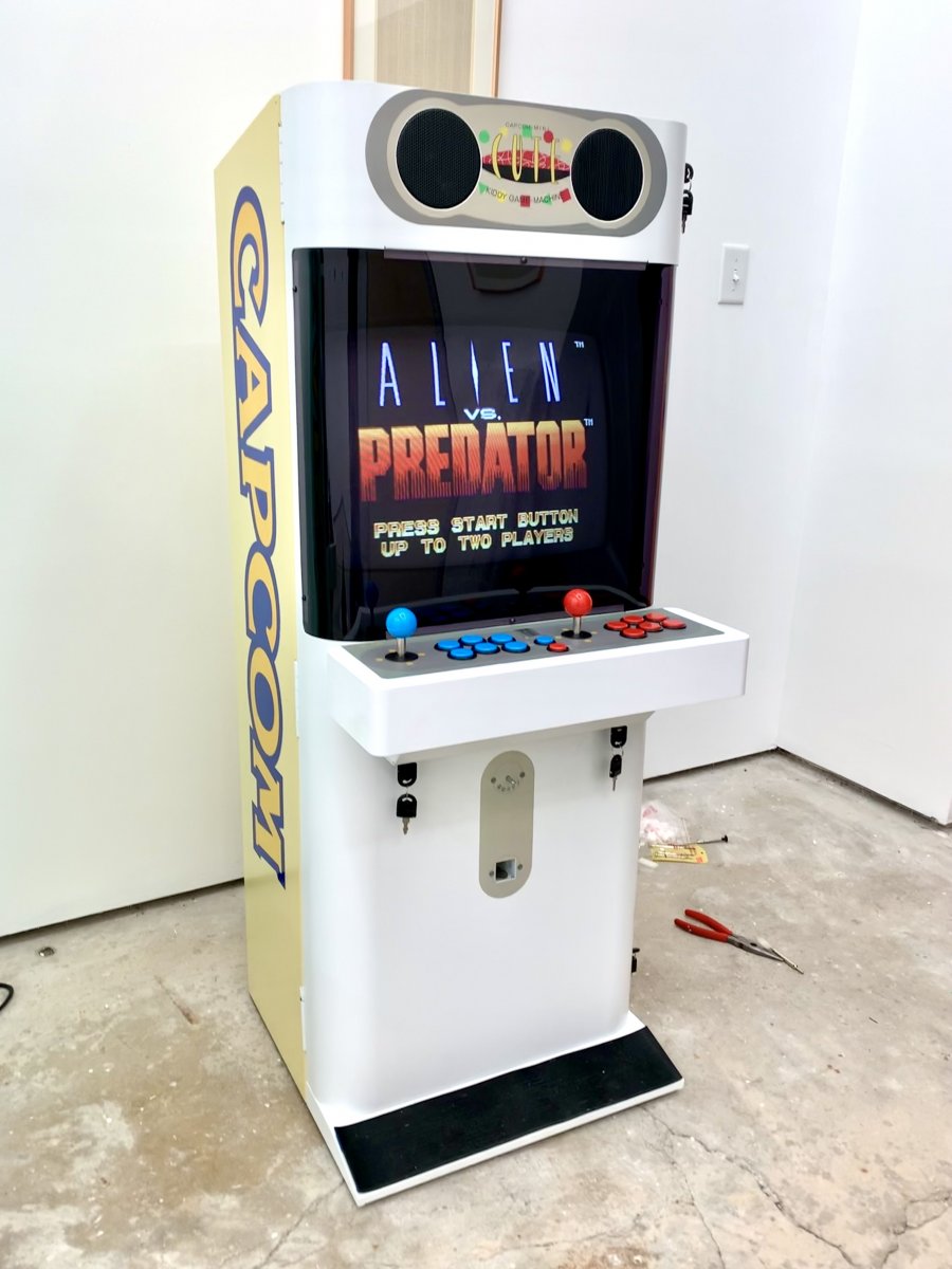

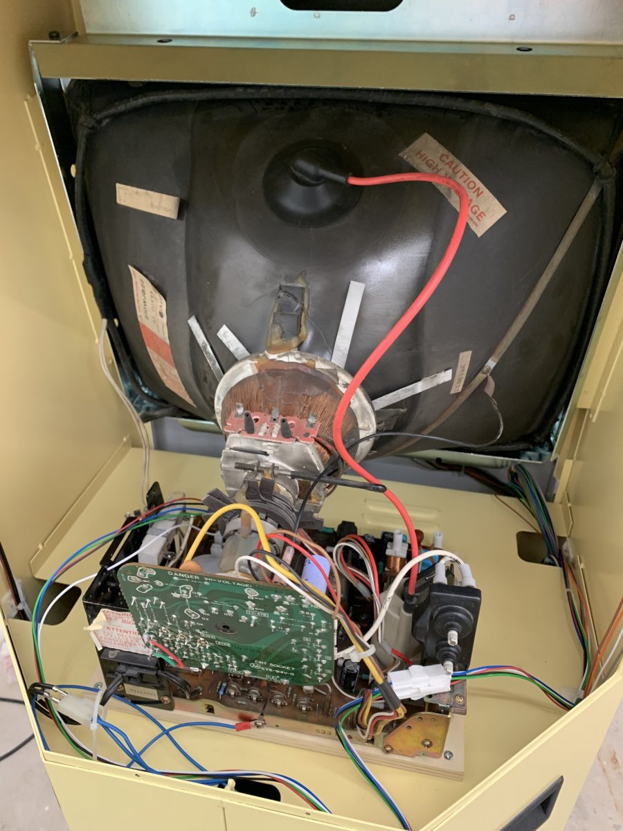

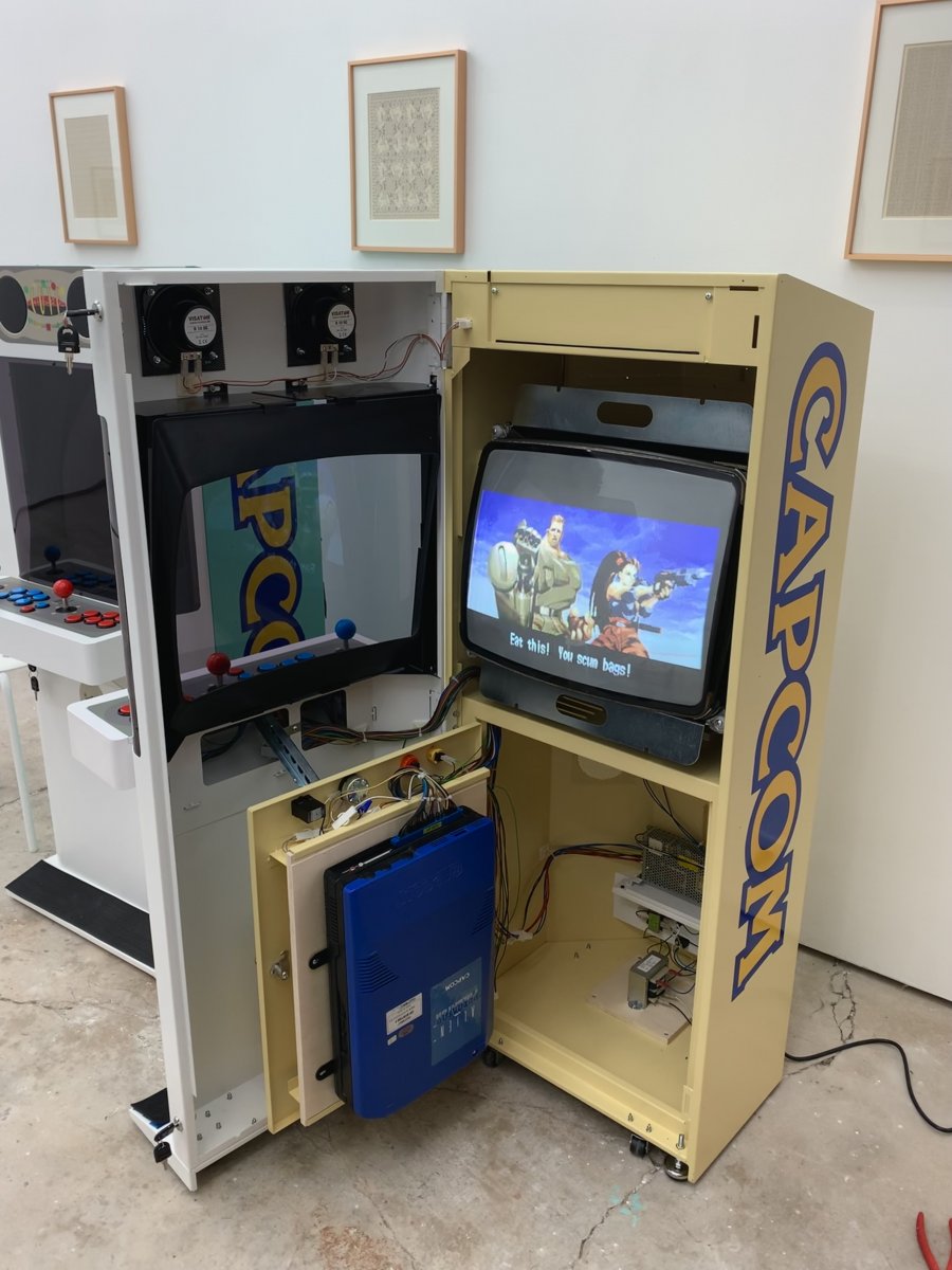

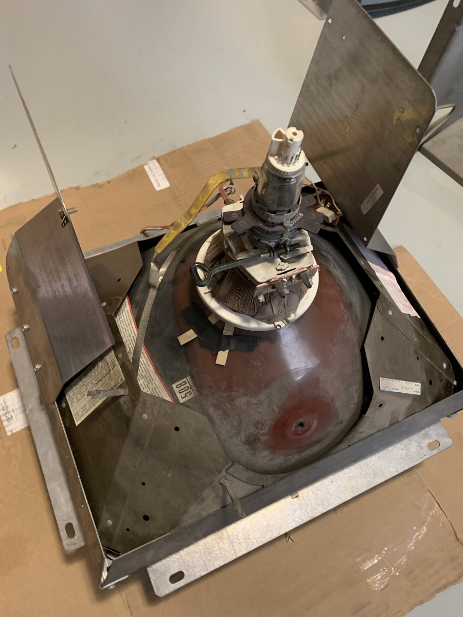

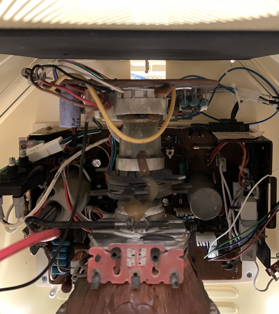

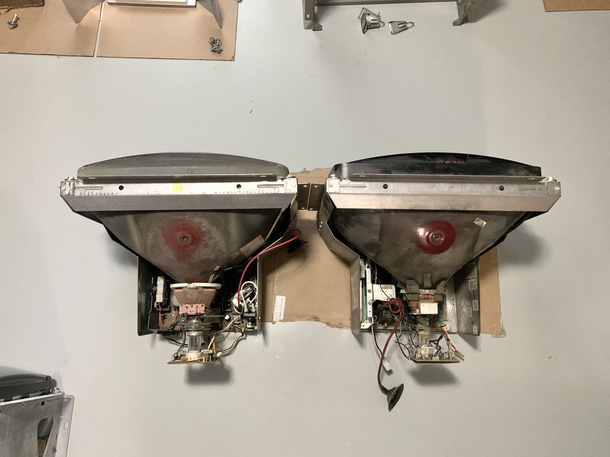

Okay, I think this will be helpful to people. While working on some monitors last night I lined up a G07 tube next to a K7000 tube and noticed they were nearly identical in terms of depth. Just to be sure, I swapped the G07 into an extra K7000 frame I had sitting around and measured them front to back -there was maybe an 1/8 inch difference. For the sake of research, I went ahead and pulled the K7000 from one of my Mini Cutes and removed it from the provided frame and replaced it with a G07. The G07 chassis is about 3/4 inch wider than the K7000 chassis, and while it could still barely fit within the wings, I didn't want to run the risk of having a live HOT touching the frame, so I removed the wings and installed the chassis on the wood. I got the monitor in and the chassis hooked up (I had to redo the RGB/Sync plugs to work with the G07). It works great! I managed to get my phone in past the installed monitor to take a picture showing the clearance to the back of the machine - fits perfectly. So there you go, hopefully that helps expand possibilities for people searching for a monitor!
One caveat – some G07s come with the degaussing coil directly attached to the tube and others with the degaussing coil mounted to a metal shroud that goes over the tube. The ones with the shroud are just barely too big to fit inside the K7000 frame (see picture). To use that version, you would have to pull the degaussing coil and adapter from the shroud and install it directly on the tube.
