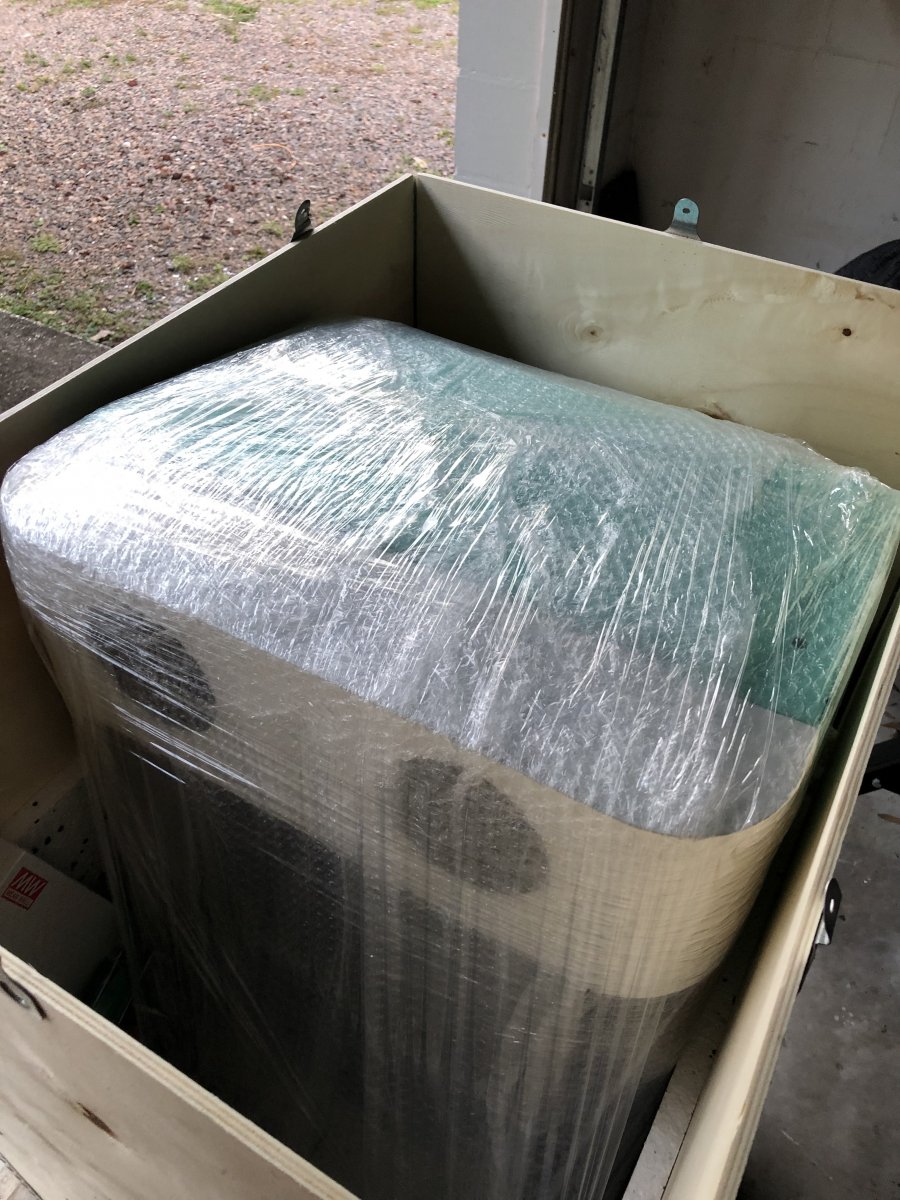

I got word it’s on route today. I picked the worst time to go on vacation to LA

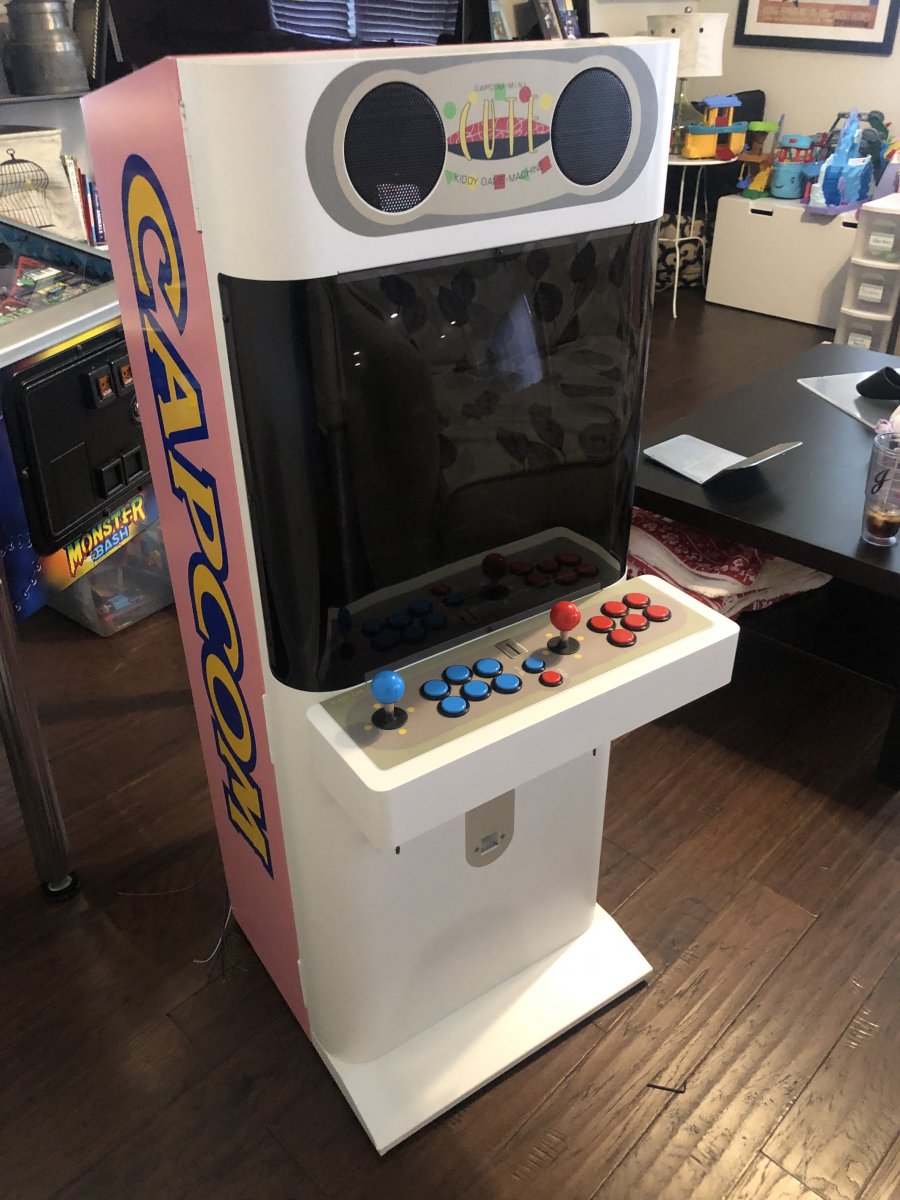

This one guy showed me and @Derick2k a readily available 19” LCD that supported 6x integer on the future OSSC Pro and OSSC Mister companion. I need to clean my inbox...I fit my old 19" LCD computer monitor inside the frame kinda like this guy:
View: https://www.youtube.com/watch?v=Bbbq00_G-Aw
it's not the best fit, but definitely gets the job done. There might be better options depending on your monitor too.
I used a gbs 8200. I'm powering it with 5v from the PSU, and at least with cps2 games, I need a 100 ohm resistor between the sync and ground on the 5 pin rbgs connector. Just wrap one leg around each pin. This looked "good enough" for sure.
I later upgraded to a gbs control and no longer needed the resistor. The image gets better resolution and it's just easier to configure the gbs control compared to the gbs 8200 by itself.
