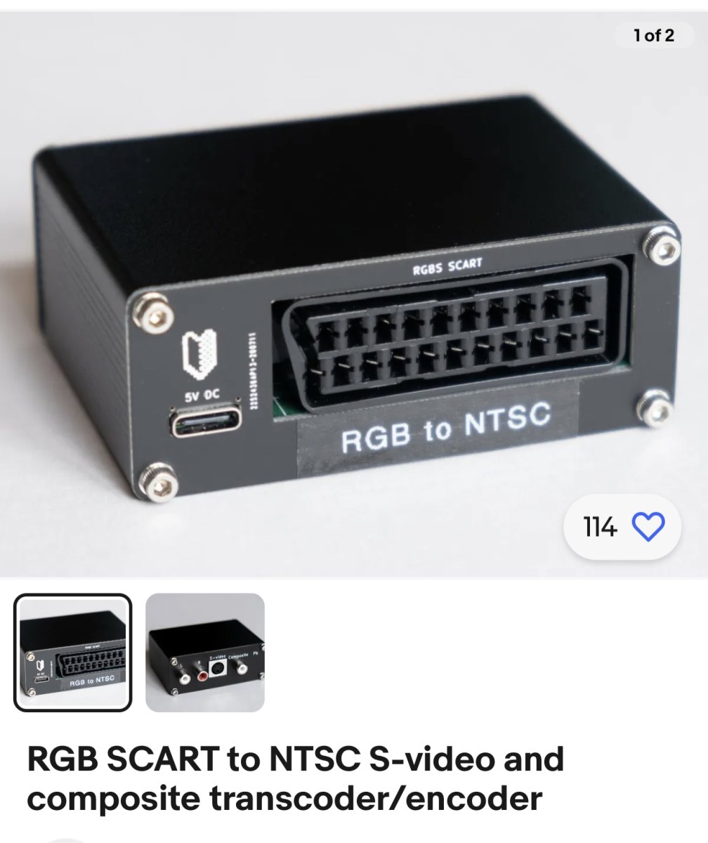

It was an RGB SCART to NTSC S video converter.
This one on eBay which is supposed to be really good. I tried two different cables with the converter composite cables and S video, and it gave me the same result with a Black and White image

Are you using an RGB SCART cable? And not a SCART composite cable?
If it's an RGB SCART cable is it c-sync or composite sync?
Why can't you use a Genesis 2 composite cable right from the supergun (no adapter needed)? Have you tried this?
I am using the RGB SCART cable and the converter. I tried Genesis 2 composite before and I got no image thats why I got the converter and the RGB cable. The TV is not really getting a signal other than the B/W image with the RGB SCART cable and the converter.
That means it's only getting the luma signal.
I'll try to find a composite cable and see how the minigun performs with it. I suspect composite should come out since the hd retrovision cables work with the minigun. I believe they require composite to sync.
