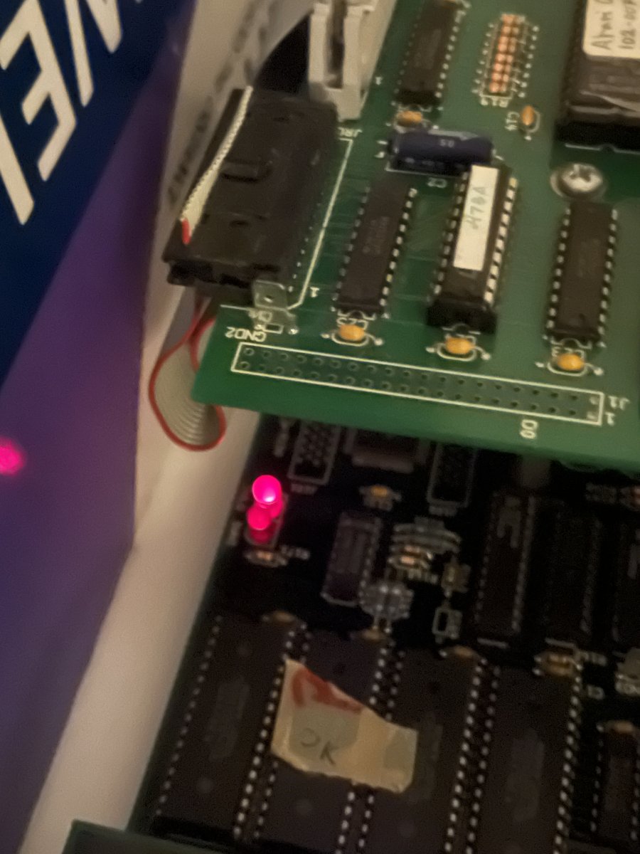

Yeah, I took a picture of the LEDs. Only the 5VLO was turning on along with the green light for the sound board. While the one marked 5VHI stays off.
New Edit: I’m pretty much eyeing to buy the HAS next, but waiting for them to open up and start selling them again. The HAS doesn’t have a USB port from what I can see for my Hitbox, so the next issue besides getting a new power supply for that is getting my Hitbox controller to work with it.
Well 5v hi only turns on if the voltage is too high (so you would adjust the 5v lower if that happened). You basically want neither 5vhi nor 5vlo lit. But that power supply has no chance on a board that big.

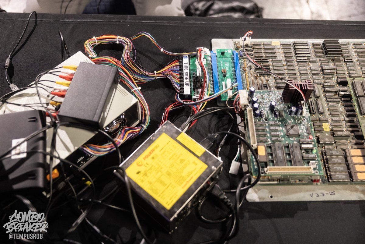

Wow good to know. Combo Breaker had all sorts of issues with that board, so I don’t blame them. They originally only had two boards and one of them was the original revision before 2.3 and they had to contact Galloping Ghosts just to get someone to send another working 2.3 board.

Fwiw I believe the windy’s issue was audio related. It has an amp, and could re-amplify audio if you weren’t careful, blowing your speakers or other gear like an audio switch. So you could use it, you’d just have to be vigilant.

Windy was just what Combo Breaker was using for their Super Gun. And as far as I can tell it’s no longer being sold or being made anymore, so HAS is really the only option right now along with the Parsec SG you mentioned. Neither are up for sale right now, so I’m basically just waiting for them to start selling them again.

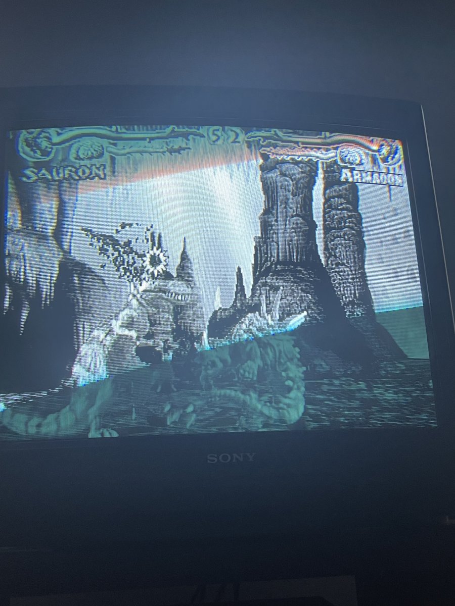

Latest update. just bought this SCART to SNES SVideo/composite converter for my super gun 9 pin mini gun, and it still doesn’t work with color. Everything is in black and white. At least I can finally play the game, but I’ve given up on this CRT idea, and I’m just waiting for the latest retro tink release date, so I can buy that to play it on a modern display.
