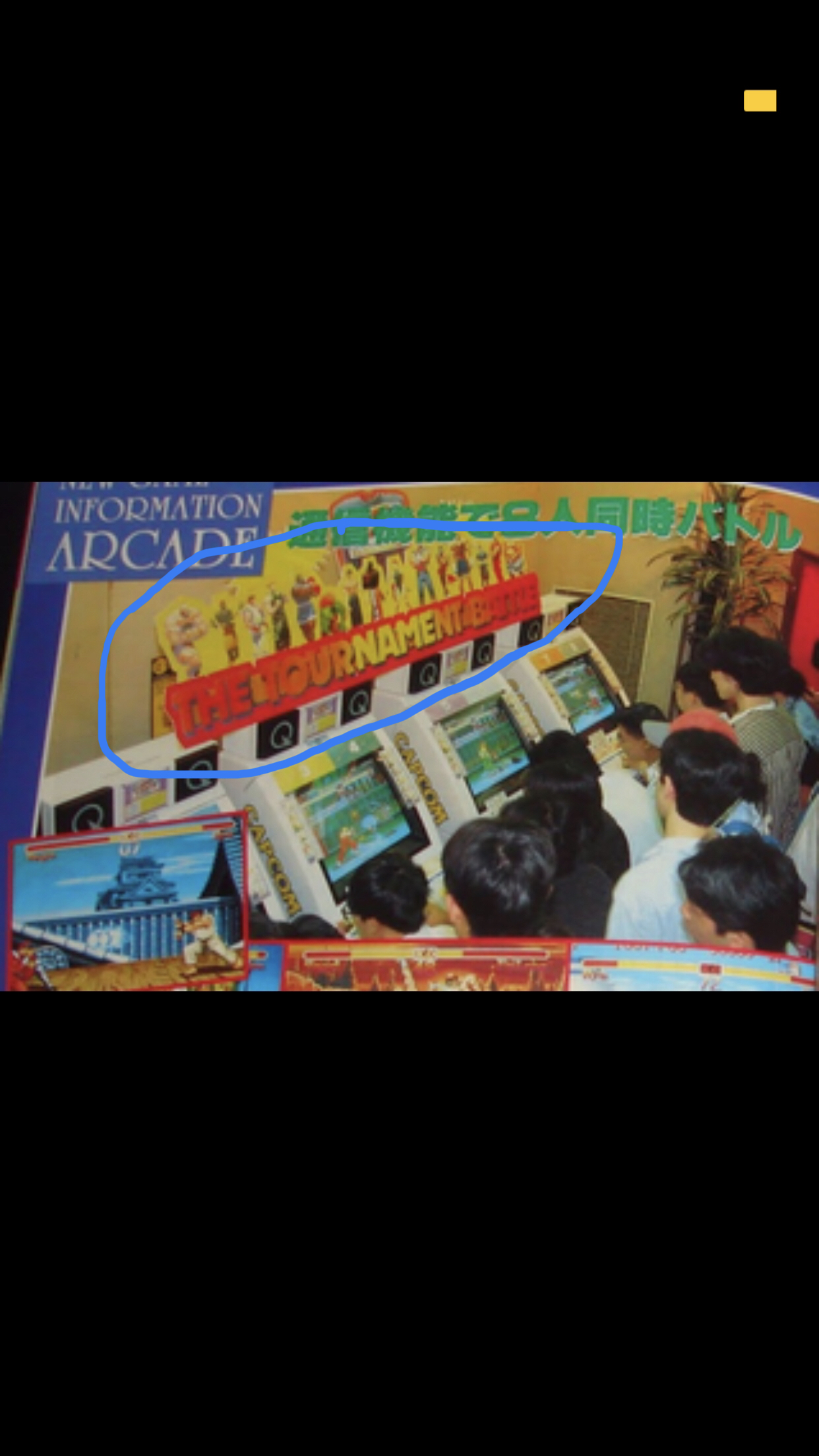

You have a full setup for Tournament Battle in Q25s?Considering this is about a capcom Q 25
Has anybody seen this top marquee of
super street fighter 2 tournament battle edition ?
that is the only piece missing for that same set up as pic,i could be wrong but i might be the only person out japan with this type of set up including all4 capcom Q25 cabs and game
Yes,just like picture avobeYou have a full setup for Tournament Battle in Q25s?Considering this is about a capcom Q 25
Are you using my reproduction overlay or do you have a SSFII one? I ask as many are looking for SSFII replacements.I’m in Los ángeles ca
i’m working on them at the moment by putting back 2player panels and new control panel overlays new sticks and buttons and put back a monitor that I pulled out to recapped
