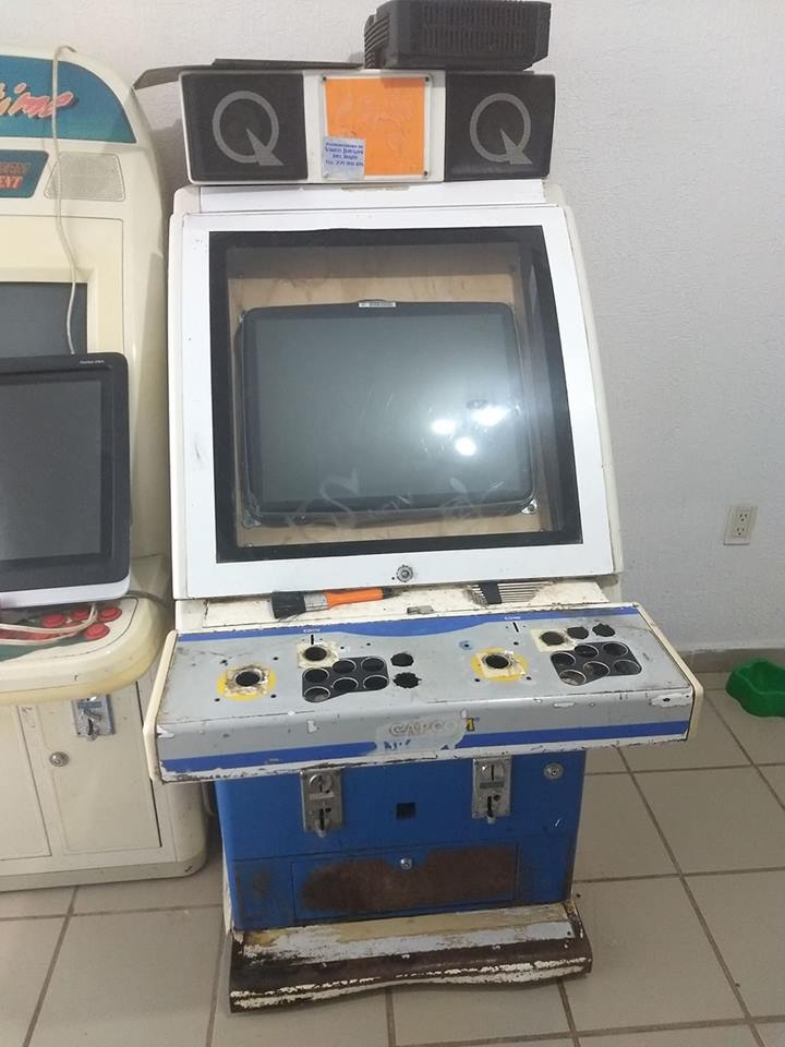

Hello Guys,im Christian from Mexico, recently i was lucky and got one Q25 for just 50 USD, i always wanted a japanese arcade cab, now that i have it i want to give it all the love posible, unfortunately it was modified to work with an xbox and they almost destroy it in the process, i wll use some automotive paint and fiberglass, so, i would like to ask, if its possible to share the 2P12B layout and the Reproduction of Capcom Side Logos??

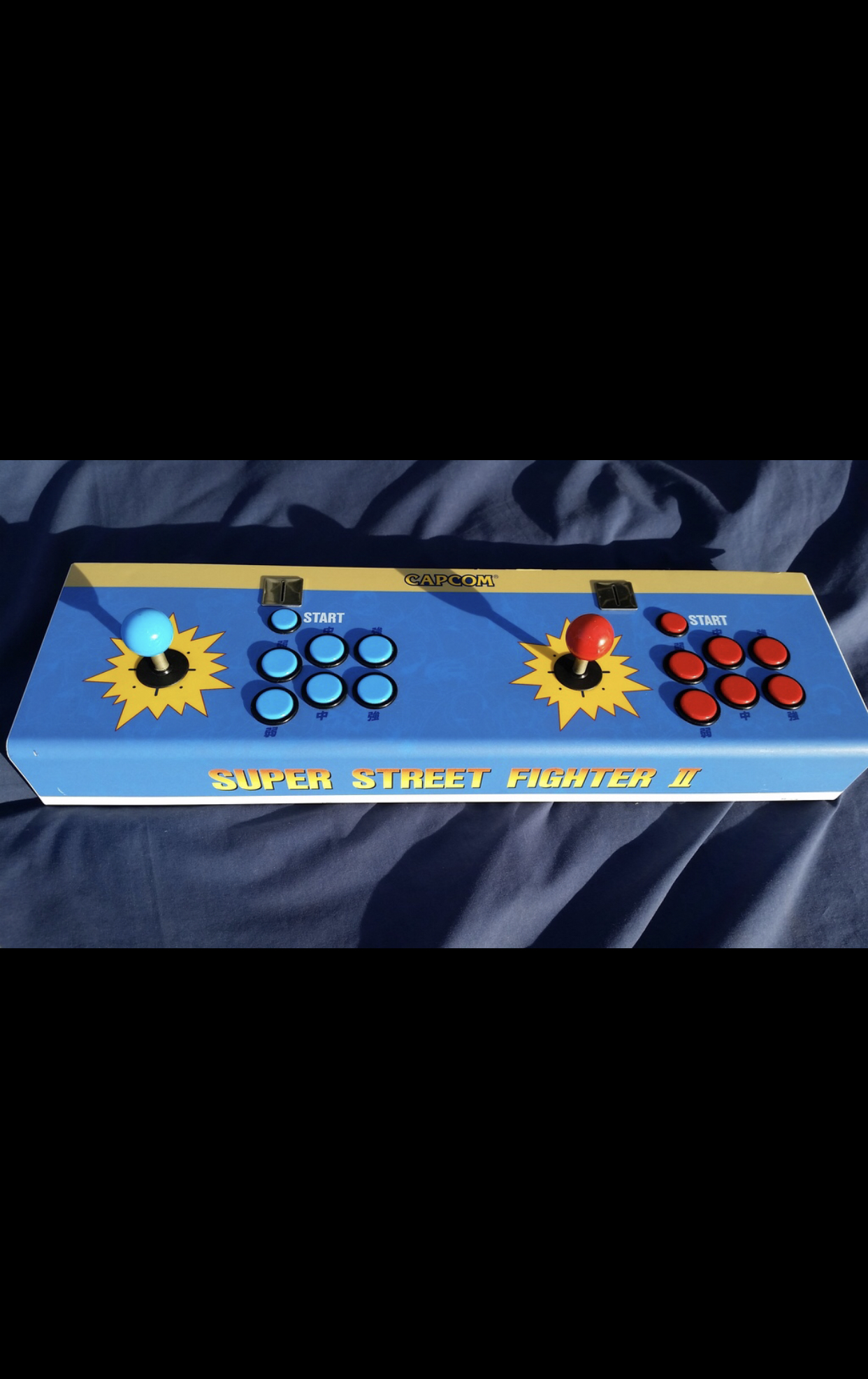

Did anyone go about doing a repro SSF2 overlay yet or do I need to do anything with my control panel before repopulating it? It's the final part of my restore. Everything else is done and looks great. ;)

Well it's currently a 2 player ssf2 panel. And if I were to replace it I would want a SSF2 overlay again. So is it already scanned and available somewhere?
@ReplicaX and myself have offered assistance in reproing this panel. I know that @Arcade game has nos overlays, but he doesn't seem ready to share a scan of them. If you have some high res pictures and can get me dimensions, I can make you something, but it won't be right away because I'll do it when it's slow for me work wise.
Honestly that'd be the best option. Just scanning the NOS ones.
If that can't happen, and Mitsu can't, then somewhere down the line, I'm sure I can get around to figuring out how to scan the one I've got. It's certainly not NOS, but may be worth the trouble if nothing else can be done.
I can also get dimensions for the 1P variation of the standard overlay if you think it's worth it.
It'd be nice to have matching panels between the cabs.
