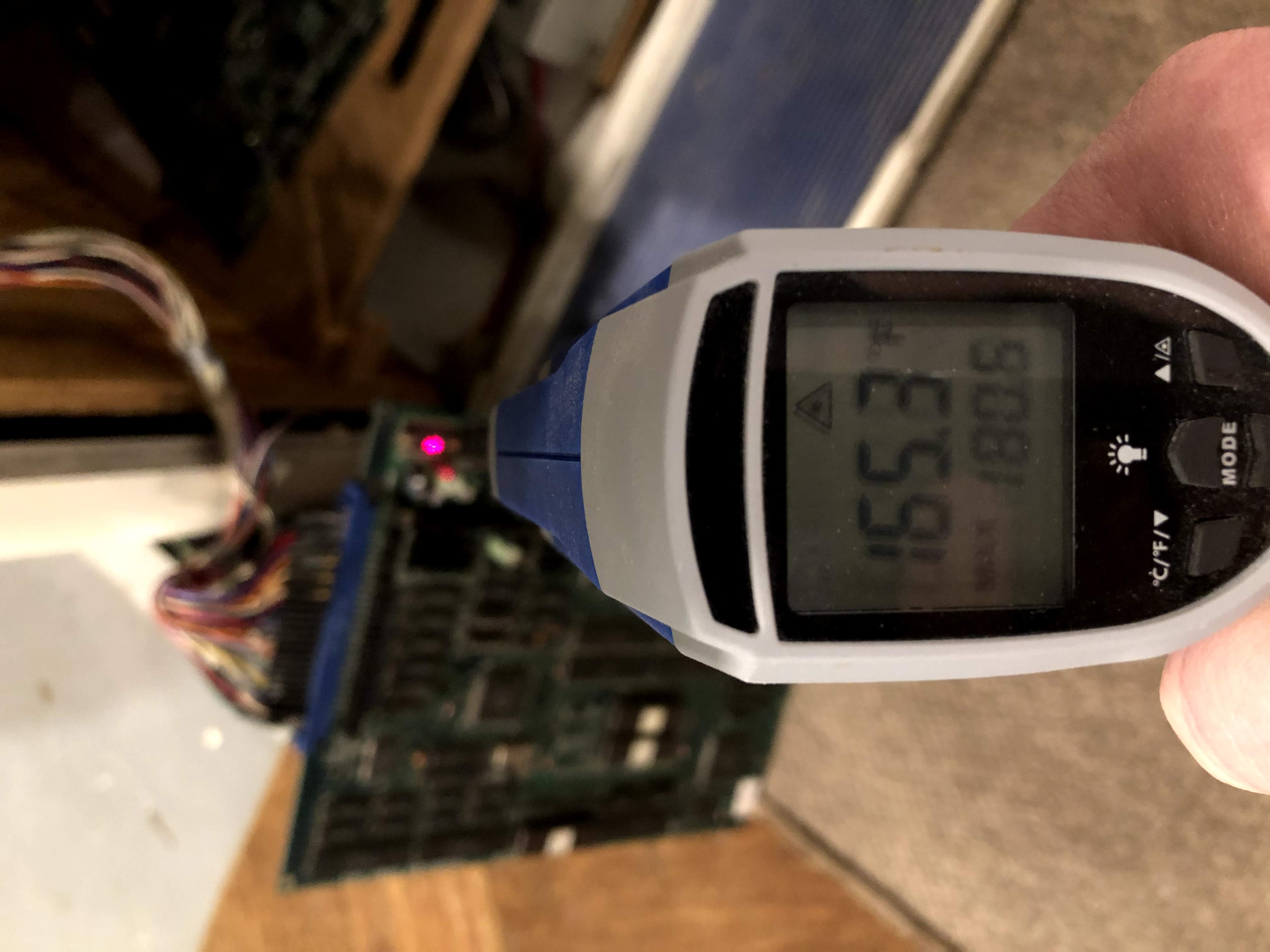

Recently picked up a Raiden II PCB for cheap due to some issues with sound. When I received it, I could see that the volume pot had been replaced in the past. On boot, it would play loud static/garbled sound. With enough fiddling of the volume pot, I could get clear sound at a very low volume. When touching or manipulating the pot, I would hear very loud scratching/static/clicks-and-bumps, even at low values on the pot. I also noticed the audio amp was EXTREMELY hot to the touch. Highest I measured was 182F/83C. This was during gameplay, so it would have been actively amplifying sound. During idle, it would sit around 165F/73C. I have a hard time believing this is normal, but it certainly wouldn't be the first time I was wrong.
