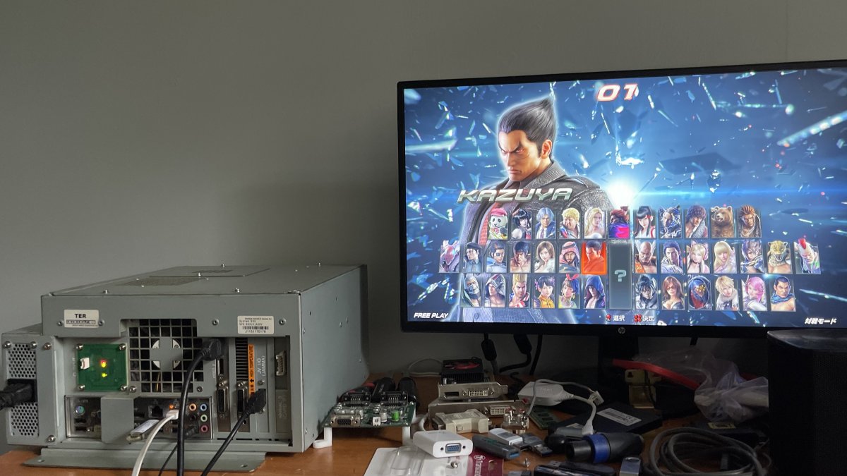

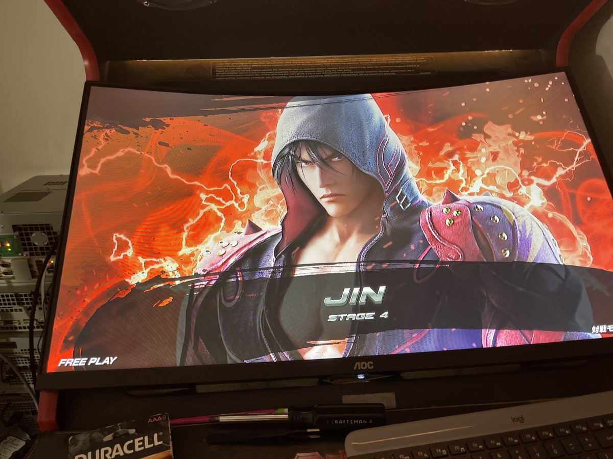

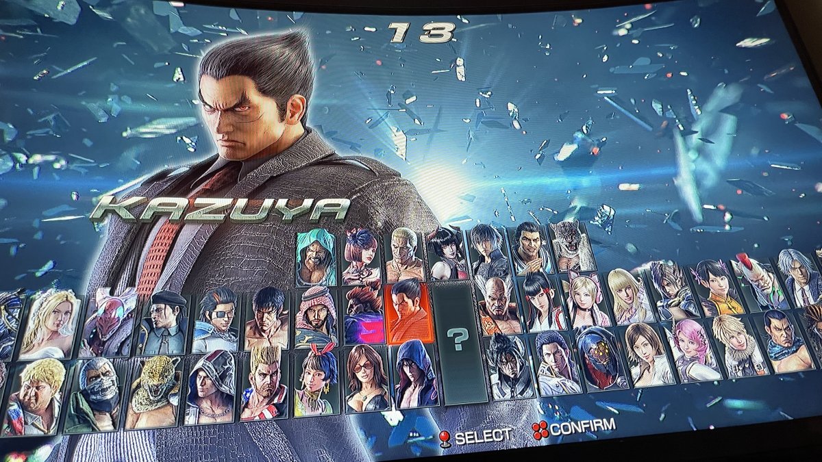

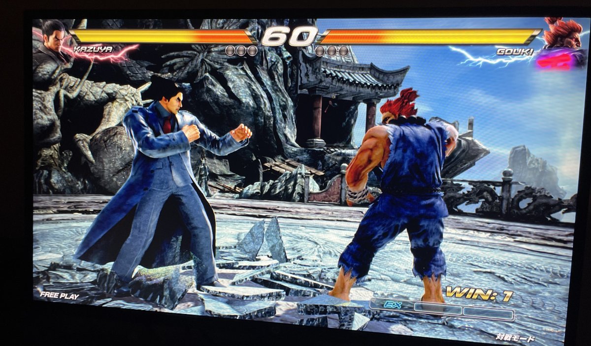

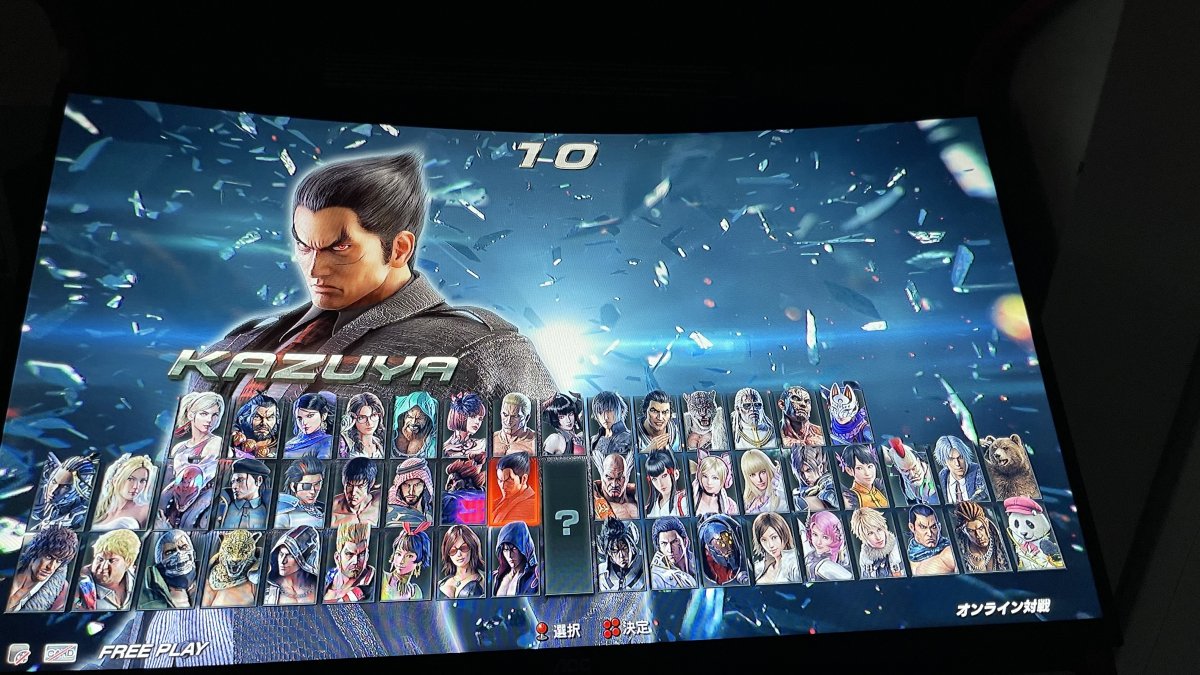

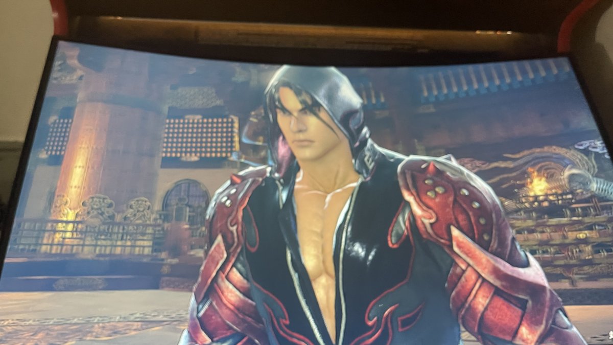

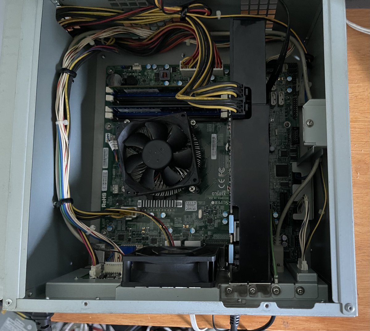

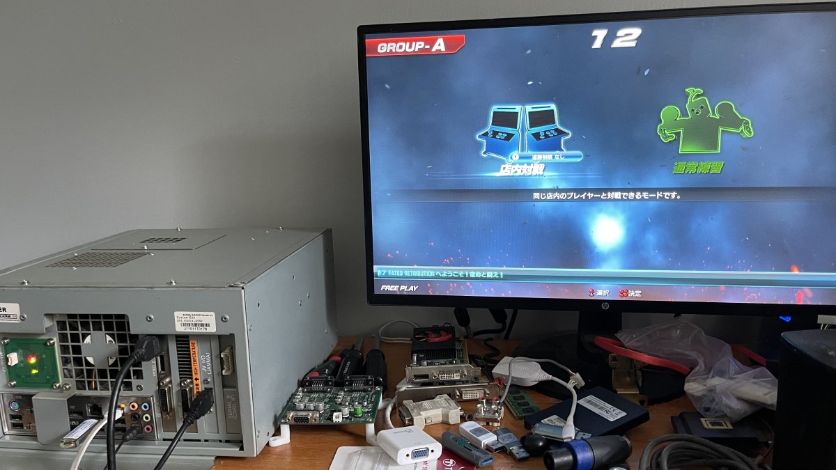

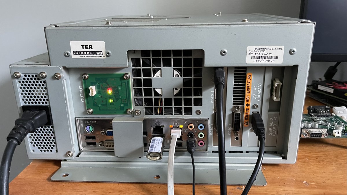

Alright, we’ll I'm back over here lol, unfortunately the TER ES3 unit has a bad motherboard so I put the X10SLQ motherboard in here for now and as a bit of a challenge, I wanted to use the original ES3 software. Installing drivers for this specific motherboard was a bit of a pain but in the end, I got it all up and running.

Hello Franco please could you help me solve this? I have a bad motherboard in a Mario Kart ES3, if I find a good Supermicro C7B75 and swap the bios chip would work?
Thank you!
