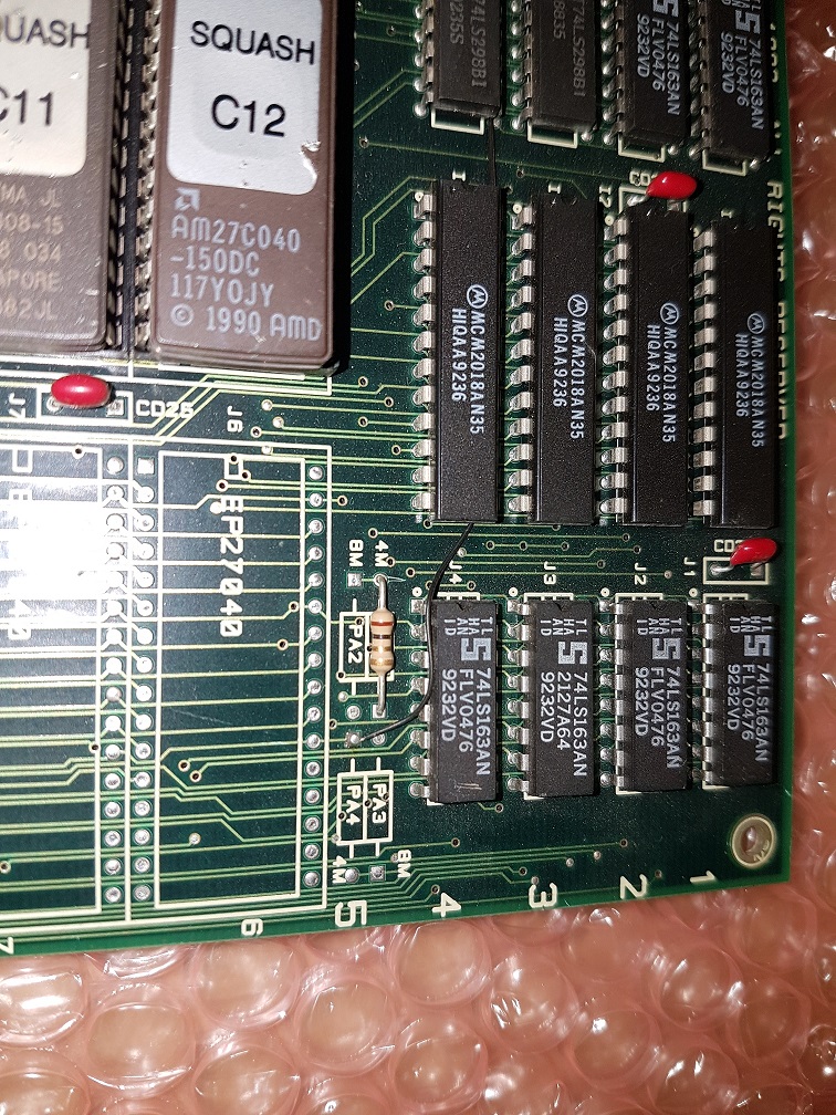

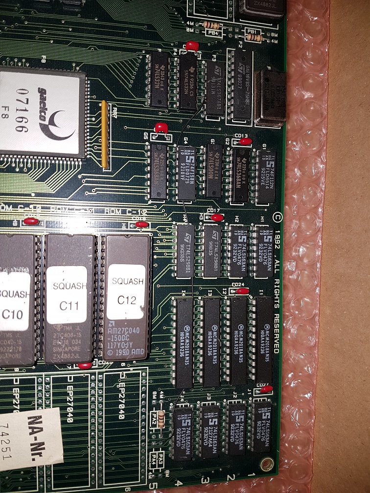

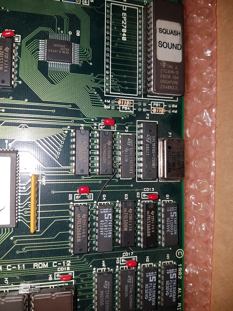

I have seen myself that wire patch on Squash /1 pcb.I have tried to install the wire patch on my biomechanical toy conversion /1 pcb. I havent suceeded to fix the graphic corruption.It seems that the wire connects the second(lower) rom bank /CS signal, and one of the 74' TTL IC near the PAL and the CXO , near the sound ROMs, the pictures are unclear unfortunately.
Plz someone confirm the two locations/ends where must be installed the wire patch.If so, i will give another try on my pcb.

The attached pics should be clear.

Thanks for the HQ pics Sp33dFr34k.I have tried again that wire patch , but it didnt work.When i install the wire patch, the sprites gets corrupted, without it, only the tilemaps are corrupted.
Looking again at the Squash /1 PCB and scratching my head, that wire patch doesnt make sense to me at all, let me explain: the lower ROM bank is not populated, the jumper that selects /CS signal to said ROMS is missing, WHY /CS A ROM THAT ISNT THERE ??? :thumbdown: I guess the wire patch is a NO-GO, someone plz verify that.

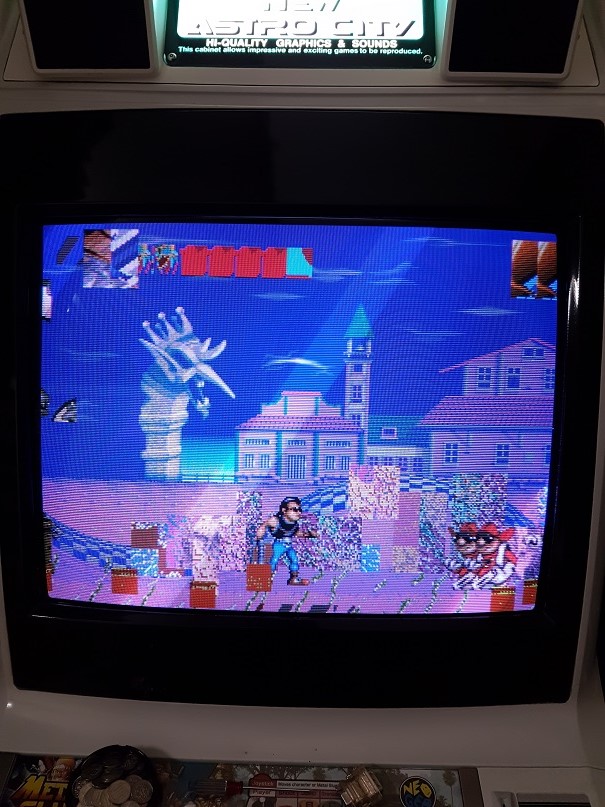

Burnt the 12 ROM's, put a piece of wire on PA4, switched the resistor from PB3 to PB4 (4 to 8MB), but getting garbled graphics. I have the /1 squash PCB, any ideas?
You've got the same problem as mr3xtraball and anyone else with the /1 PCB - it seems the conversion at this stage at least will only work on the /2 PCB, presumably because both BMT and Squash were released on the /2 PCB.
Hopefully @Apocalypse or someone with the knowledge can make the /1 PCBs work, but other than that we're kinda stuck :(

Here's an example of what I get.
