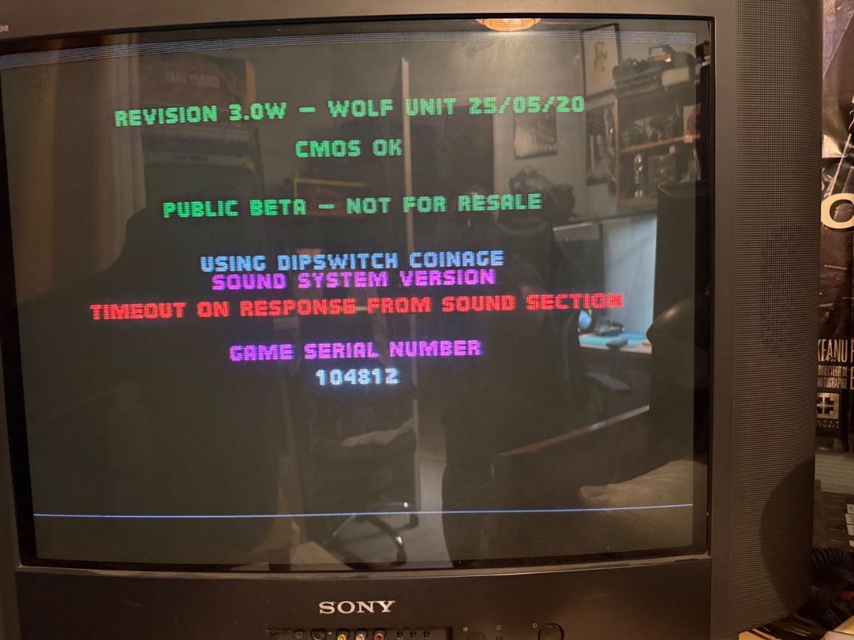

- Someone please test this on real hardware!!
Notes
If anything is upgraded from the todo list, this will just be a 2-rom reburn, gfx and sound remains the same between all MK2 revisions.
I have had zero reports of anyone trying to run this on real hardware, if you have a MK2 single 8MB rom board, you can simply drop in the GFX roms on a Wolf unit and save a lot of time. I don't have one though :(
I have a Hangtime board…
May I purchase ROMs from someone? I understand the risk of it being a test release
