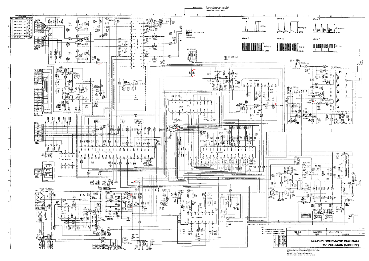

This was an enough time span to measure alla secondary voltages. They were all present. (I did some work on the somewhat blurry schematic and placed out measuring points, marked in red. Attached it here in this post. Please be warned: following this schematic will get you killed and your home will burn down)

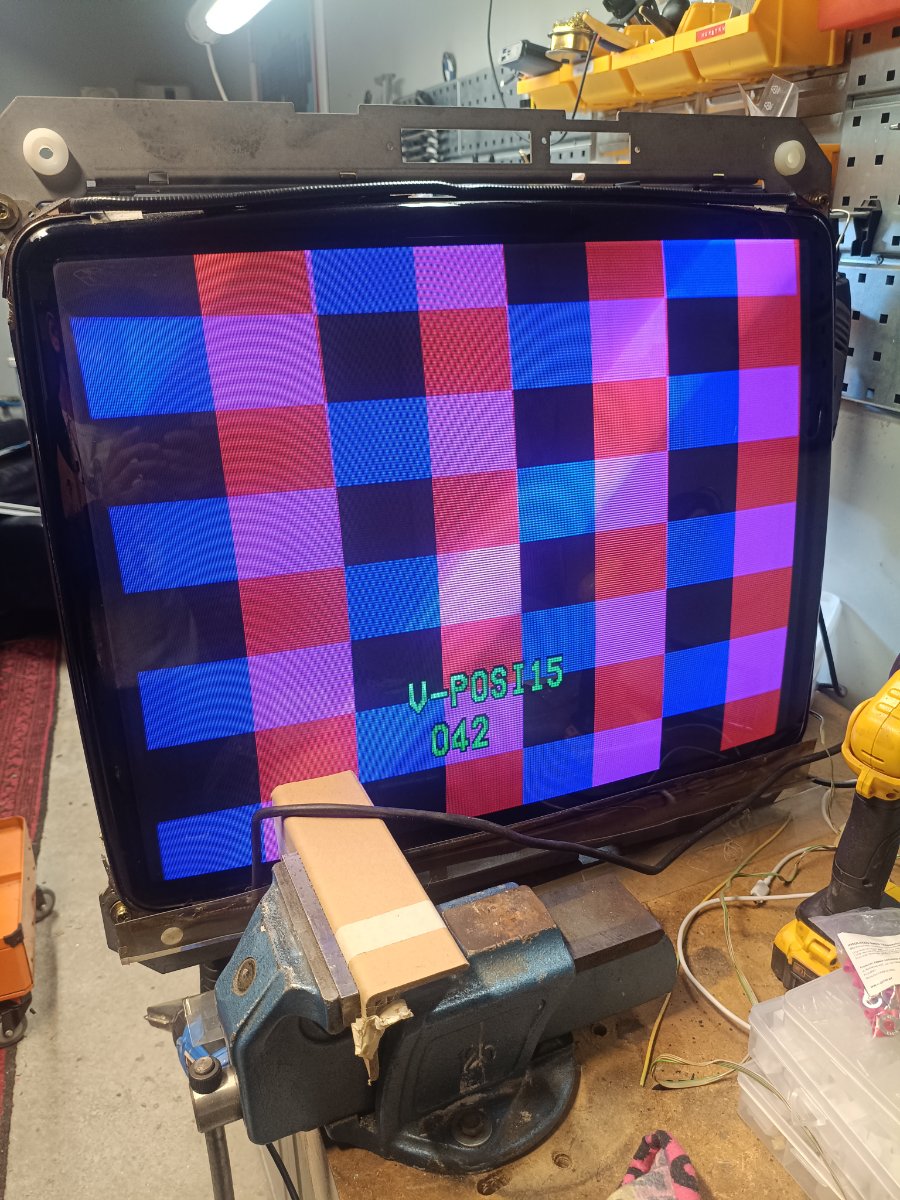

Turned on the power and no tripping. Put in the hv-fuse and the screen fired up. Green was missing except in the OSD.

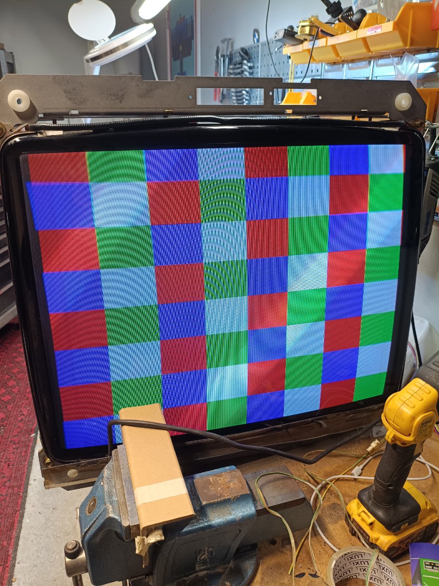

Took a look around the video input circuitry and found a hairline piece of solder shorting one of the SMD capacitors. Removing this got the green fully working.

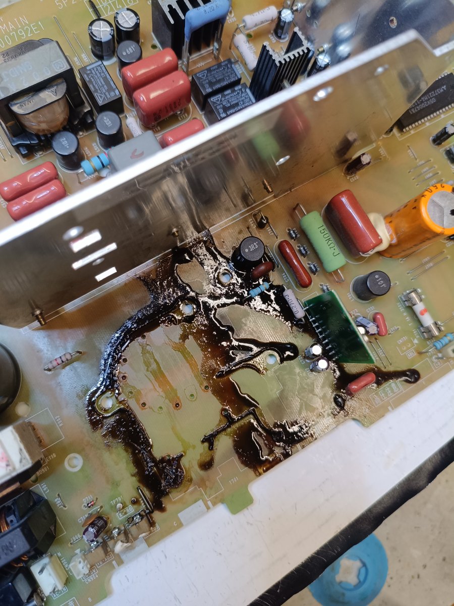

Cleaned up leaked black compound from L512.
