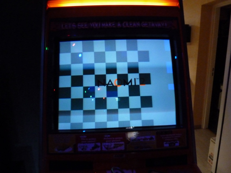

-This kind of graphical glitche
and when doing RAM Test,except somes others glitches you got all rams GOOD
Try Changing IC16 (Graphical RAM)

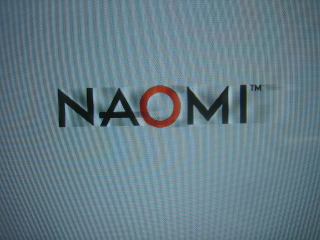

- this glitch
Just investigate the filter board,specialy the vga connector.
