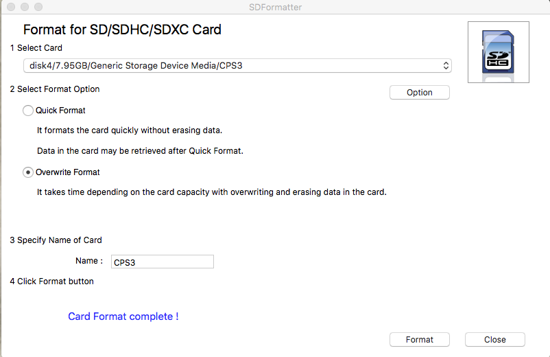

Using the SDFormatter it's in Master Boot Record so the card should be good (hopefully). It's writing to the card right now. Here's some shots of my latest attempt. I removed those two optional commands as I thought maybe it writing faster was messing it up somehow. It's taking a while this time, so fingers crossed. We shall see...
Result: same crap, different attempt. Trying with the other SD card just in case, but pretty much expecting the same result.

Command looks good to me. Are you using an old (5+) year old Sandisk adapter? I had similar issues with one, when it would behave odd, it was hot to the touch.
Going by your screen shots, the input file for dd should be the ISO image you created, "UniCD-CPS3_for_custom_SH2_V5.iso" so this gives us: sudo dd if=UniCD-CPS3_for_custom_SH2_V5.iso (update the path to this file)
Next you need to write to the sdcard. I think that's the disk1 that's 8GB. You want to target the partition and not the entire disk. So the output target for dd should be: of=/dev/rdisk1s1 bs=1m
And we put it all together:
sudo dd if=UniCD-CPS3_for_custom_SH2_V5.iso of=/dev/rdisk1s1 bs=1m
Hope this helps.
This is really it. Formatting the SD card doesn't matter, you're overwriting the whole file system on it with dd. Worst case just have someone image the card for you. Also you actually do want the whole card not a partition. Imaging the whole card makes it an ISO device. I'm fairly certain I imaged mine with dd if=disk.iso of=/dev/sdcard (the main one not like sdcard1 for the first partiton on it)
In other words once you write it with dd like that it'll basically have the correct file system/partition table etc in place for you. If you run " ls /dev/disk* " (no quotes obviously) and disk4 exists in addition to disk4s1, dd with of=/dev/disk4 and it should be fine. By creating your own partition table and writing data to one partition you're dumping ISO data into a partition marked as FAT... not really going to work I'd think.

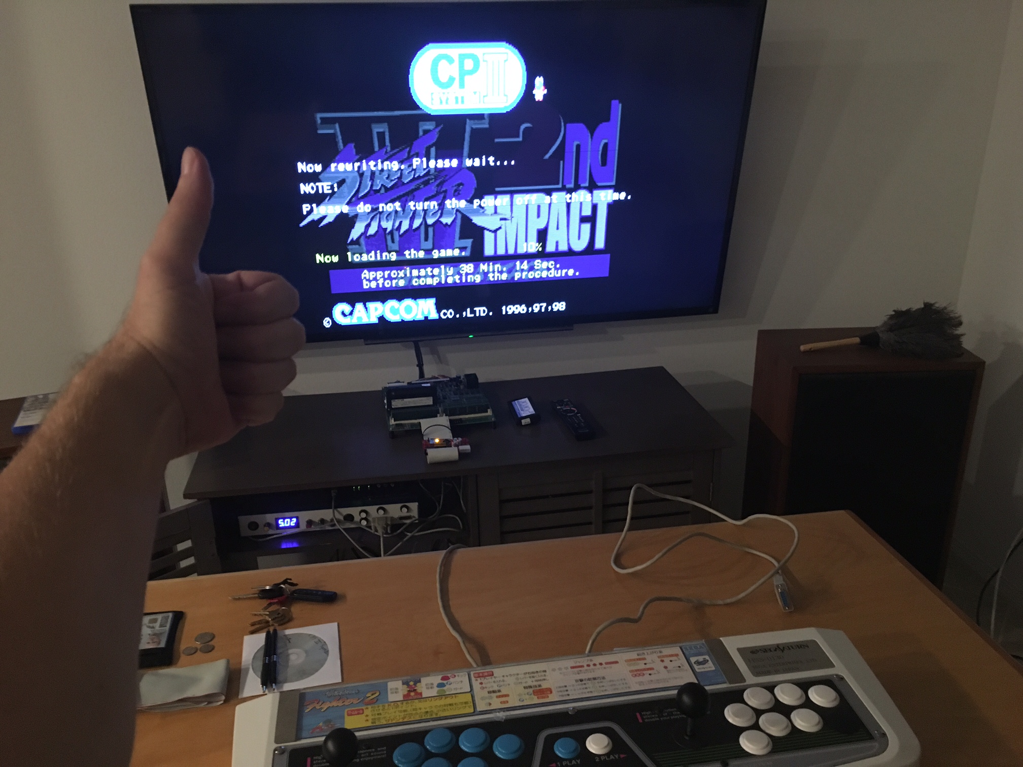

So I tried DD one more time for shits and giggles and it worked! Although when it finally recognized the "CD" I hit rewrite game and it started writing 2nd Impact (didn't see any kind of game selection). It said "do not power off" and I really didn't want to possibly screw anything up so I'm just going to let it do it's thing now. In any case, how would I normally get to the game selection screen?

Just hold 1p start while booting up to get to the darksoft menu. Have fun!

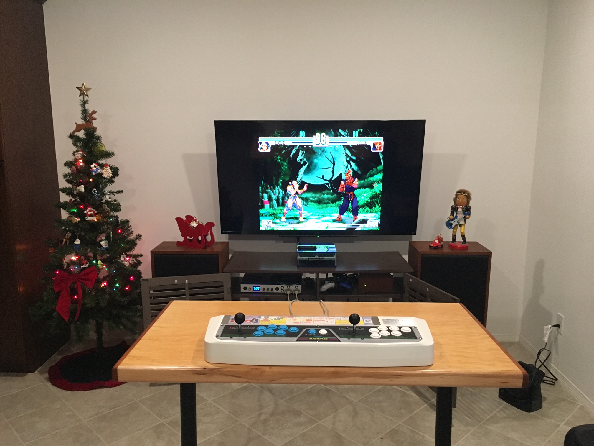

Pics of finished setup. Thank you so much everybody for all of your help. Huge shout outs to Mitsu, Jassin, Jugu, and ACBlunden, and of course Darksoft. Could not have done it without you guys!
Awesome setup dude! Love the cover you have going on it
Got it from Jasenscustoms; my Supergun was built by him as well. Crazy smart and awesome guy.
