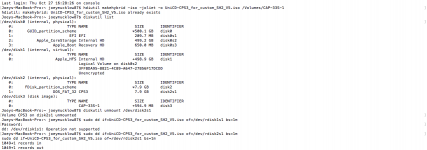

This is what I've done so far:
mounted the disk image called UniCD-CPS3_for_custom_SH2_V5.iso
then typed into terminal hdiutil makehybrid -iso -joliet -o UniCD-CPS3_for_custom_SH2_V5.iso /Volumes/CAP-33S-1
then diskutil unmount /dev/disk1 (because my sd card is under disk 1 after doing the list)
now heres where I'm confused, as per the instructions on page 8 of the forum it should be something like this
sudo dd if=/Volumes/CAP-33S-1.iso of=/dev/rdisk1 bs=1m
or maybe
sudo dd if=/Volumes/CAP-33S-1/UniCD-CPS3_for_custom_SH2_V5.iso of=/dev/rdisk1 bs=1m
or maybe
sudo dd if=/Volumes/CAP-33S-1 of=/dev/rdisk1 bs=1m
In any case, I can't get anything to work. For some reason when I tried earlier I was able to put in my password before it didn't want to do anything, but now it won't ask. In any case, I attached some screen shots. What am I doing wrong?

Going by your screen shots, the input file for dd should be the ISO image you created, "UniCD-CPS3_for_custom_SH2_V5.iso" so this gives us: sudo dd if=UniCD-CPS3_for_custom_SH2_V5.iso (update the path to this file)
Next you need to write to the sdcard. I think that's the disk1 that's 8GB. You want to target the partition and not the entire disk. So the output target for dd should be: of=/dev/rdisk1s1 bs=1m
And we put it all together:
sudo dd if=UniCD-CPS3_for_custom_SH2_V5.iso of=/dev/rdisk1s1 bs=1m
Hope this helps.

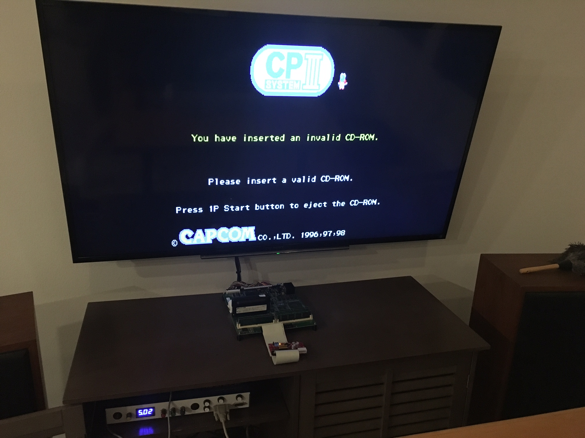

I think I made the SD card right this time as my Mac will no longer recognize it; however, I get the invalid CD message upon powering on the CPS3. Screenshots of the SCSI2SD settings and Terminal attached. I wanted to try and erase the SD card and try all over again, but I can't with disk utility or SDFormatter. Is there a terminal work around?

First unmount the disk:
diskutil unmount /dev/disk2s1
Then erase:
diskutil eraseDisk DOS CPS3 /dev/disk2s1

Tried again, and no dice. Tossing in the towel on this one. My computer just won't do it lol. I will be sending to Mitsu for help.
I thought after it didn't work it was maybe the SCSI2SD itself, so I changed my settings on the SCSI2SD to match the ones you had Jugu (not sure if sector size matters, I had it at 2048 before but changed it to the value you had posted earlier (512). Same result, no dice. Attached the terminal page and my settings. Why it's not working is beyond me. If I continue tonight I'll just get frustrated. Thank you for all your help though, I still feel like this should work lol.

Forgive me if I missed something earlier... But based on the screen shot above you are using the Custom SH2 version of the image.
Do you have a custom SH2 SuperBIOS cart? I think most people just have SuperBIOS carts now (because its easier) right?
Custom SH2 SuperBIOS cart. Sent a 2nd Impact cart to Mitsu and had the $55 mod (custom SH2) done. He linked me to the ISO I'm trying to use. I think it's got to be something to do with my computer or adapter for the mini SD card or something dumb like that. I'm stumped at this point.
Well judging by the screen shots above the CPS3 is seeing the SD2SCSI device as a valid CD-ROM, it just isn't happy with the disc (aka image).
No Windows PC (sorry I had to ask I'm sure someone has already suggested it)?
Trying again with a different SD card adapter (got to rule out dumb possibilities lol)
UPDATE: No dice! Changed the SCSI2SD back to the previous settings too. I wonder if it could just be the SD card itself, but I don't have another one lying around. In any case, that's all for tonight...still in a good mood overall and not looking to change that : D
