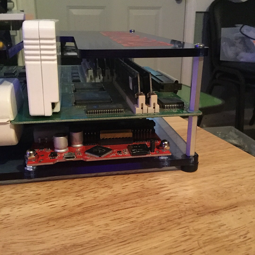

Look at Jasens instructions closely. For the 2 screws that hold the scsi2sd board it says 1”. Maybe they should be 1/2”? Anyway he includes 2 1” in the kit and I didn’t see another use for them.

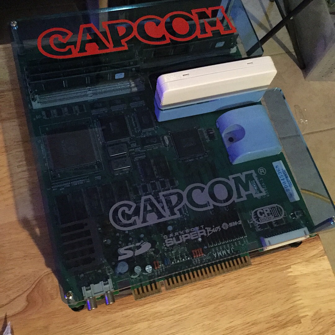

I picked up some 1/2” screws at Home Depot. Gonna give that a shot. Really what I have is fine, nothing touches. I also bought some pretty sweet capcom stickers and wanted to slap one on this thing but I can’t seem to find them.

Follow up on the case. I got some 1/2” screws and that works. 5/8” would prob be best because with 1/2” I could only thread the nuts a bit, but it seems fine. I also found my sticker which is a good fit for this case, I got blue and red, went with the red
