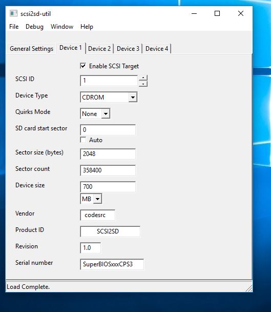

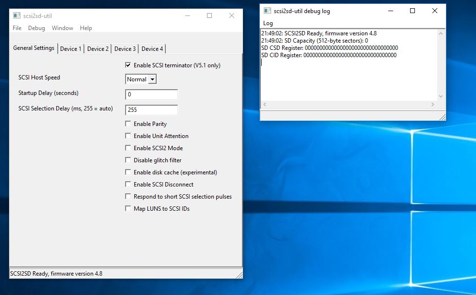

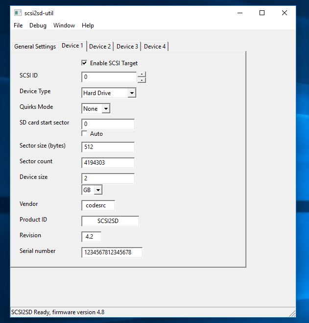

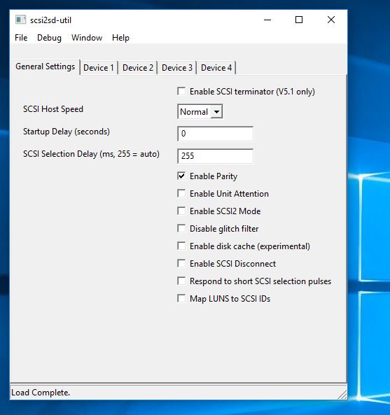

ok, the scsi2sd has more settings now with the latest firmware. these are not my settings, I have a 5.0b and that "enable scsi terminator (V 5.1 only) comes up as checked" so I unchecked that and tried to match what you guys had the best I could. Anyone else using the latest firmware and can share their working settings? what the hell is "quirks mode" and maybe I should set scsi host to "slow" ?
Device type has to be cd rom, not hard drive.
I know, i was just showing the new options. I have that set. here are my settings

ah ha! in winhex when you select the write destination select the "physical storage device" not the logical. not sure if anyone said that, if so I missed that detail. I took tons of notes reading this whole thread. anyway maybe that helps someone. So my settings for 4.8 are good. game on. writing 3rd strike, now I have to wait 40 minutes.

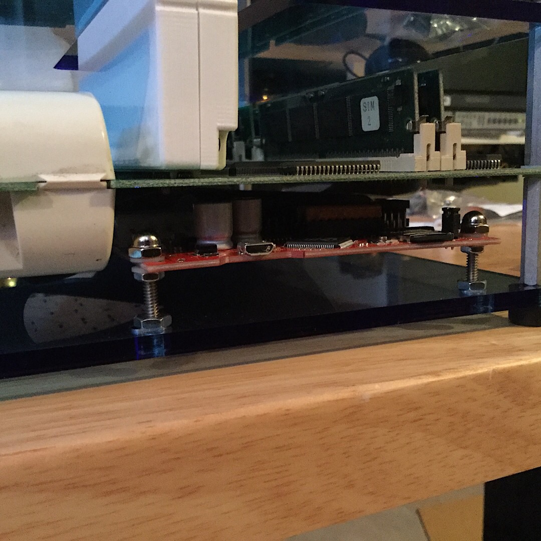

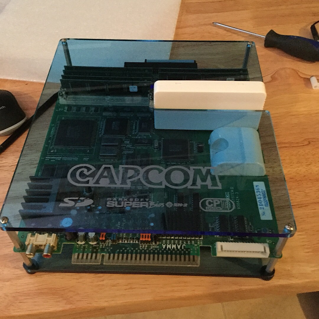

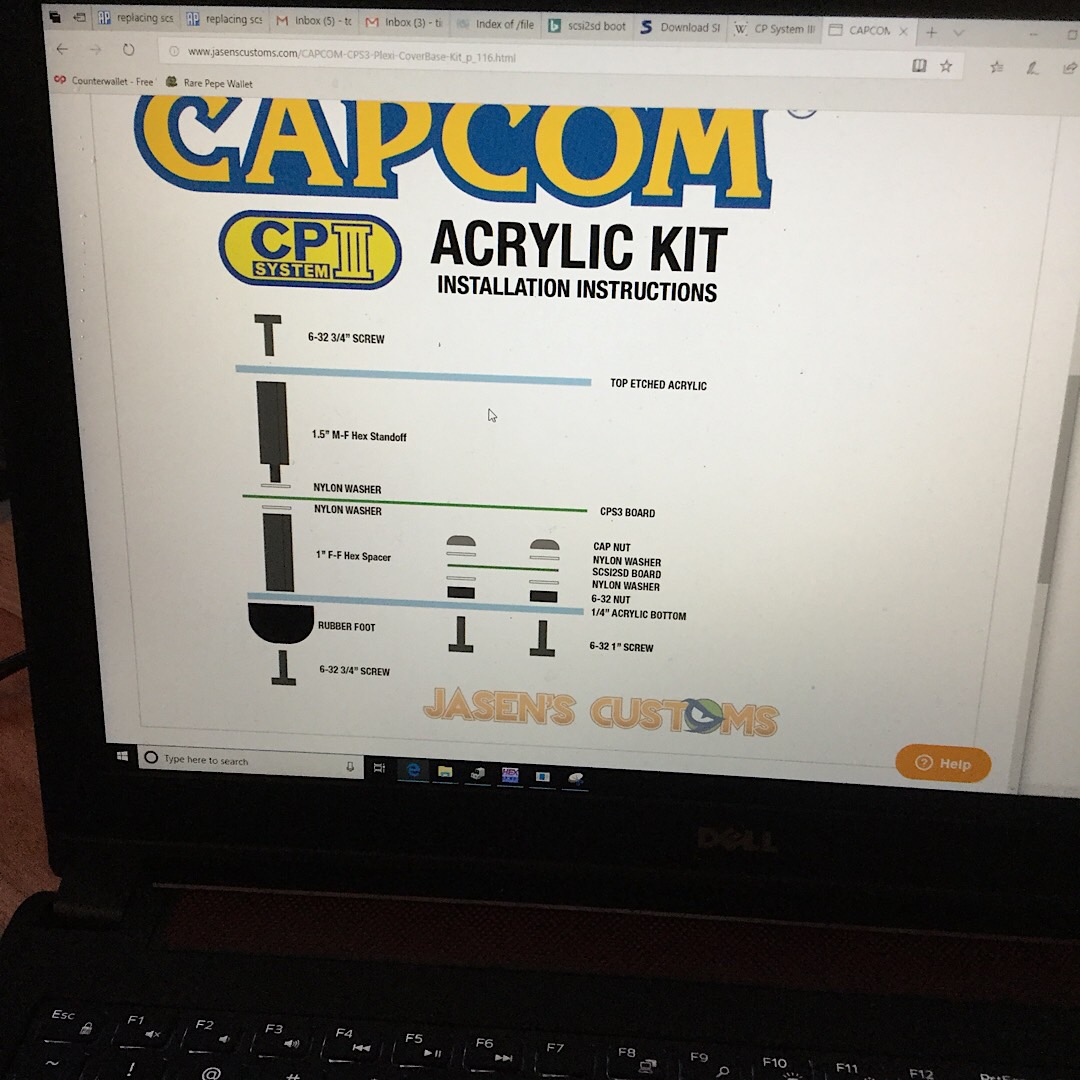

Either I am missing something or I think our buddy jansen is not including enough nuts in his kit for the scsi2sd board. I had 2 extra nuts that fit so I made it work, I just don’t understand what he expects people to do with just 2.

That's because only 2 are needed.
If you look at the assembly picture, it's only showing 2 nuts and 2 cap nuts. Also, your scsi board is mounted fairly high. I do not recall mine being that high.
@Geddon you didn't mount it correctly, take another look (it should sit almost flush with the plexi).
