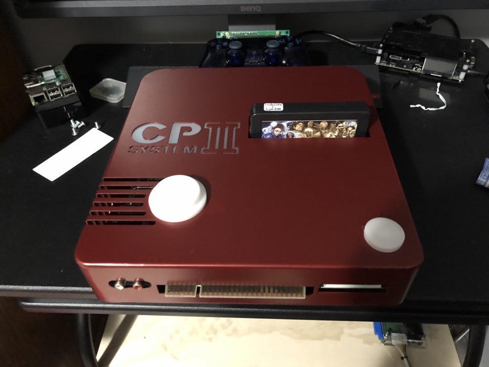

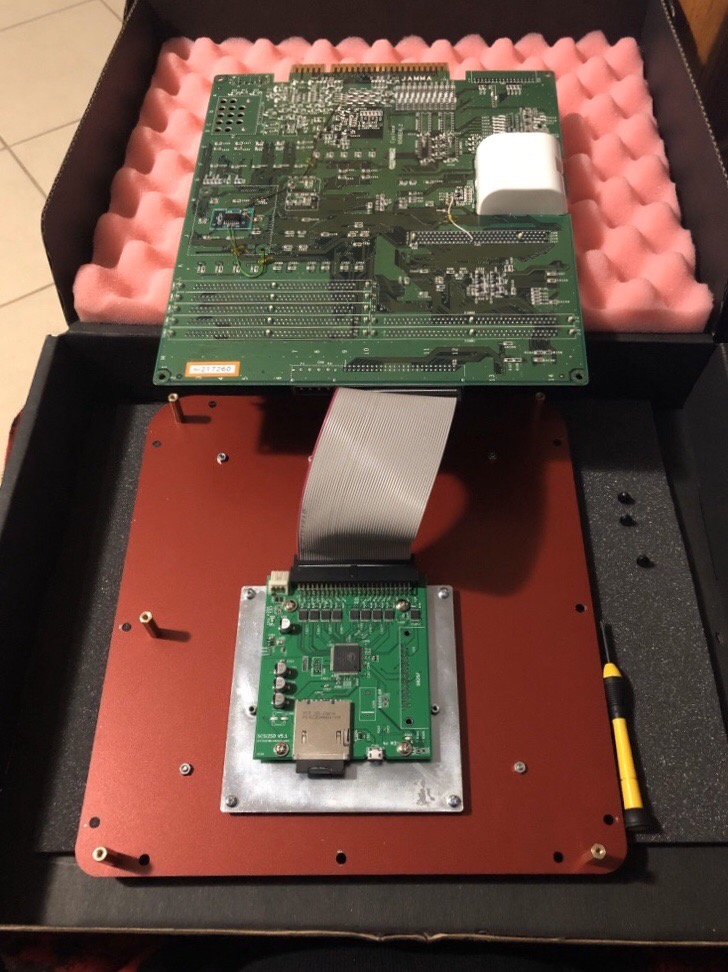

Looking to replace my CD-drive for the SCSI2SD.
But which of the two versions should I buy? The v5.1 or the v6? They seem to have slightly different features and sizes.
Any help gratefully received.
I use the 5.1 version as well work great with the HAS supergun
