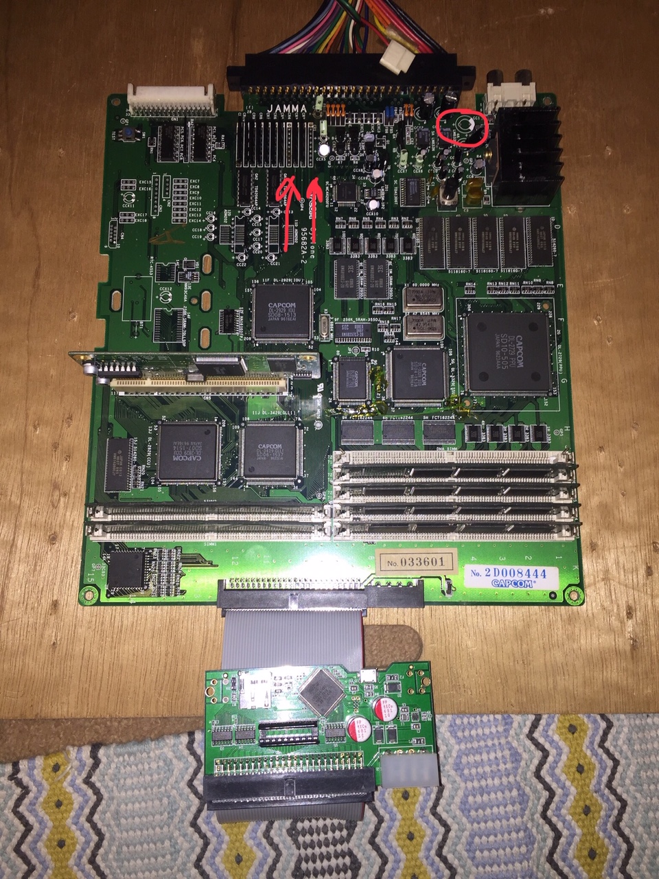

So i'm pretty confident the scsi2sd is setup correctly so its either the board or the scsi cable. I'll see if i can find a different cable to test with.

@geldra Just to verify but are you also providing powering to the scsi2sd adapter. I'm asking because i dont see a power cable going from the scsi2sd adapter to the cps3 mobo in the pic you posted.
I'm not, as I read the adaptor gets power through the ribbon cable. Is that incorrect? Massive face palm if so. :D
The scsi cable is sufficient enough to run power to the board without a molex connector. What kind of sdcard are you using? Have you updated the firmware on the scsi2sd?
On fw 4.8.4. Honestly I'm just using a microsd that came out of mobile phone somewhere along the line.
If there is no sd card in the scs2sd should the cps3 grumble about no disc though?
edit: the best way to test to see if its my mobo is to test on a friend's setup. I'll see if I can do that over the next week.
I'm borrowing his scsi cable to test on my set up, just to rule that out.
If the card isn't formatted right you'll get errors too, so just to confirm, how did you format it? Also, are you sure you're using the right disc image for custom or standard SH2?
Don't need molex power for SCSI2SD on the CPS3, so that's not the problem. Looks like it's either an incompatible SD card, bad image, or image not written correctly. Try other cards. What software are you using to write the image? Apologies if I missed that.

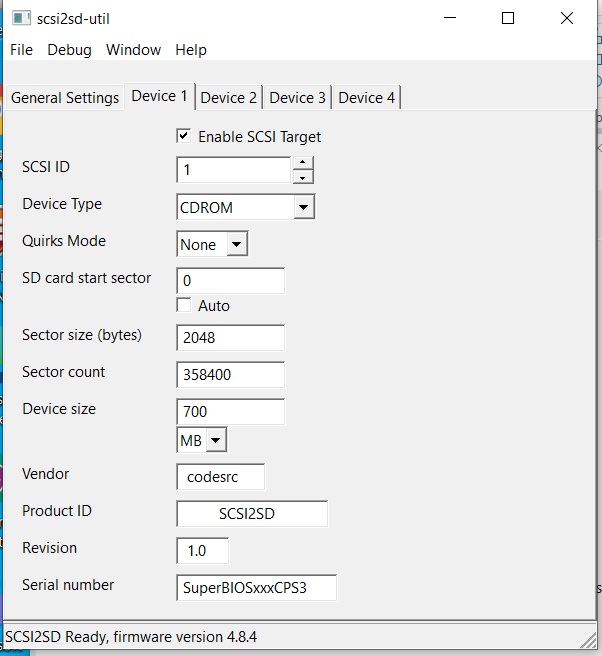

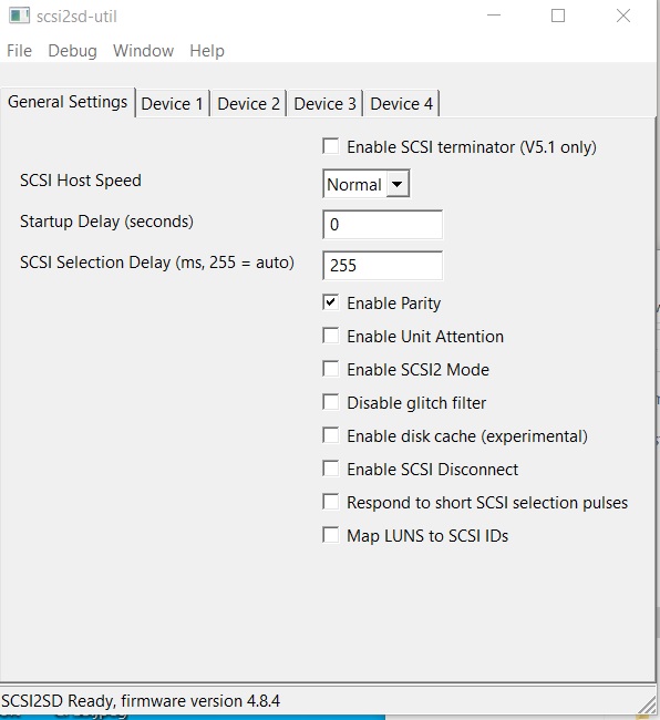

I'm struggling a bit with the directions on getting the SCSI2SD working... I've plugged the SD card directly into my computer, formatted it and loaded the .iso file onto it via the methods described a few pages back, BUT, I'm stuck at the SCSI2SD-UTIL.EXE part as it's not detecting my SCSI2SD device AND when I go to "FILE > Upgrade Firmware" it's asking me to select a file from my computer (which file?).
I'm also not clear if I should be connecting the SCSI2SD device to my computer via a microsd cable, to my CPS3 board via the IDE/SCSI cable, or maybe I both? Also, with or without the SD card in the SCSI2SD device?
Here is an excerpt of the part I'm stuck on from previous posts - thanks!
Do I need to connect the SCSI2SD card to my computer or the CPS3 board to get this working? With or without the SD Card?

You shouldn't need to update your firmware. First try and if it doesnt work, then update. The file should be available at the page of the manufacturer. For example: http://www.codesrc.com/mediawiki/index.php/SCSI2SD
you connect to your computer via the microUSB cable just to adjust the settings. That's all.
The microSD must be written as explained and then you remove the microSD from your PC and insert it in your SCSI2SD device.
Once you have your SCSI2SD device properly configured and with a microSD with the right content, then you can plug it to the CP3. Only the 50 pin SCSI cable is needed, no need to power the SCSI2SD.
