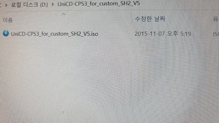

200kb or less in winhex? An error occurs and scsi2sd opens only the xml file, so the iso file is not read ㅠ.ㅠ I will upload the post as an image.
yes, this image file..

Finally, the scsi2sd operation was successful. ㅠ.ㅠ
