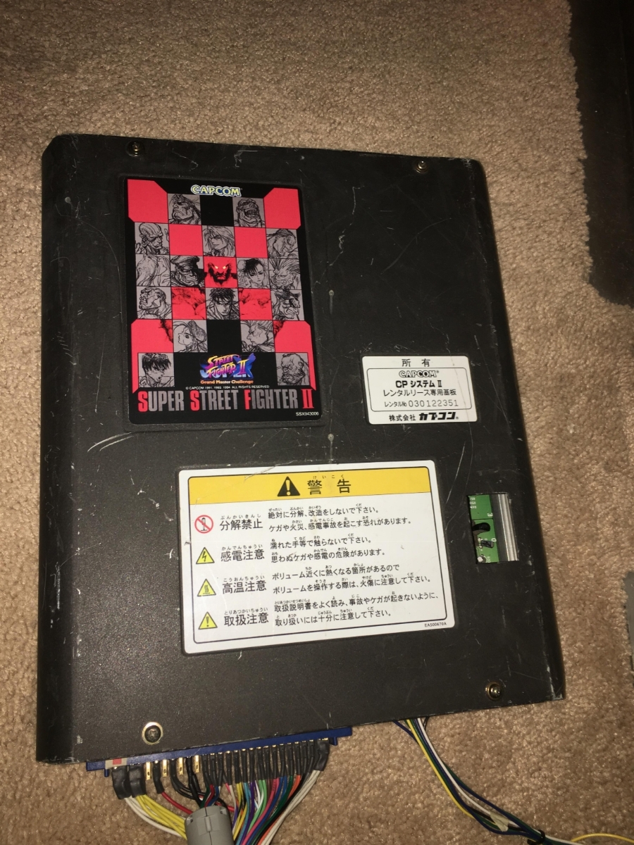

So I've see a people talk about reviving regular B Boards for cps2, but what about those All in one black boards? Below I have created a step by step process to revive or convert your CPS2 black board using a CPS3 Darksoft kit.
I am in no way telling anyone to kill a perfectly working all in one board. I only suggest doing this if the board is already phoenixed or suicide.
Every time you see an all in one board, 90% of the time it's Marvel vs Capcom. While I do enjoy this game, to me there are better games to turn this into. So the first step we're going to take is downloading CPS2Black. This software basically turns your rom files and packages them into a BIN file for your CPS3 to read the files.

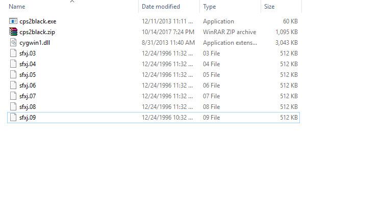

4. Extract CPS2Black and your roms in the same folder. Rename the rom files so that they're identical in the name, then change the file extension to go in the rom number order. In this guide I am using Super Turbo as my selected game.

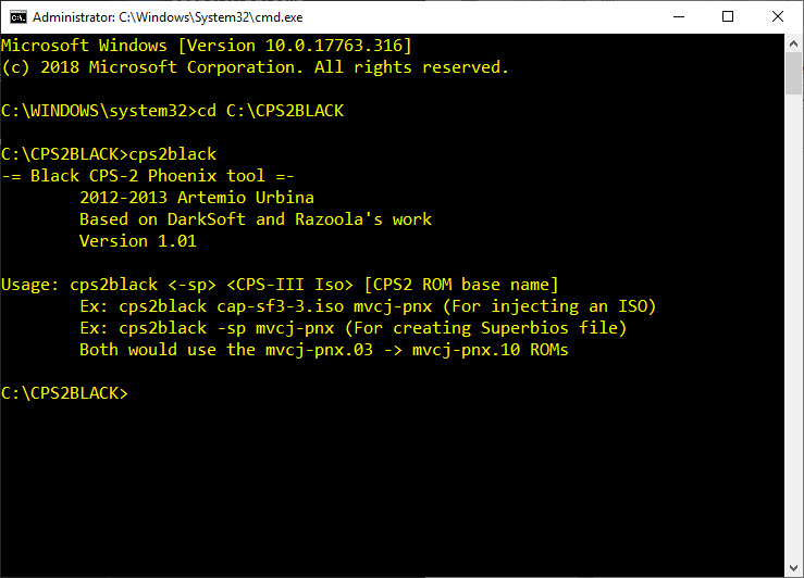

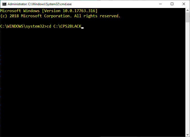

5. Open up CMD.exe and run it as administrator. You will then change to the directory that CPS2Black and your roms files are located. To do this, type "CD c:\your directory goes here". In my example it is located in C:\CPS2BLACK
6. Now type CPS2Black. This will give you all the options available for CPS2black
7. Since we are going to be using a CPS3 and Darksoft cart to write to the SIMM, We will use the -SP option. We are using Super Turbo in this example, so we are going to type "cps2black -sp sfxj". Notice that it states it couldnt read rom 10, this is because Super turbo only uses roms 3-9.

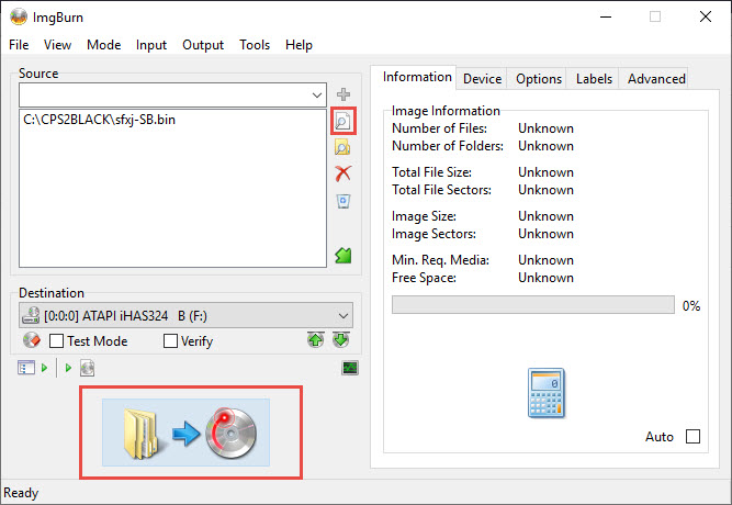

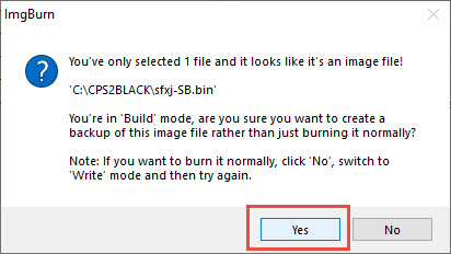

8. It has now created a BIN file for you. We are going to take this bin file and burn it to a CD. I prefer to use IMGBurn because it's free and does everything you need when it comes to burning media. Put a blank CDR in your optical drive and open up imgburn. Then select "Write Files/folders to disc
9. Select the bin file that CPS2black created for you, then click the folder > disc image to proceed.
Side note, you can add more than 1 BIN file created by CPS2black. So if you want to add different versions of your game or just different games, you can do that.
Imgburn is then going to nag you that you're trying to create a data disc using an image file. Ignore this message and click yes to proceed.
Another window will pop up asking you to create a volume name. You can name this to whatever you want. I typically just type the rom name.

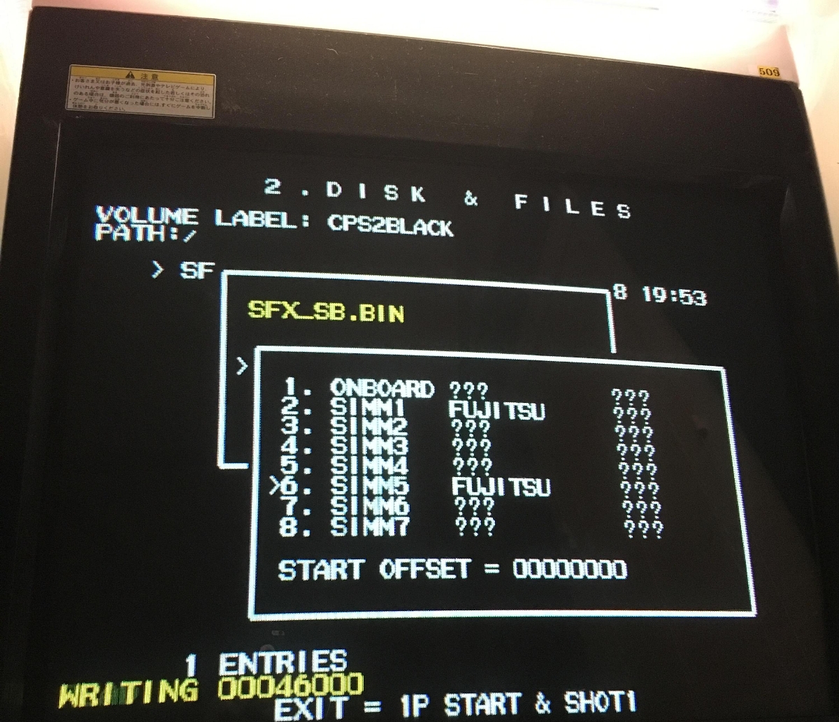

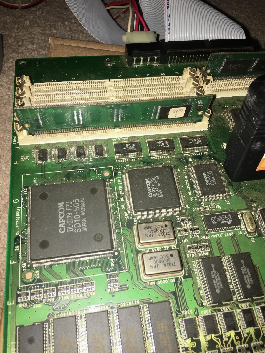

10. Your file(s) are now burned to a disc. Now you're gonna wanna pop out that CPS3 darksoft kit. Remove the 32mb simm from the CPS2 board and place it in slot 7 on the CPS3 board.

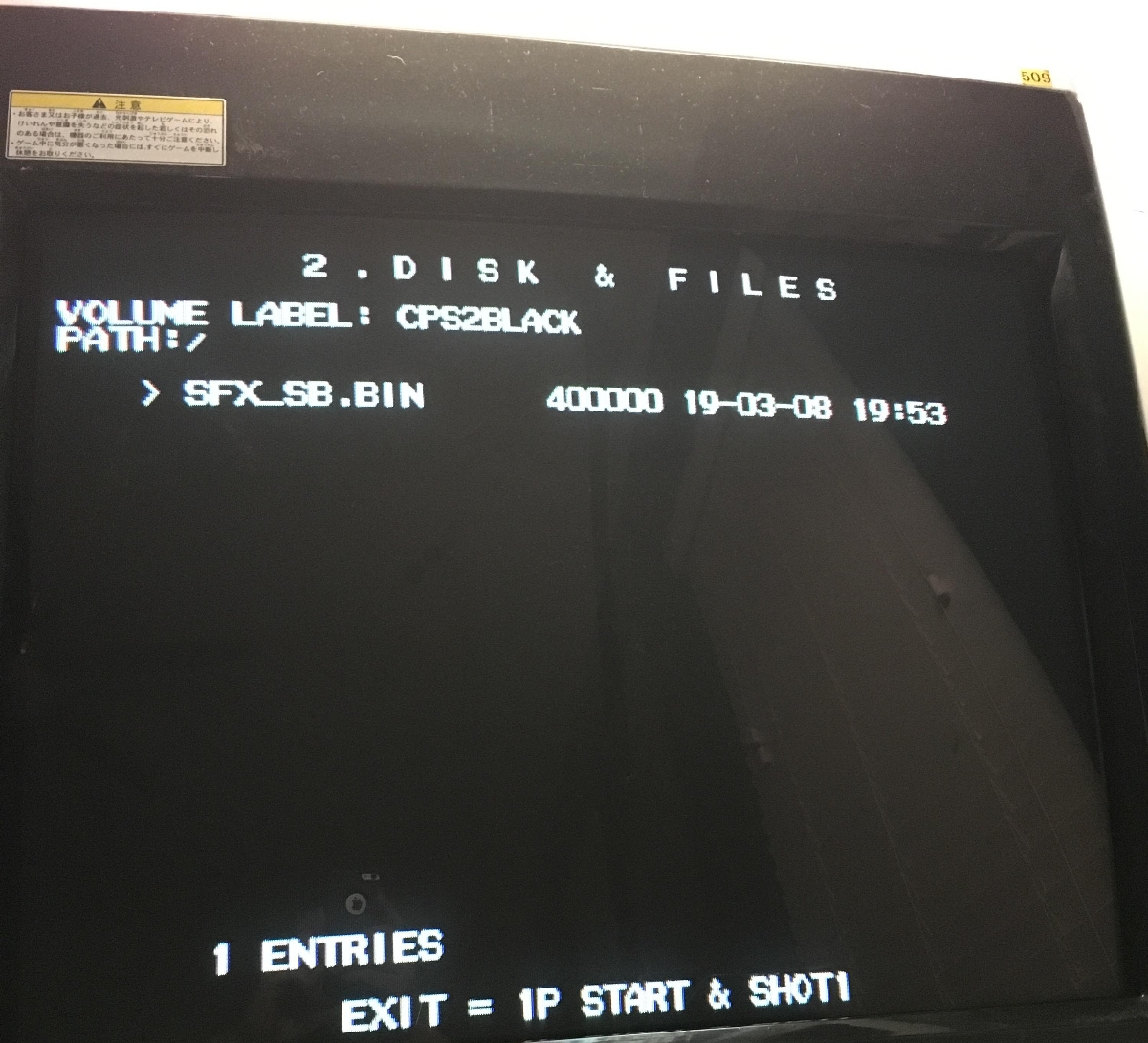

Turn on the the CPS3 board and make sure you hold Player 1 Start button as you turn it on to enter Darksoft menu. Select "Disk and File". Please allow the disc drive at least 30 seconds to read the drive before you do this, otherwise if you try to go to disk and files too fast, it'll freeze and you'll have to reboot the system and start over.
Select your BIN file by hitting SHOT 1
Select option 2 to "Write to Flash Memory"
Then choose the 32mb Simm in Slot7 by pressing SHOT 1 twice. The SIMM will then began the erasing and writing process.
11. Once the SIMM is done writing, you will be pushed back to the main menu of the Disk and Files. You can now turn off your CPS3 and remove the simm from SLOT7.

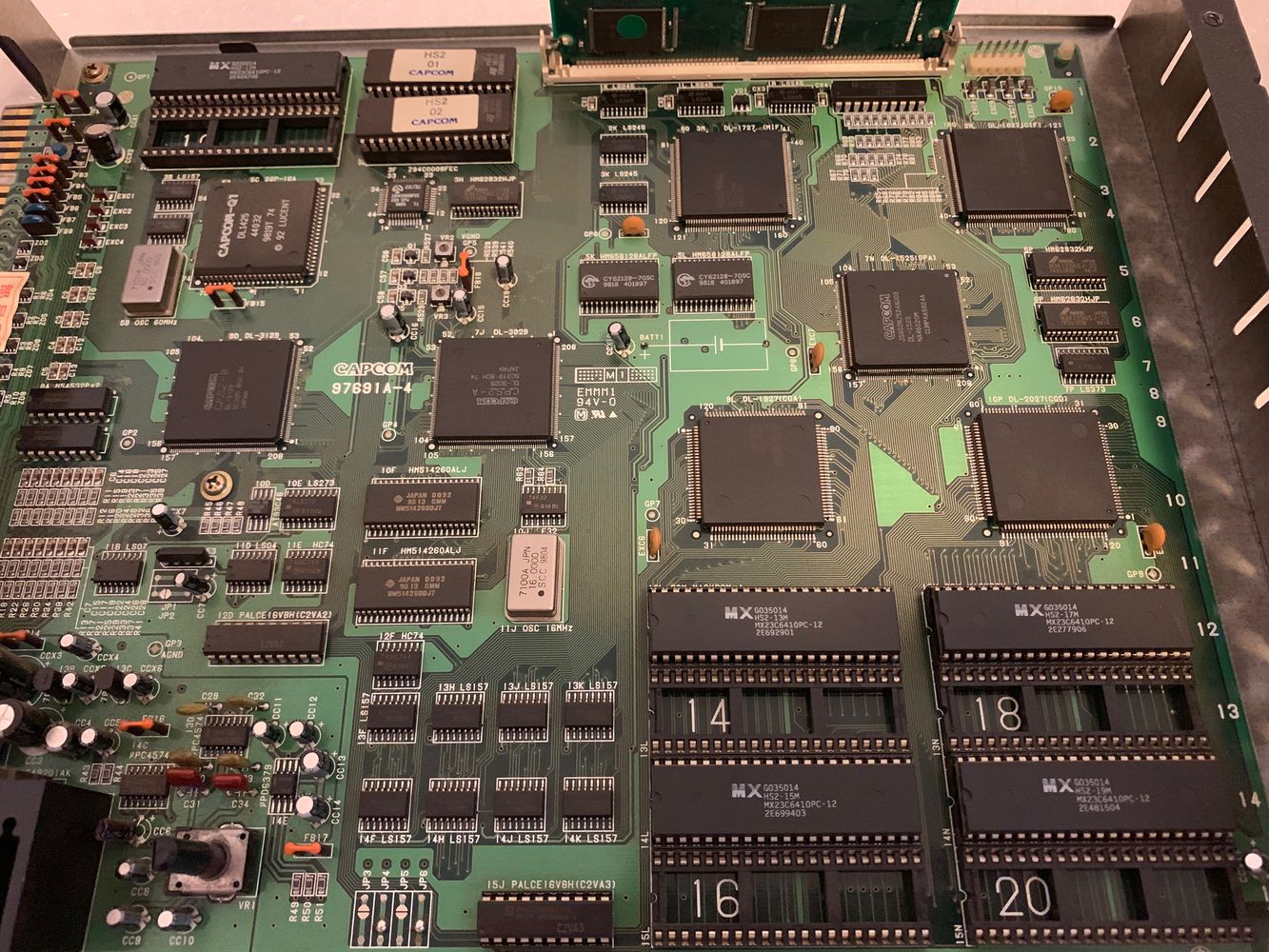

13. If you're looking to do a conversion, remove all the mask roms and Qsound roms from the board. Replace them with your newly burned mask roms and Qsound roms. Place your 32MB Simm back into it's slot as well if you haven't already
14. You will need to adjust the jumpers. I've noticed that all PALG conversions that I've done required that all the jumpers to be OPEN. By default for MVC it's set to 0101. Change this to 0000

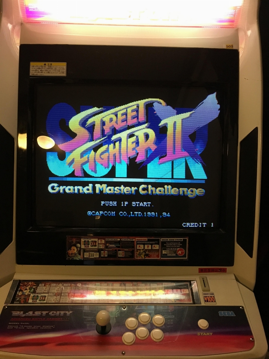

16. Now connect your CPS2 to your cabinet or supergun. Hopefully you'll get a screen of your new conversion or resurrection :)

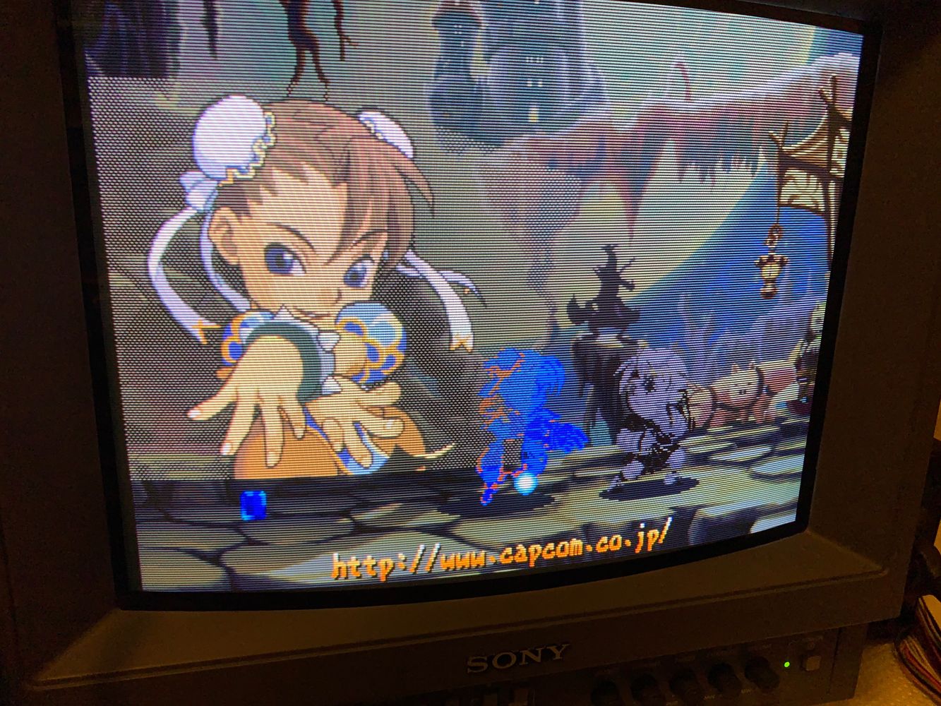

Hey guys, I have some issues trying to use my MvsC board with another game, mostly with the sound, but also with the graphics for the game I've tried that use maskroms for graphics in locations 14/16/18/20.
So far I've tried :
  1. a burnt Dimahoo eprom set (does not use locations 14/16/18/20) => the game seems to look & play fine, BUT I have sound issues (like missing 50% of voice/effect samples and parts of the music)
  2. an original Battle Circuit eprom/maskrom set (does not use locations 14/16/18/20) => same as above
  3. an original Super Gem Fighter eprom/maskrom set (DOES use locations 14/16/18/20) => same as above + wrong colors on some character sprites (initially I was completely missing those sprites, until I opened both JP4 and JP6 jumpers as suggested above)
I've used the "Phoenix" romset used by MAME to create the SIMM files with cps2black, rather than the Team Avalaunch set or the original + infinikey, but I don't think that should make a difference in this case.
Regarding the fact that only PAL-G games can be converted on this board : afaik the PAL only influences the graphics, right ?
Super Gem fighter is using a PAL-G as well, but I still have issues with the colors described above.
Dimahoo is supposed to use a PAL-G as well, and Battle Circuit is using a PAL-D.
Also, SSF2X converted above is supposed to be a PAL-B.
I have the original PALs for Battle Circuit & Super Gem Fighter, but I'm not sure they are going to be of help with this board.
Any advice ?
I've tried opening JP2 but the board doesn'boot in this case :P

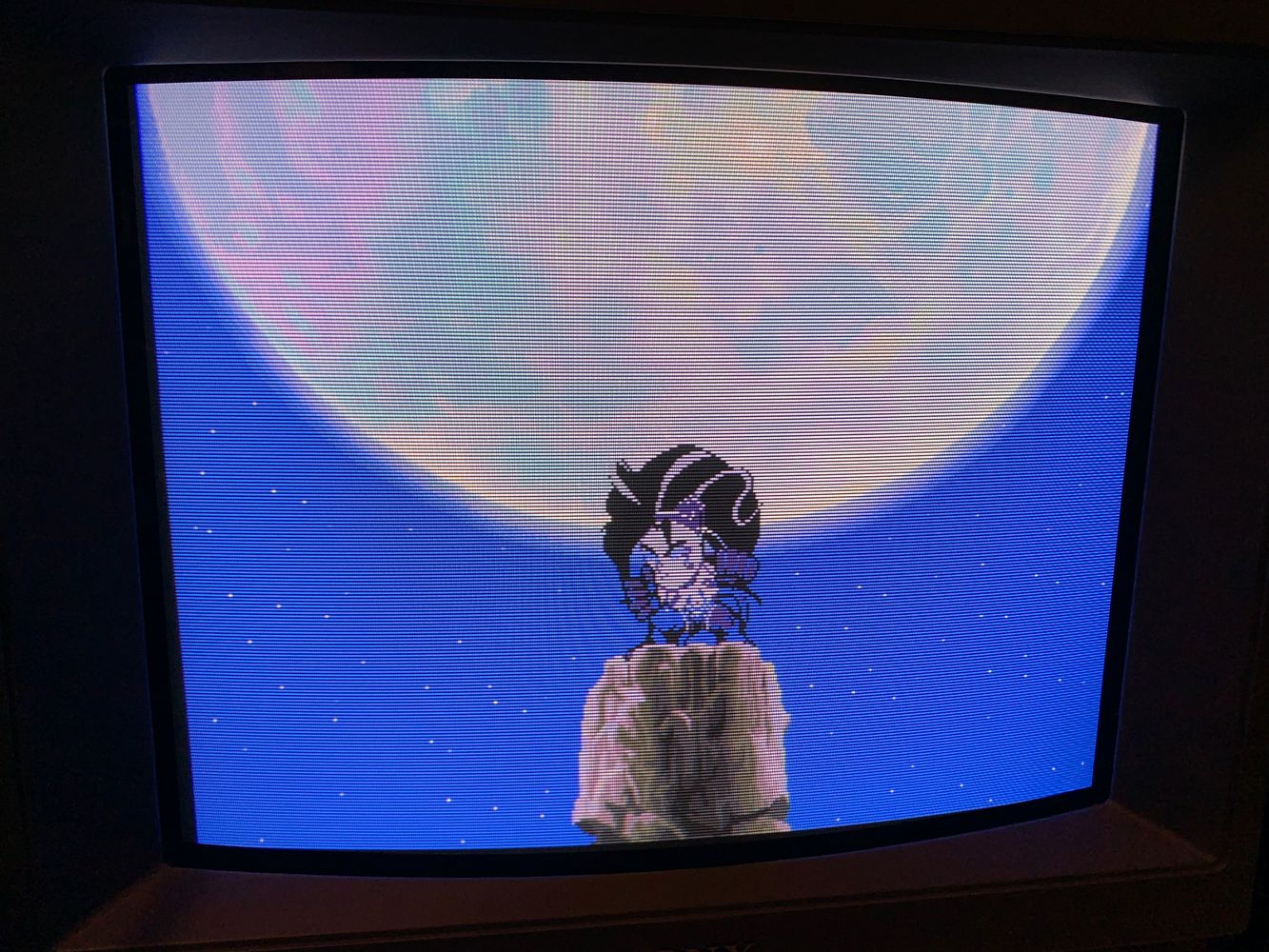

Edit: attached some pics of the Super Gem Fighter graphical issues.
Weird thing is, in the intro the first few frames of Felicia's sprites have wrong colors as shown, and then they become Ok when she starts to bounce like a ball.

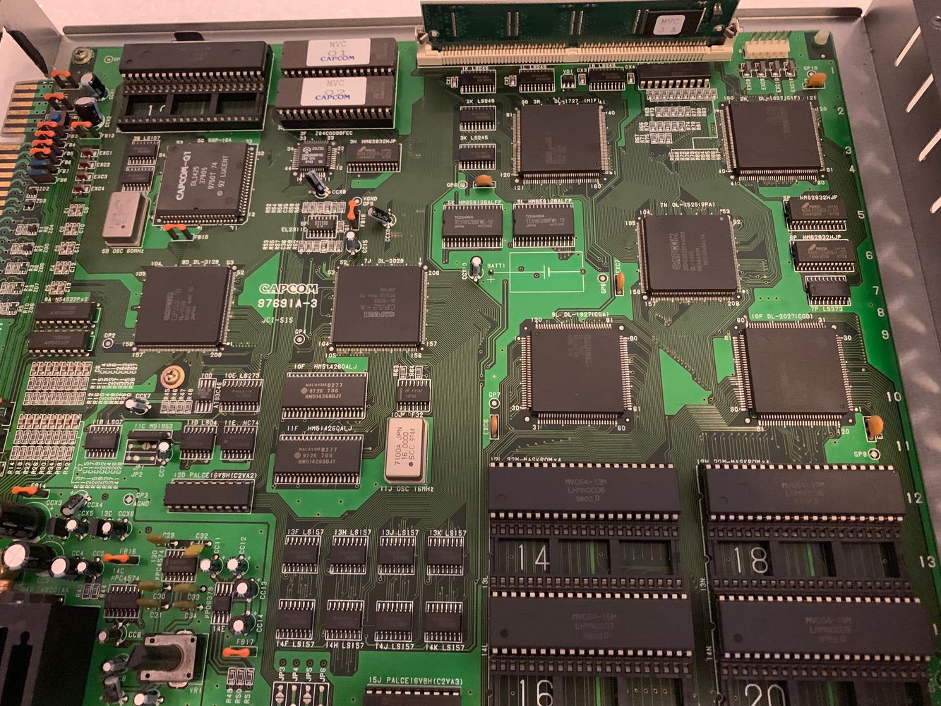

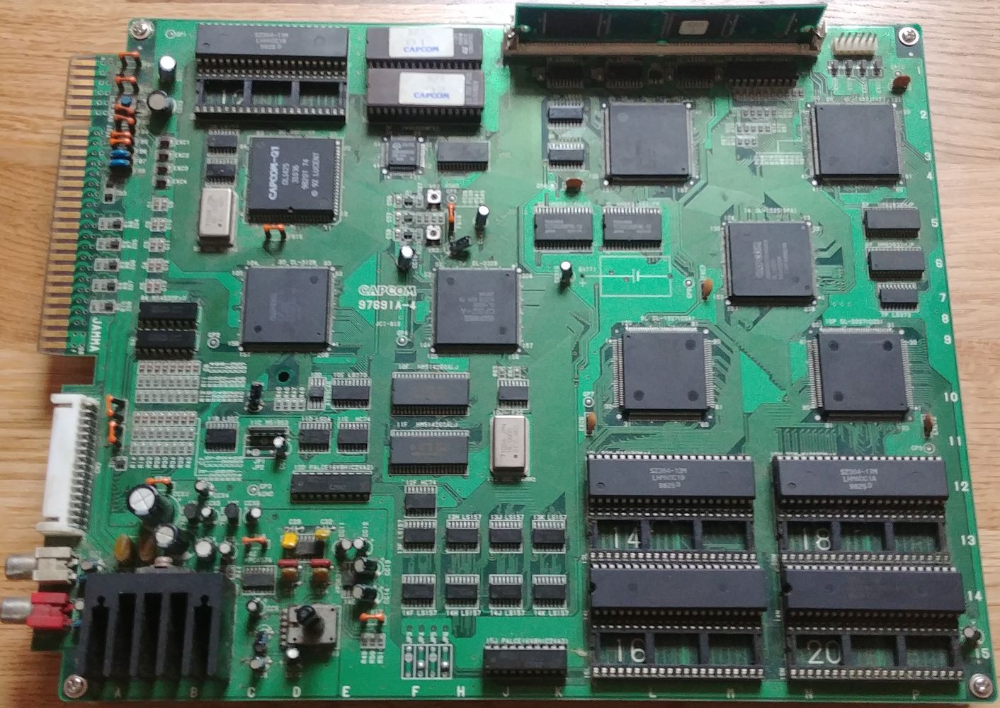

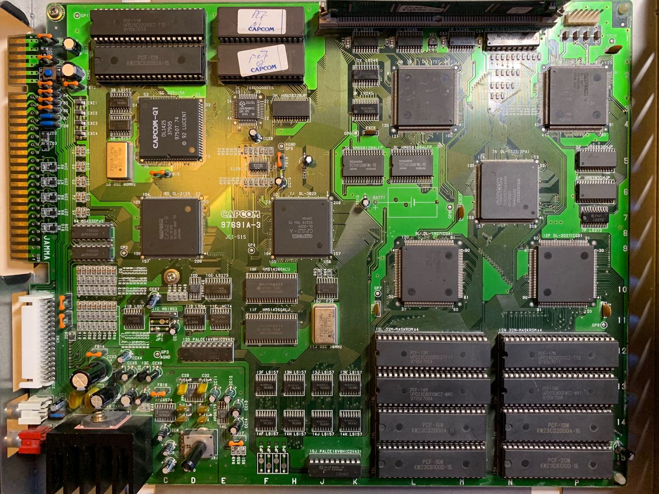

do you have a picture of the board so I can see the rom layout?
I've successfully converted to Alpha 3, Super Turbo and Hyper Anniversary.
There you go, Super Gem Fighter with 8 gfx mask roms.
And for comparison, pics of some original MVSC, HSF2 and SFZ3 PCBs, which all use only 4 gfx mask roms.
I guess I'll have to try all the remaining jumper combinations.
