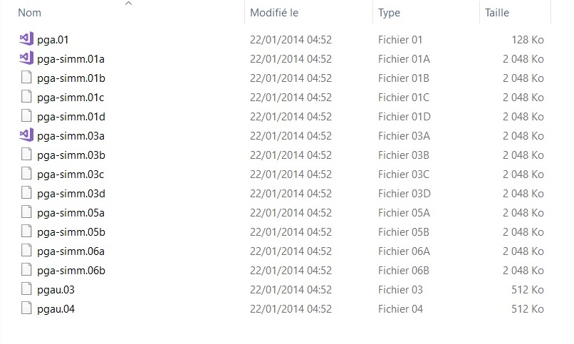

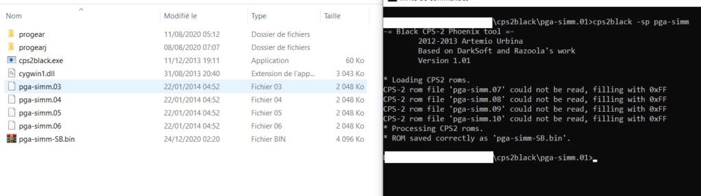

I try to burn in 64 mb and 32 mb simm progear with cps2black.
this is the romfiles:
for example the first 64 mb SIMM have 4 files, pga-simm.01a,.01b,.01c and .01d.
To be reconized cps2black I must change the extension by .03,.04,.05 and .06. 2048ko each.
Changing extension could it make issues?

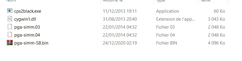

after treatment I have one .bin but only 4096ko, is it normal?
for 32mb simms I have to file same thing, change extension to .03 and .04 and 1 file 4096ko (more coherent)
could you help me?

I'm not sure CPS2Black supports the 64Mb SIMMs that are used to hold gfx data on some regular plastic case CPS2s (Progear, Mighty Pang).
I think it's only designed for the single 32Mb (or 4096kB) SIMMs used on black all-in-one CPS2s, where it replaces the program Eproms of regular CPS2s.
