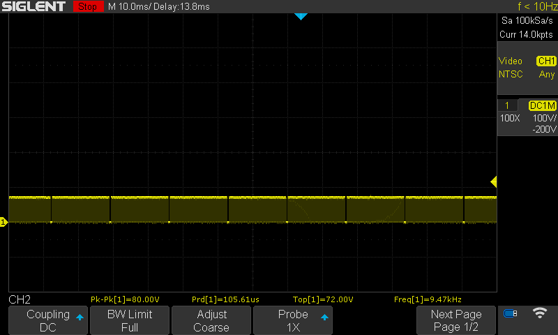

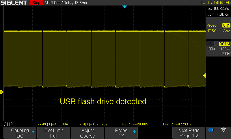

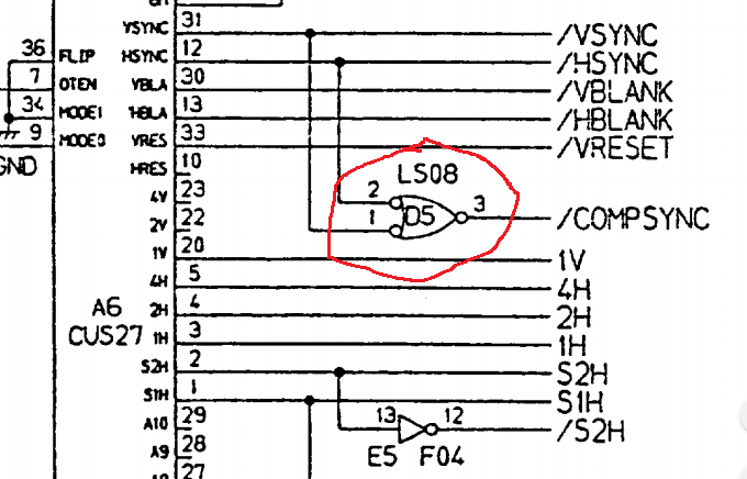

Could be a very weak sync signal. A friend is going to do some tests on other Namco System 1 titles to see what's up, https://www.system16.com/hardware.php?id=524
Apart from Splatterhouse - things are working ok?
), but the TTL sync channel will not.

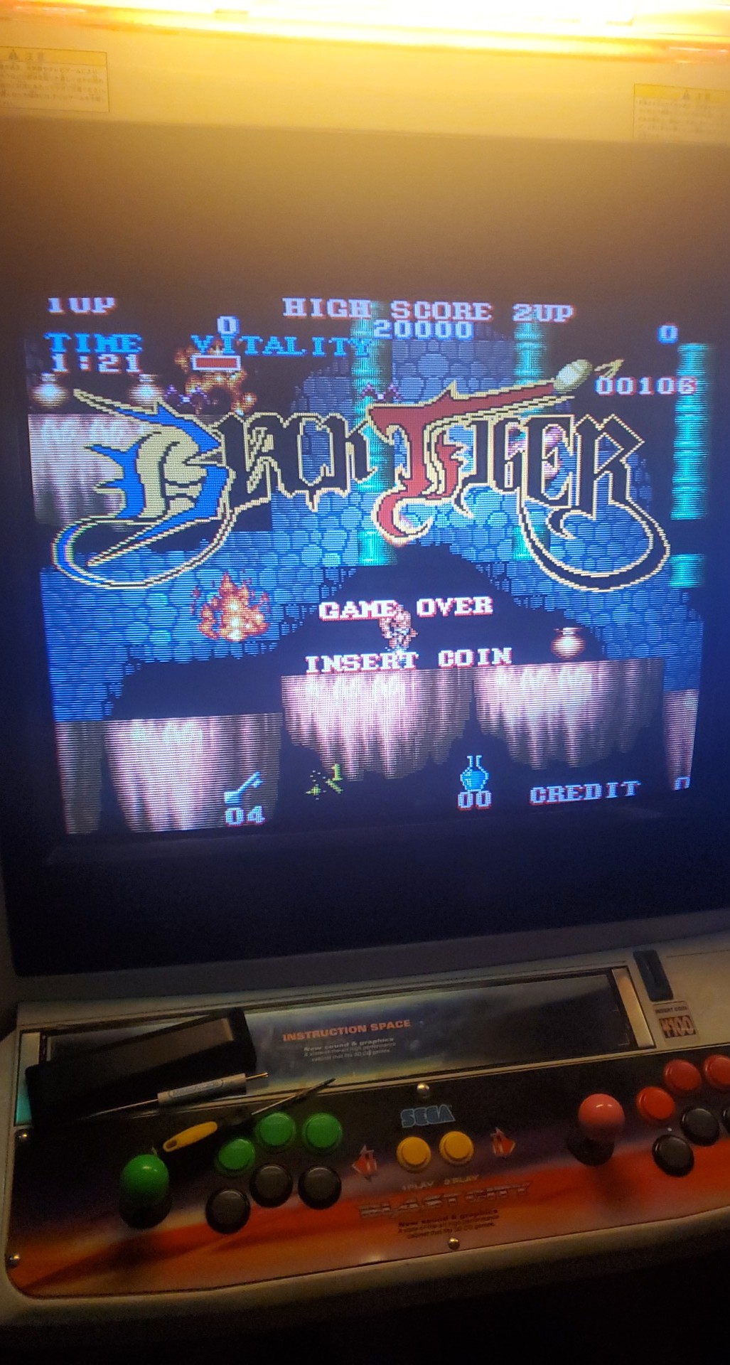

Great stuff! I've updated https://irkenlabs.com/retro-scaler-a1/tested-sources - thanks to all who have contributed so far.I tried
they worked fine after plugging retro scaler into a power strip no more megawidth
- black tiger
- fighter&attacker
- ninja gaiden
- tekken2
I did have to adjust the horizontal on chassis as the older games had black bars on side but looked nice but no black bars anymore
