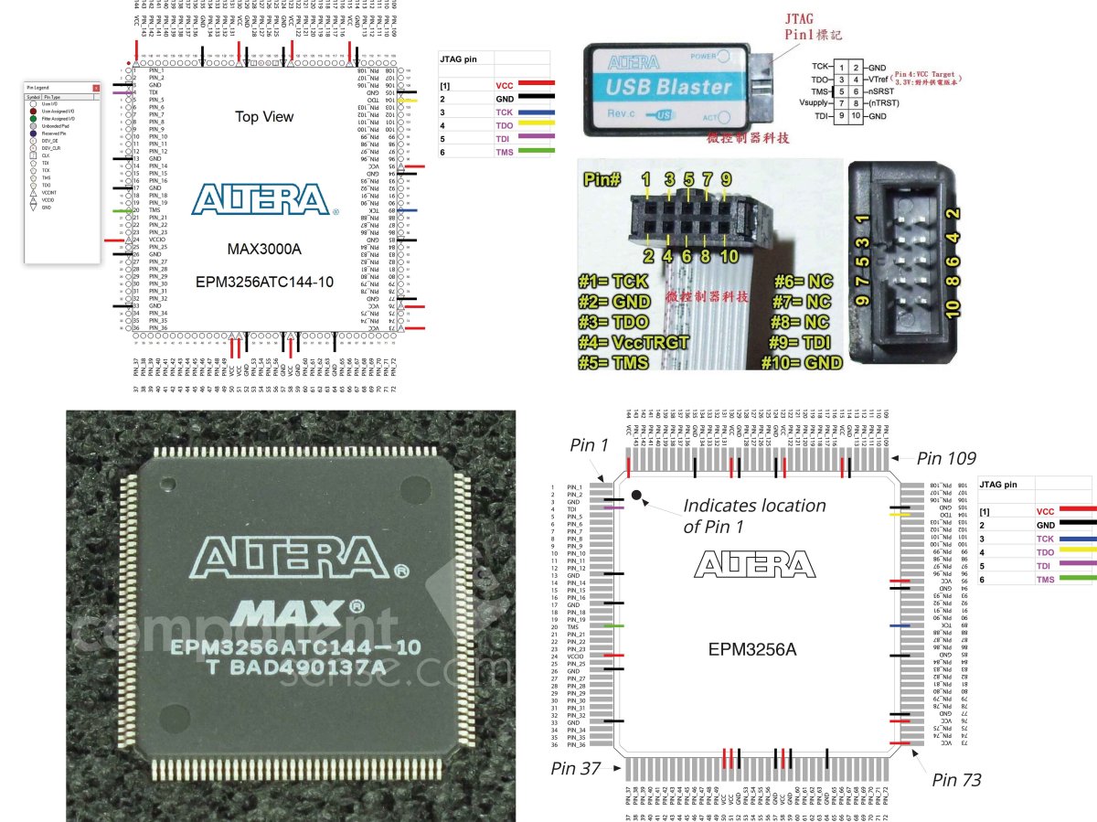

Hi, i desing a design for jtag pinout for the altera max 3256:

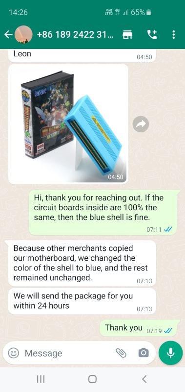

I have one of the Aliexpress sellers in my Whatsapp contact list. They at least claim that everyone else copied "their motherboard" ;)
If @Vortex, @rockbottom and anyone else involved is OK with this being exposed to them, I'll try chatting with them.
