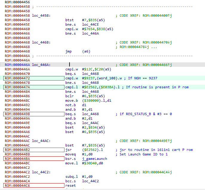

After some tinkering with unibios 4.0 I believe that Pick'n'Mix will not work with the stock v3 cart.
@Vortex please correct me if I'm wrong. Some infos on this would be great.
First, unibios does 2 checks before PnM will be enabled:
  1. Check NGH at $108 if it is equal to $9237.w
  2. Check a long word at $000E03BA.l if it's equal to $000E2562.l
If both checks are positive unibios will jsr to $E2562 which is one of 2 routines that talk to the MCU via $2FFFE0.
I suspect these routines to handle softDip-Settings-Saving and Loading from/to the EPROM in the MCU.
The stock v3 has NGH 9237, so this check is passed.
All of the routines that talk to the MCU via $2FFFE0 have been NOPped out, so the 2nd check will fail and PnM will not be activated.
Instead the BackupRam's 8 Slots are deleted with $0000 (ngh) and $FFFF (names) upon launching a game from the V3 menu.
It's not a showstopper, but it means that PnM is not working for a stock 161in1 v3 and of course if you have a custom gamelist and the NGH is set to $1234 PnM is out of the question.
SoftDip-Settings-Saving on the other hand is something that I'd be interested in. I wonder why they abandoned using it while leaving the MCU/EPROM on the PCB.
I attached the routines as txt file for reference. These are present in all 161in1 but not used on a v3.
Works fine here.
That's really interesting and makes me believe that there must be different versions around.
Could you please try to start a game and enter the service menu, then change some SoftDip Settings and power off the system for a while.
If the settings you changed are present after you power on the system and restart the game,
that'd be cool, but means either my research is bad or there must be different P roms around.

I'm assuming there are several versions of the V3 cart. Pick-n-mix works for some, but not for others.
As for my custom cart - I've made several menu edits relative to the original dump:
- I changed the procedure for switching ROMs (it was more convenient for me)
- I removed (did not add) the return procedure for each game in order to preserve the original game code and checksum.
- I removed all interaction with the MCU. This includes last game saves and software dip-switches.
If you need and interested in this functionality, you will need to do a few things yourself:
- provide the bsram file containing the default bsram data for each game;
- implement interaction with MCU in the menu;
- (most important) implement interaction with MCU in CPLD.
