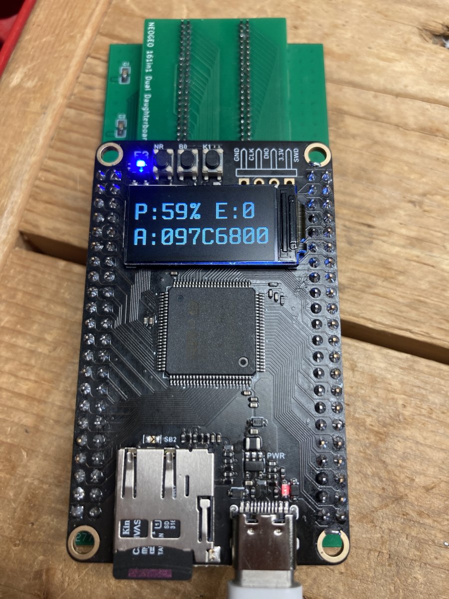

I too have the FR-300 so 0.6mm is not an option. But I have a professional hot air station. After you apply some fresh solder (it seems the factory uses lead free) set the station at 450C and go at it. Keep it moving (the space between the pins can bubble up, but will shrink back down as it cools, which is no big deal as it's a 2 layer PCB). I was able to remove the daughter board with no issues.
