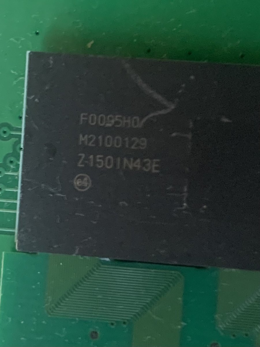

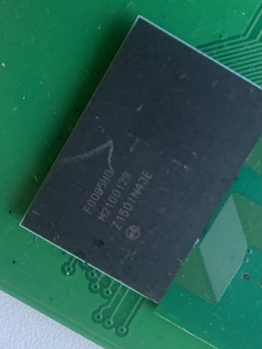

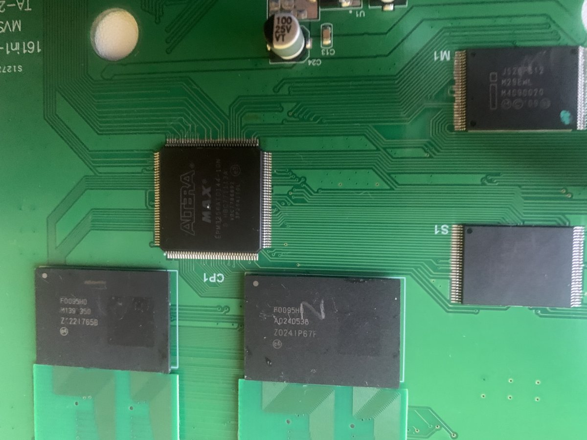

Unfortunately, the voltage mod is not a magic bullet. I've now purchased over 50 "brand new" F0095H0 chips that have never been soldered before. They are all pulls (you can see the residue of the sticker on the face of the chip). Failure rate is about 15%. Every time I asked for refund for the dead chips, I get it in under 15 mins! The seller dumps these on AliExpress without testing them. I'm guessing surplus from making multicarts?
Failure range from data lines open to internal shorts per new firmware.

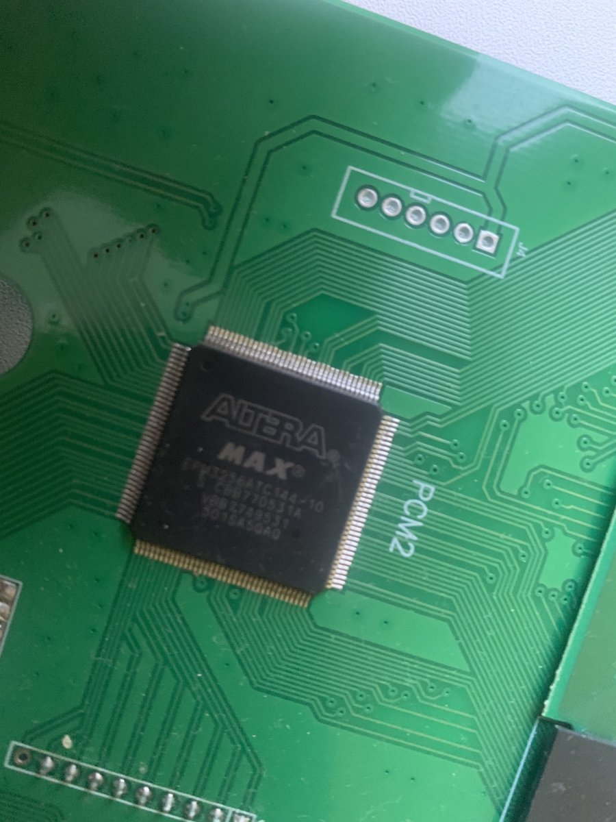

I'm still trying to understand why they no longer make/sell these multicarts. The only component that I can't buy on its own is the CPLD. Have they run out of this 20 year chip?

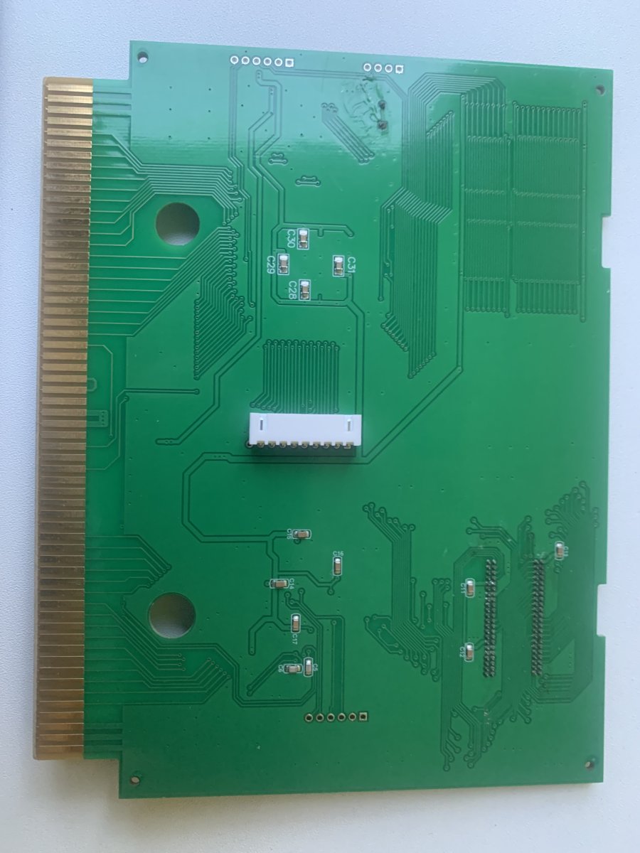

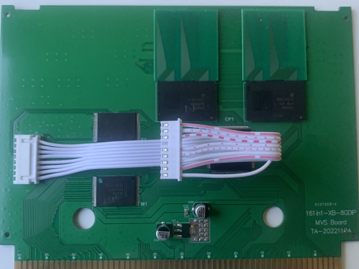

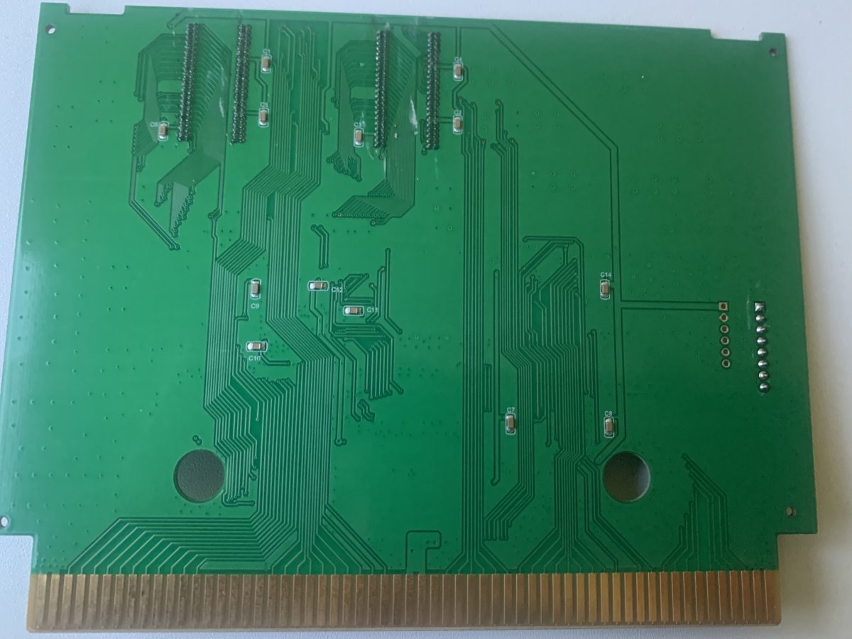

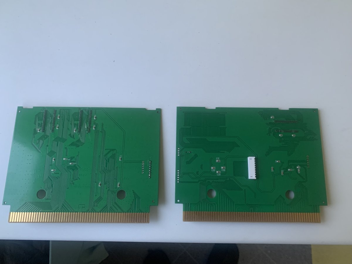

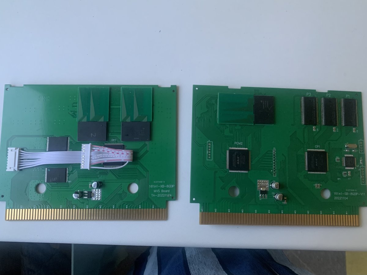

Hi, the price is so high. Thanks for the videos, can you send to us the photo of the pcb of these cart. Thanks.
On Alibaba can be find the mvs v3 version.
https://m.alibaba.com/x/x8LzqCC?ck=pdp

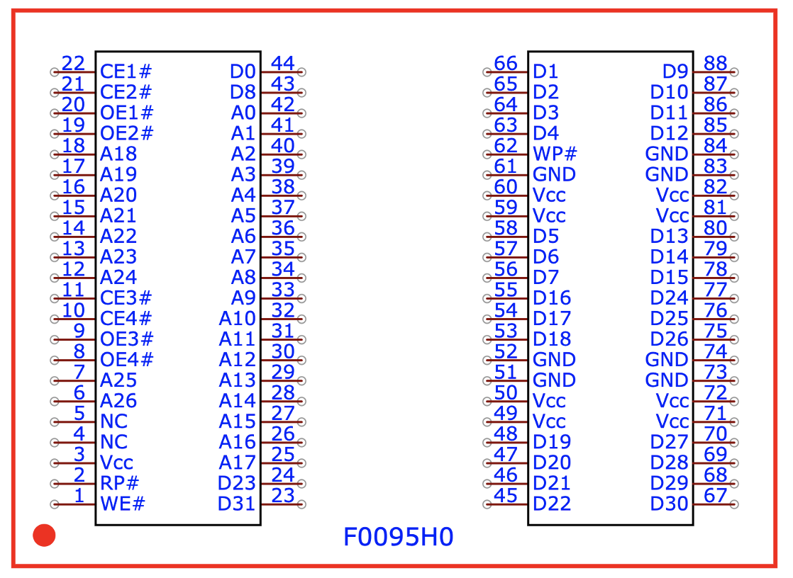

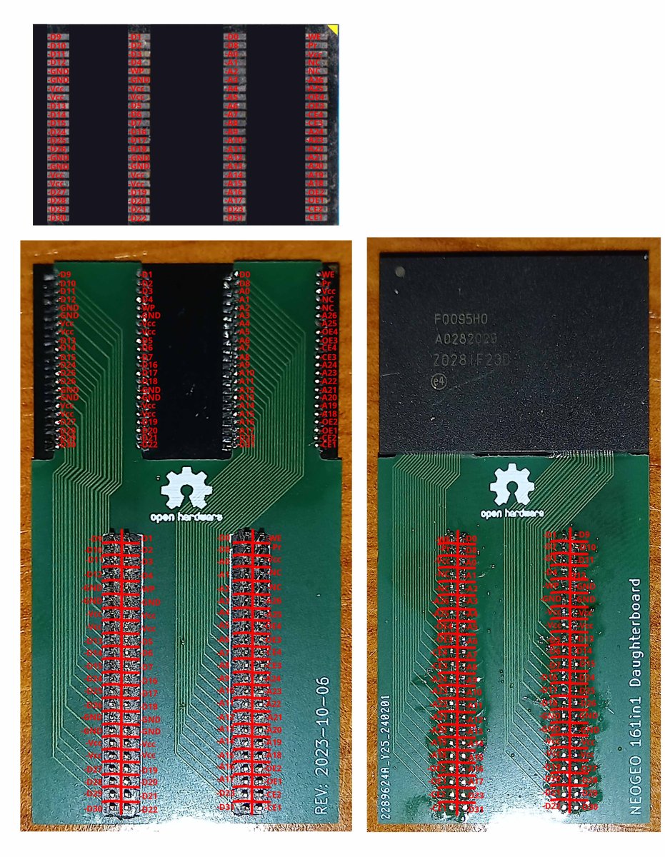

Hi Ikari, so many thanks, I use your binary and the voltage mod. With the old firmware I have so many problems to program the chips but with your firmware some chip become to life, and one of Best feature is the short detection, but sometimes for me Is so Hard to find the shorts, is possible a image reference for the pin number on F0095H0. I don't have any problem with my pogo programmer, but when I put the chip on the adapter, sometimes I have problems to find the shorts.
Anyway soo many thanks.

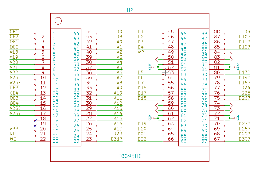

A picture like this one https://github.com/xvortex/VTXCart/blob/main/Docs/Picts/F0095H0_p.png ?
This is the correct image I created for my stuff with the correct pinout. It also matches the pinout as written on some PCB revisions. Moving the "dot" is not sufficient. Note the pin numbers.
I wasn't sure how to do this digitally, so I just wrote all the correct ones next to scratched out ones on a printout. Thanks for making things easier for folks!
The voltage mod saved 42/46 chips I'd thought were dead, so very appreciative for that. Like you, most of my failed chips came from abroad. The ones I bought domestically haven't been nearly so temperamental (not that they didn't at some point come from overseas, but it was years ago now rather than in the past year).
