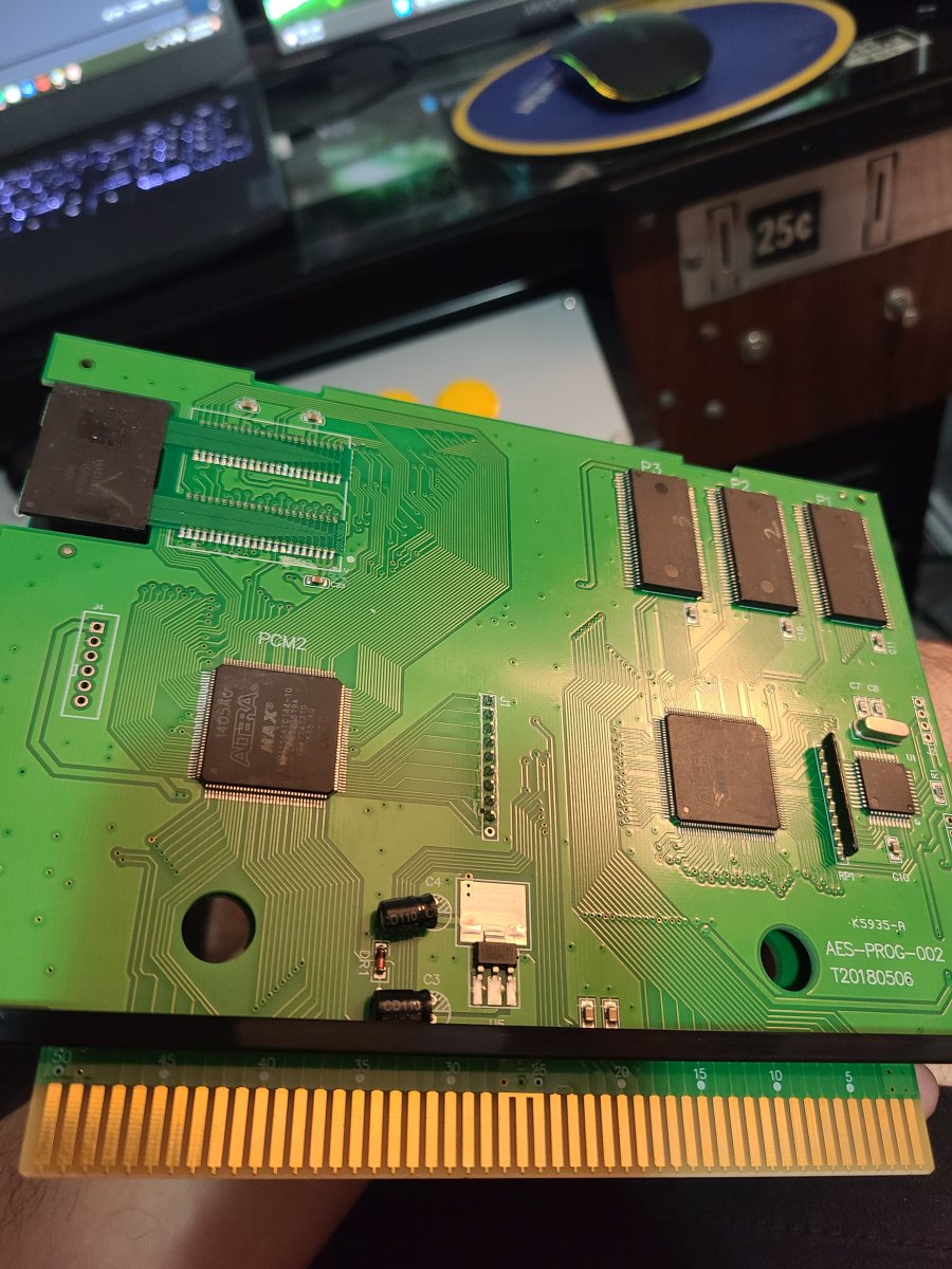

So what's the deal with these ones? I know in @Vortex 's repo there are pics of a cart with this style daughterboard. Are these effectively the same, just visually different, or altogether not usable? (clearly need a different daughterboard PCB). I'd have assumed not usable, but the pics in the repo have me second guessing.
If the connections between the ROMs, the CPLDs and the board edge are the same, they should be usable. Otherwise you will have to do some reverse engineering to figure out how the signals are connected, and modify the CPLDs code in consequence. Regarding the dumping and flashing, on Vortex repo there is a gerber file called "VTXCart_CV_STILT.zip", that I assume is just for this type of daughterboard. And even if everything goes well, I suppose you will have to design your own double daughterboard, or figure out another way to add the third C chip.
