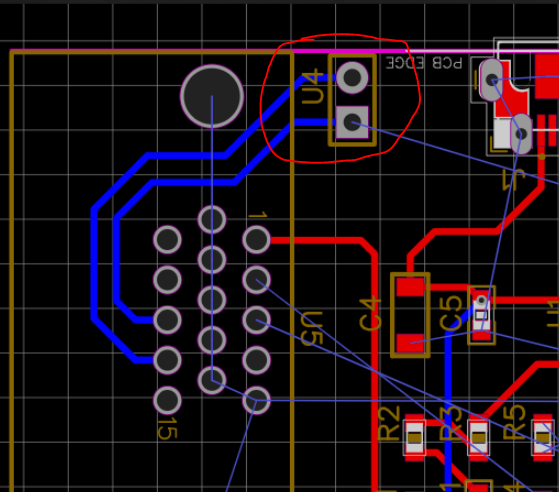

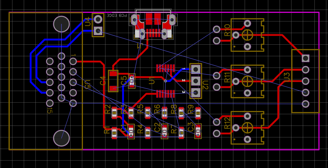

I am going to take another whack at it soon. I've been studying Arthrimus's JAMMAizer in Diptrace and know I've built the circuit incorrectly. The hurdle now is to learn Diptrace. I only know how to use EasyEDA, sadly.
That would be awesome. I haven't been very active for the past year or so due to real-life stuff, but getting more into the hobby again recently. I'm eager to try out the new revision should you get around to it :)
Wanna explain which part of the circuit is incorrect? Kinda curious about it, I looked at it with @PascalP and we didn't spot any major issues back then comparing it to Arthrimus's schematic.
Yeah man, I feel ya. I was MIA for a good bit too. Weird how life in the pandemic has me home 100% of the time, but strangely have made no time for the hobby.
Download Diptrace and open up JAMMAizer's Diptrace file in there. It becomes immediately apparent. Also, Arthrimus installed test points for ohm'ing out/tuning the RGB pots which is a nice touch that should be implemented too.

Starting to understand this a bit better now.
Still learning Diptrace though.
Taking another stab at this as I understand things a tiny bit better (not an engineer):

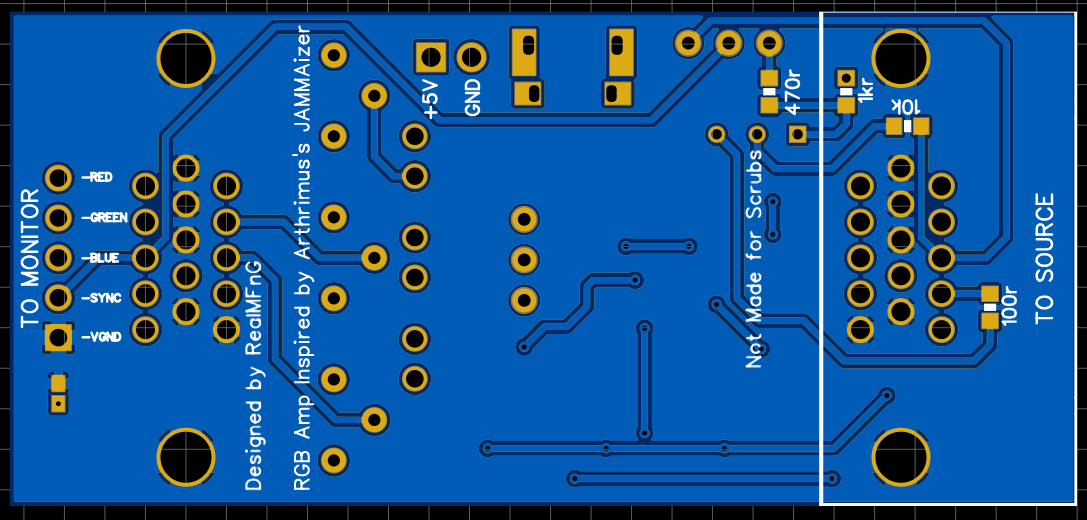

Starting to take shape:

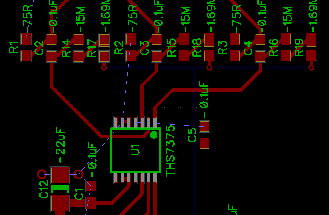

From the datasheet, THS7375's LPF (low pass filter) is OFF if connected to +5vdc and ON if grounded. A 3 position jumper will allow the user to select what they desire. A 2nd jumper combines H and V sync into CSync for MAME users. JST NH connector for the monitor connection.
Fun little ditty. Just gotta make sure I route the traces correctly at this point. Form factor is in place (keeping it as small as possible). All componets but the JST power connector (for Naomi users) are in .

It is done and ready to go (I think). Double checked the routing. Seems legit. Just need to order up some PCB's now.
Let me ask you guys, should I put a female VGA right angle connector on the side going into the monitor (right side of this pic) as well? That way you'd have the flexibility to use both an DSUB15 RGB connector and the 5 pint JST NH connector.
Looking good bud! And a big YES for the VGA connector :)

Question about VGnd. Can I have VGnd be its own copper pour? Or does VGnd need to connected to common ground?
@invzim, the XOR gate used in JAMMAizer, it is it correctly producing TTL sync? I might as well put it in if that is proper.

  • Video ground and common ground have their own separate copper planes. I am not sure if that works. I suppose I will find out. There is a jumper that connects both planes together.
Let me know if I missed anything.
I would keep it simple, all my stuff has common ground for everything and with video gnd=gnd.
Thanks @invzim. I wasn't sure. I have pins 5-8 and 10 along with HD15 shield connector touching VGND on their own copper plane. And added a via jumper to connect VGND to GND if it doesn't work out that VGND can exist on its own ground. I'll find out I suppose; FOR SCIENCE!
