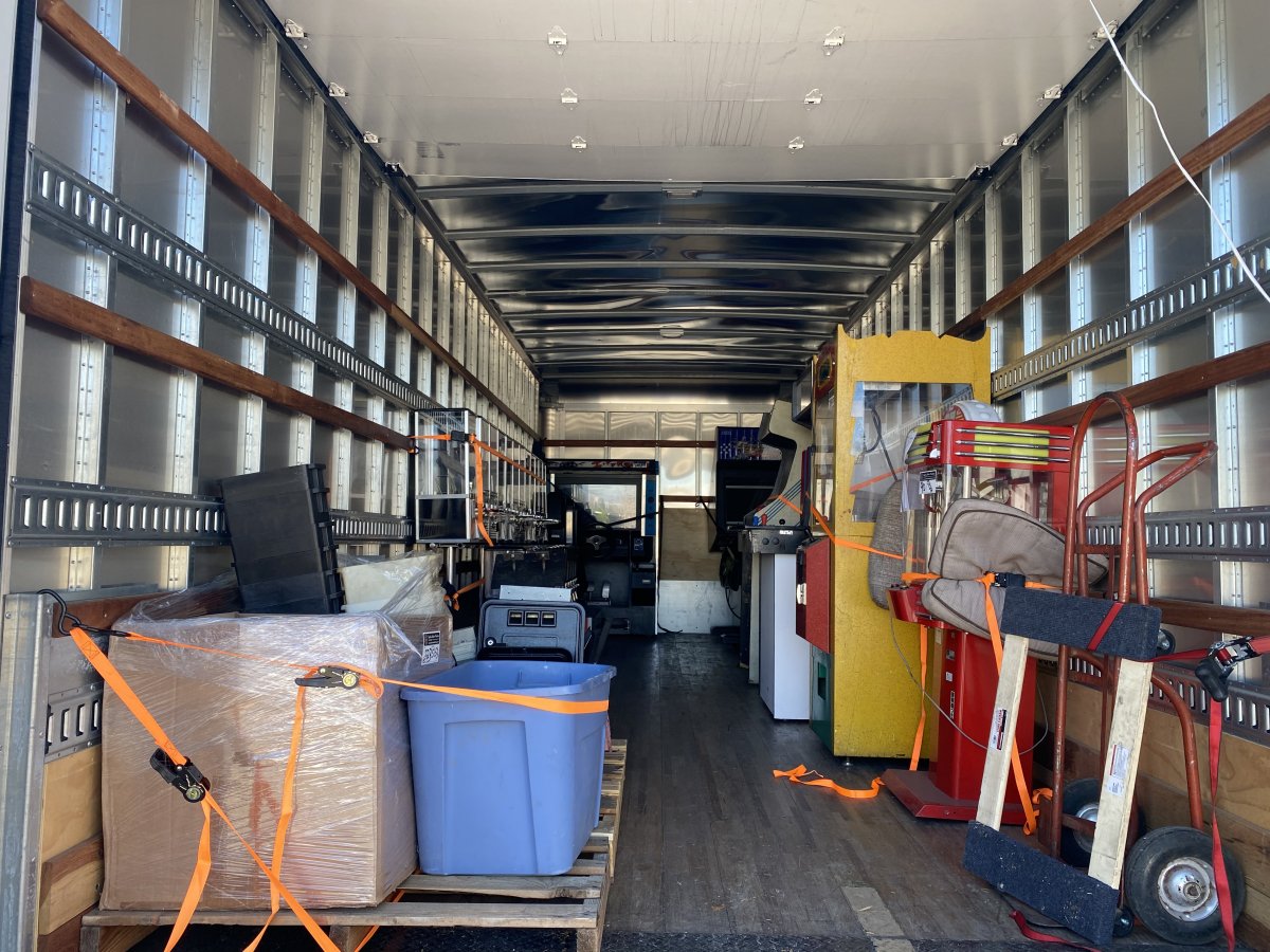

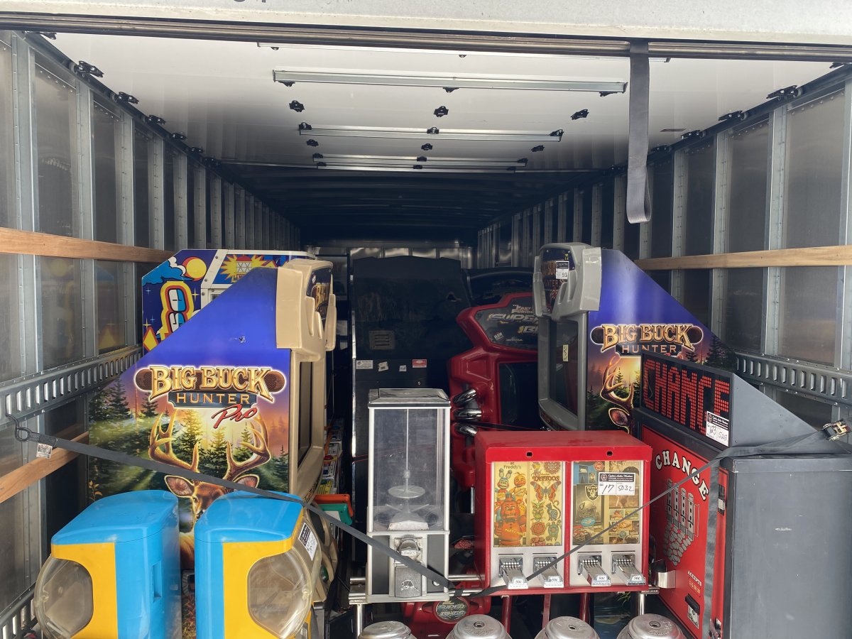

Just completed another epic captain's run in a 26' Ryder truck. I picked up 1 cab in upland for a friend and about 10 pieces at captain's auction warehouse. I also dropped off 4 pieces to sell in the next Captain's auction. I did the Sac -> Anaheim -> Sac trip in about 36 hours total. I got mostly vending stuff for my route... but I also got a ton of Mars MEI Dollar Bill Acceptors. And a big bucket of namco guns, which is perfect since my Time Crisis II is acting up.
This was a crazy past couple of days, but I got it done!

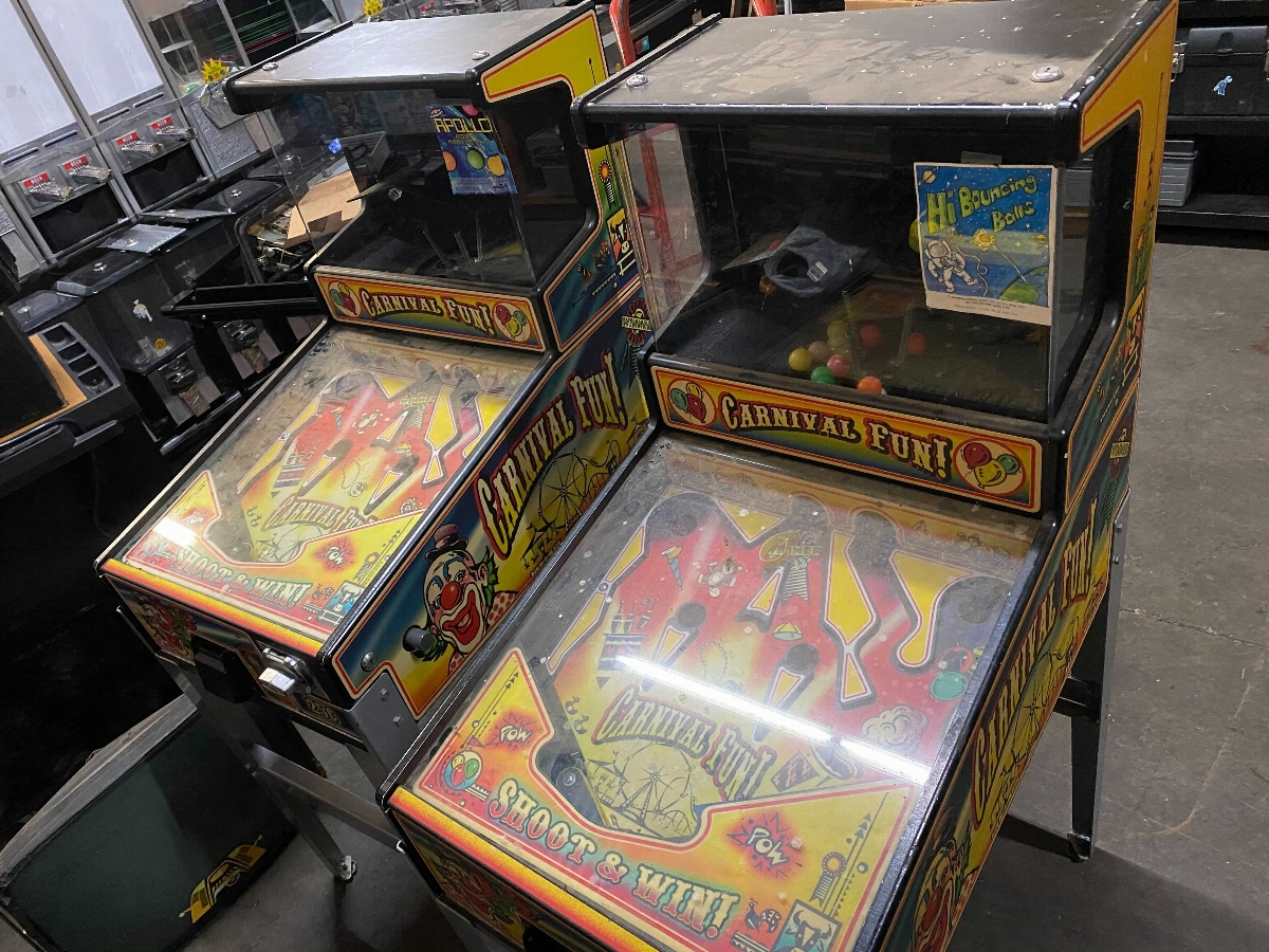

I'm also working on these new gumball games I picked up for free!
I have always wanted a gumball machine, and these are vending machines that are also a game! so that's cool, imo. I think they will be nice once cleaned up.

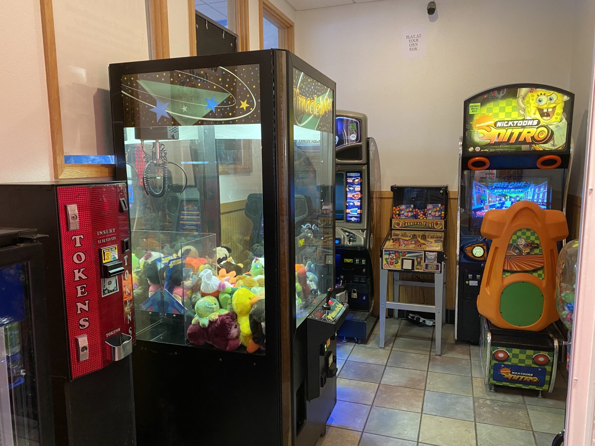

I got some free junk! So I did what I always do, fix it and restore it with an anal retentive level of detail. Did a refresh on my laundromat location today! The candy crane that was there previously kept breaking down on me. Since I got this Elaut crane up and running, I decided to take it to replace it.
I also replaced the Cruis'n Exotica w/ LCD I had there with a Crazy Taxi. I installed a new coin door with dollar bill acceptor on the crazy taxi and it's $0.50 per play... I think it's going to do really well.
And the two gumball launchers pictured in the last post were also placed today at this location. I cleaned and modded them with modern rechargeable batteries. One is running premium hi bounce balls and one is running dubble bubble gumballs.

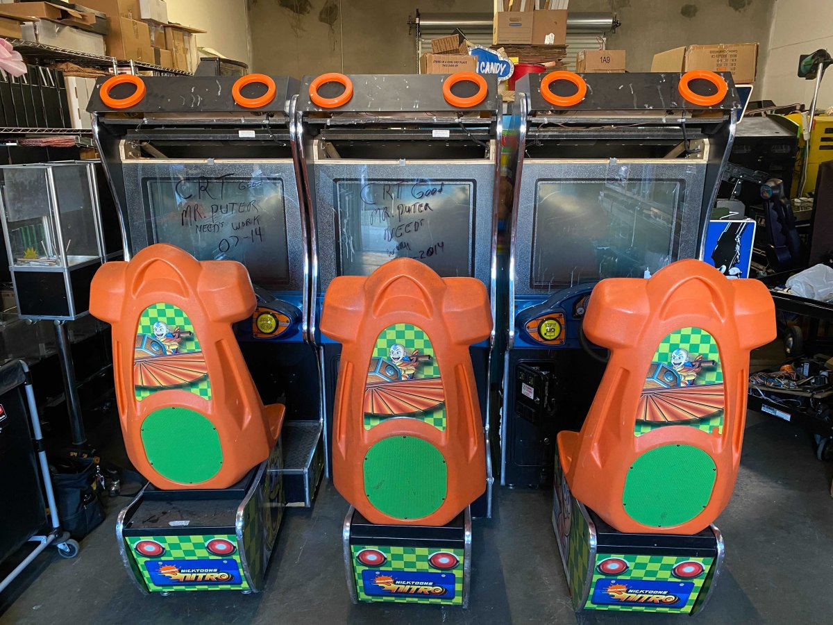

3x non-working Nicktoons Nitro games. I think these might be somewhat rare? I can't find much info online. It's a game by Raw Thrills and it seems the cabinets are made by Chicago Gaming. I willl have to do a lot of cleaning before these things look good. Then there's fixing the PCs inside. Supposedly the monitors are good... they're supposed to be 27" neotec svga monitors so that's cool?

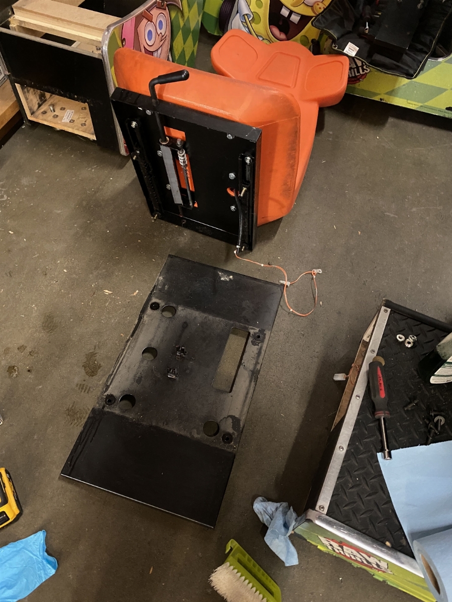

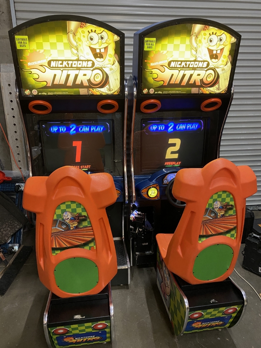

Here's some in process and after pics of the first restored one. The second one should be a little nicer condition I think and I will probably try to sell that one. The third one is missing the side art, computer, and some raw thrills pcbs, and most of the harnesses... so I think that one is destined to be a parts cab. All three monitors are 27" Neotec SVGA monitors and they do work. I got the orange pumice cleaner trick from another op, it does work but requires a lot of elbow grease still.
I'm happy with the way they are turning out. I think my gut instincts were on point when I saw the deal for 3 of these, non-working. I just assumed I'd be able to save at least 1 for sure... turns out I got 2! Probably not the most enviable game by the average arcade-projects member... but as an operator these are like cash factories! This is a Raw Thrills game that was made in 2009 I think? Not that old... this cab still holds a lot of value. Yeah you know Raw Thrills... Eugene Jarvis' company. At least you should if you care about this industry at all. This game is not really as celebrated because yeah it's for kids... but really all of their games have been hits.

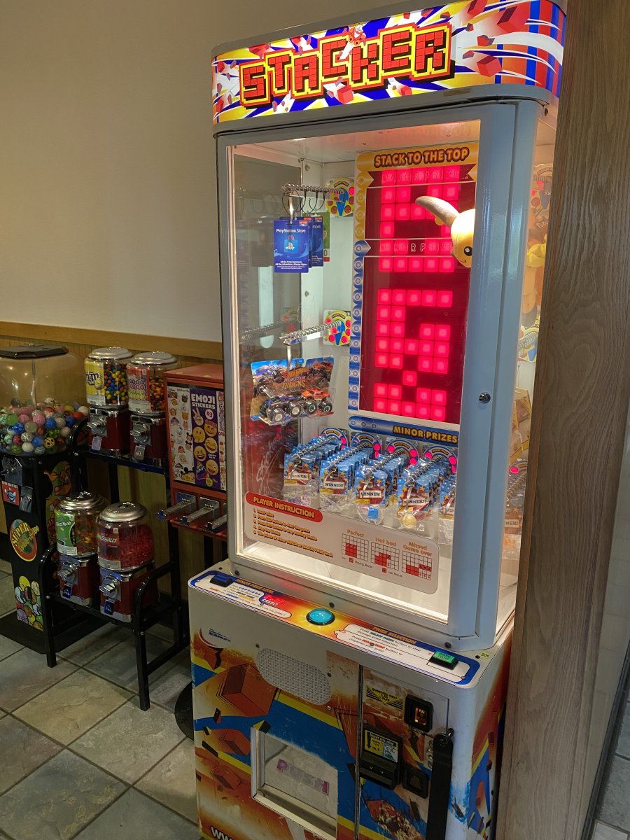

Just a quick update. Been hustling so hard. Picked up another new location today. I planted the seed last year, Aug 25 when I dropped in to talk to the owner. It's another pizza place. That makes 14 locations currently. This one is going to take about 10 pieces to fill out, I wasn't expecting to land it since he never called me back. But today he said he's ready for me to bring games and vending over. I'm going to have a busy next week scrambling to get stuff together and ready to operate.
I also got some other stuff on the horizon... but I don't want to jinx myself.
Here's some pictures of the new location I mentioned. It took me 3 trips to get this much equipment there so far. I replaced the previous arcade op here, but there is one more vending operator who has neglected machines. I told the owner I can do everything so he's kicking out the other guy too. I'll have to bring a couple more things here whenever that actually happens. Right now it's about 10 pieces.

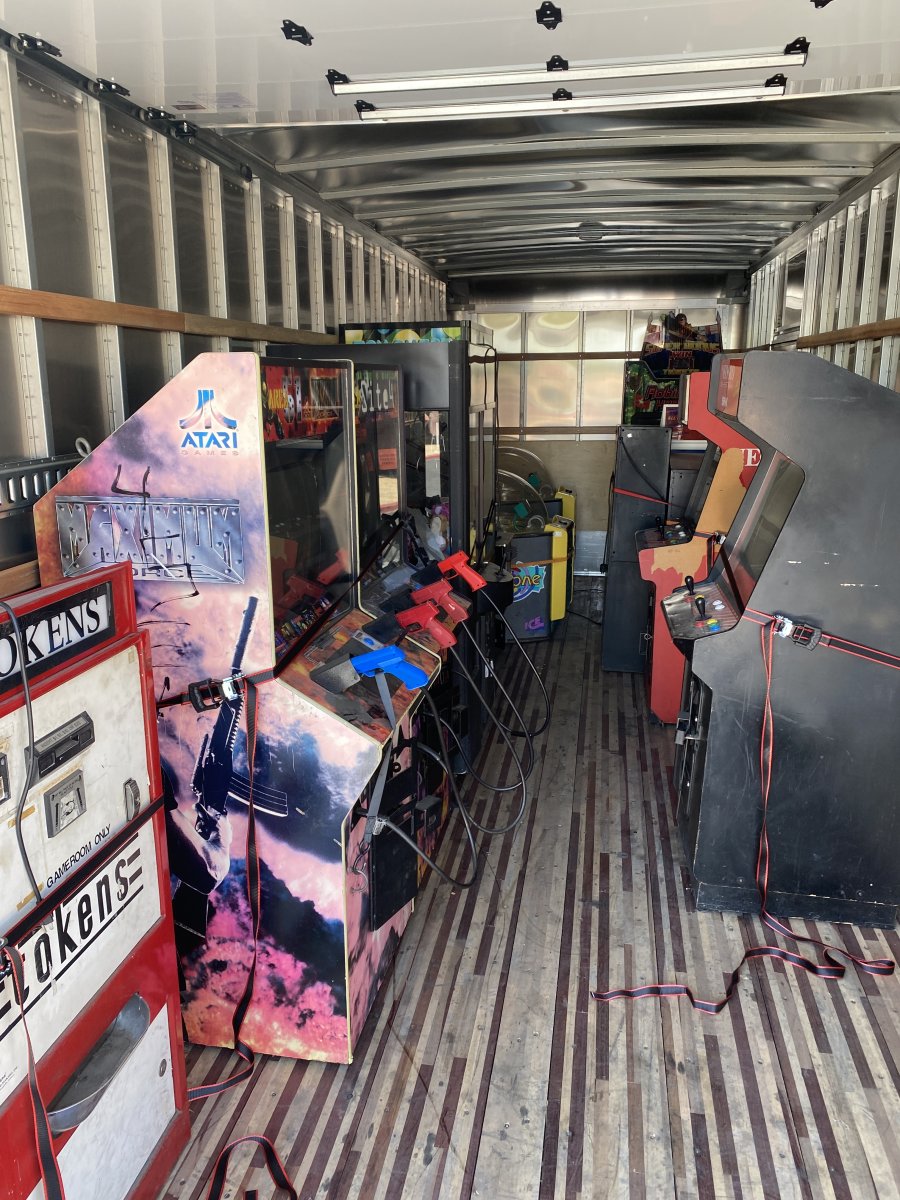

I also just did a Captain's Run the past couple of days. I took some stuff down to sell in the next auction and I brought back what I had purchased to put out on the route. It's almost all non-working stuff... but that's how I roll. I get things broken or non-working for cheap usually, fix it, clean it, and put it out.

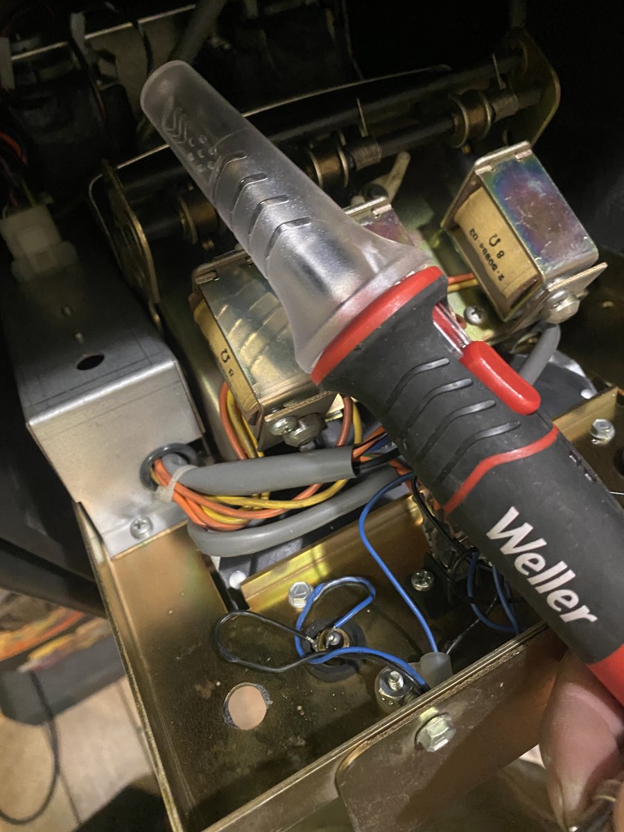

And one last update is a tool recommendation. Most of you hobbyists will not necessarily have a need for something like this, but if you have a route or do service calls this is an absolute must! Or even if you work on pinballs it can be handy to get the device right where you need it, inverted, in the dark. The Weller WLBRK12 portable soldering iron is super useful in the field. Is it better than my WES51 soldering station? No, but its advantage is its cordless, battery powered design. It has enough juice to run for 30-45m it seems. Which is more than enough to do 2-3-4 quick repair joints in the field. It does have temperature control, but it's old school with different tips. I don't mind it though I just use the standard tip it came with (which seems very hot). Not only is it battery powered, but it's a rechargeable lithium ion battery with a usb c charger built into the device. It's an all in one.

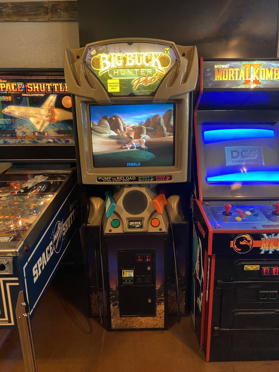

I got the first game from this last captain’s run repaired and put out on location. I have always wanted a BBH game but felt priced out on the dedicated cabs. I got two non-working ones at auction and fixed both without having to buy anything additional! One was just a dead cmos battery and one needed the motherboard recapped.
