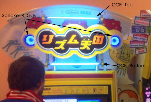

It would be good if someone who own that cab could physically indicate where lightings are located (as the speaker R G and B among others, as well as others that we can not determine (I think start P1 is easily to find: D))
Stay tuned! I think that the ouputs add-on for all io board approach!
seems pretty straight forward to me. each button for each player can be illuminated.
the Speaker R G B and CCFL are in the marquee section. the speakers can be set to light up in red, green or blue, or combinations there of

Here is the outputs pinout for Rythm Tengoku with an i/o type 3.
A type 3 is essential for the lighting.
Although the 60 pins connector is use, the buttons do not light up with an i/o type 1.
But no problem with the inputs, the game is working.
