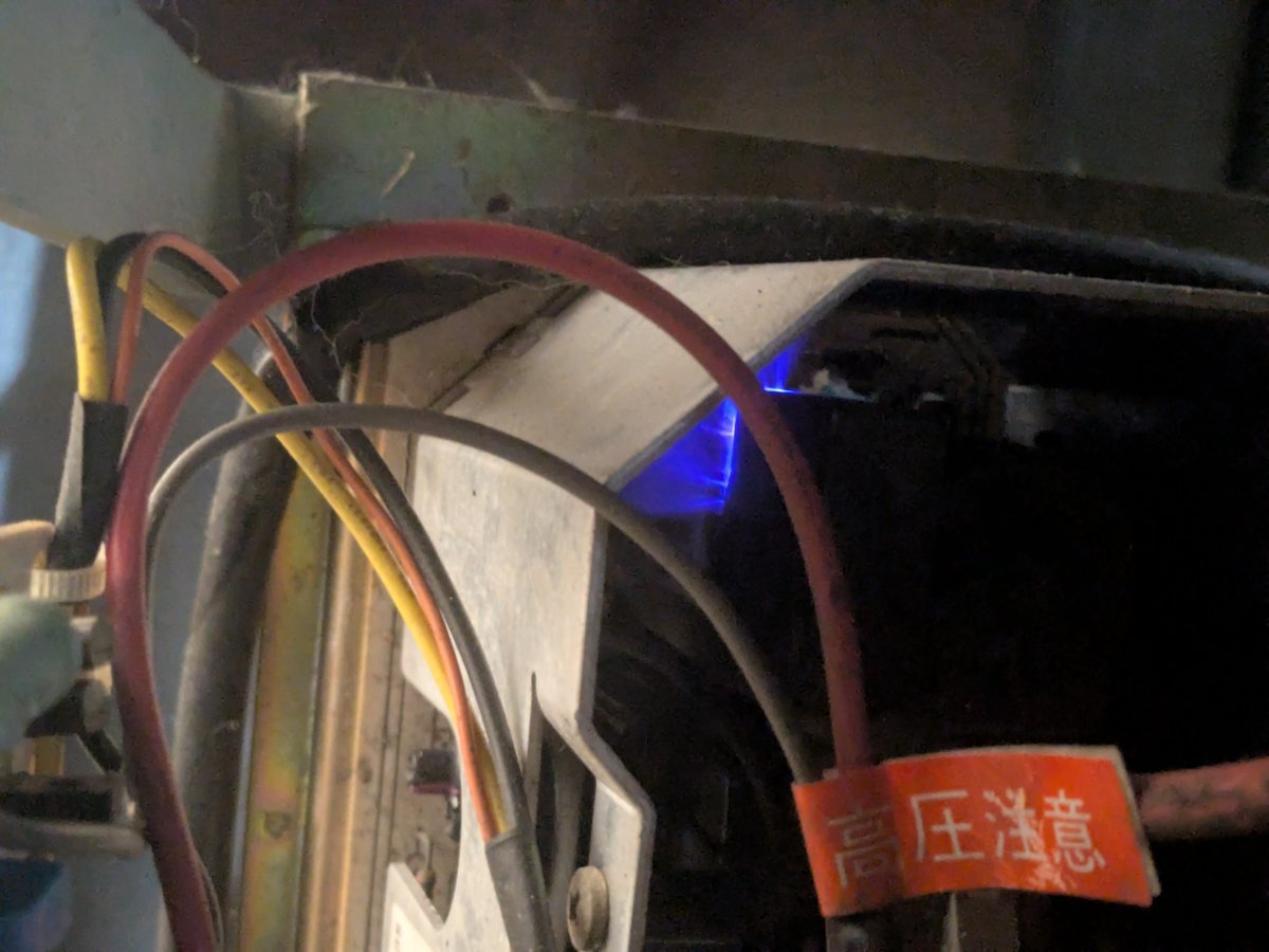

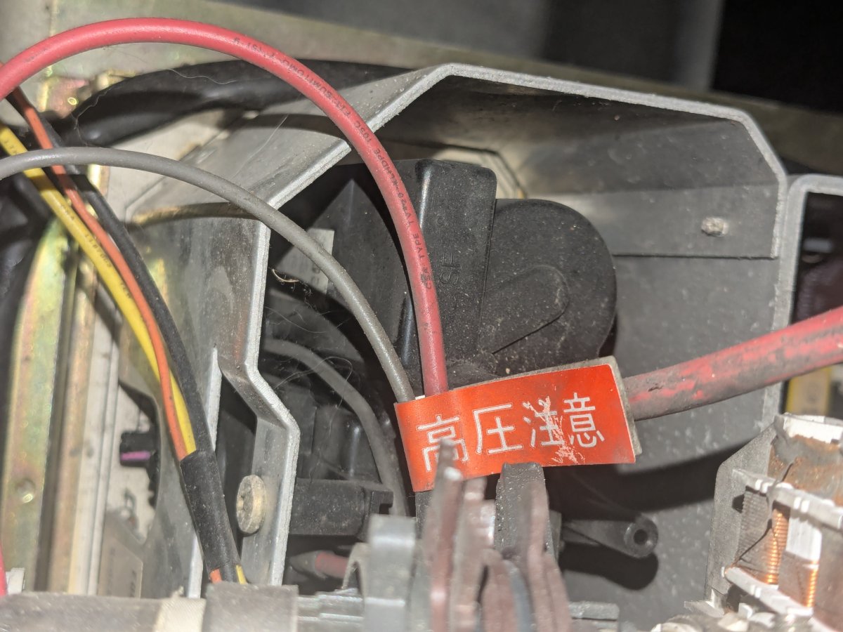

I did some more digging on my ozone smell issues and after thinking it was the anode cap (cleaning and re-seating it) I discovered what was really arcing: the flyback.
Chassis is a Sanwa 27Z21J.
I've heard some people say its trash and I should bin it, others say I need a new flyback, and others still say I just need to clean it or possibly varnish it.
Any thoughts or tips?
