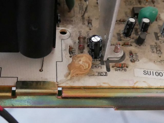

I suspected it was high HV causing this. After I removed a mountain of glue that was placed on top of the pot:
I turned down the pot (counter-clockwise) and the interference on bright backgrounds went away. The shaking in the test menu is still there. Also, as a cause of turning down the pot, the screen expanded a ton and the corners went super blurry.

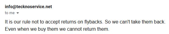

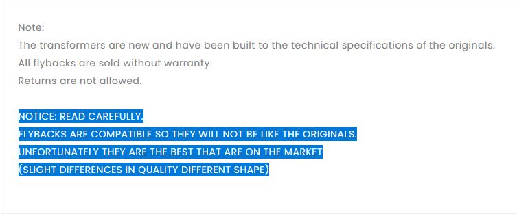

I'm trying to get the flyback returned without Paypal being involved, even paying for return postage. However, Tecknoservice doesn't accept returns. Their reason for this is because they can't return them, you can't either.
They also changed the product description for the flyback, which to me, is kind of admitting that it's not a very good replacement.

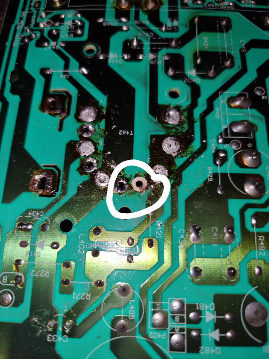

Hey @nem I'm in the process of changing the flyback. One solder pad broke off but I think it's just not connected anyways, since (I hope) it's not a multilayer PCB. I have a bit of knowledge in electronics but I'm still scared as shit with this old-school HV stuff 😅. Can you confirm I can just proceed?
