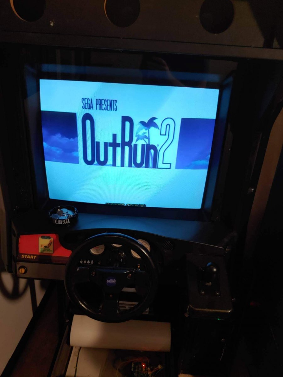

Okay, ingot the new IO and jankified a power setup for it.
Also plugged in the analog harness as is from crazy taxi to the CN6 plug on the new IO
There is nothing plugged into CN3, I have yet to make an adapter there.
I'm now getting past the IO incompatibility screen.
I get a flash of the game running attract mode, but then it says there's no drive board connected to the main board (attached screenshot)
I'm assuming this is because there's no coin meter/pseudo coin meter or the +5v doesnt yet have the 2 pins jumpered, would that be correct?
Incorrect.
the Drive board is the force feedback control board. try to go into the test mode and disable that feature if possible.
but you should probably add the output jumper and the coin counter spoof anyway.
Well consider my nuts busted.
It's been running for a while no with no issue.
No digital controls yet, so I can't play, but the game is up and running.
Thanks for your help guys!
When I get the adapter built I'll post the wiring diagram
