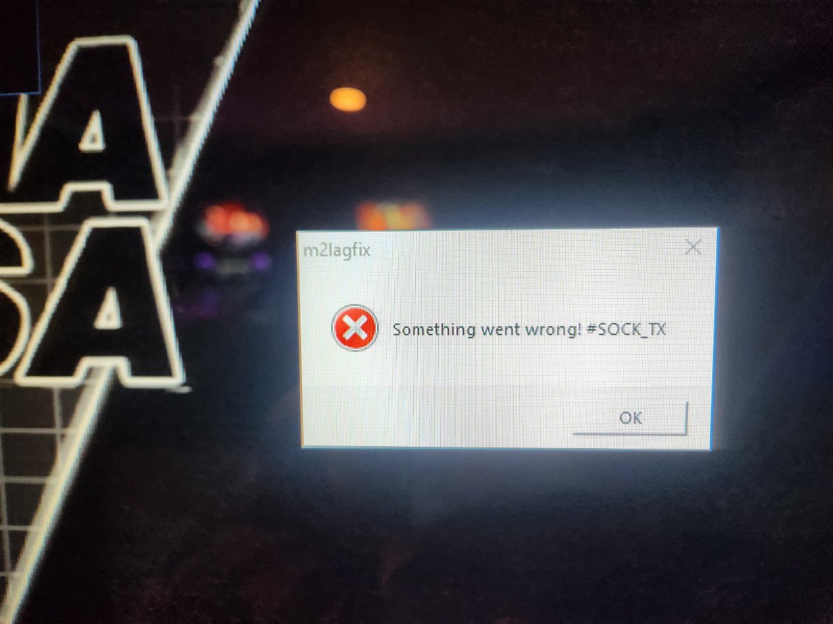

When I try to start Daytona the player 1 will boot but player 2 will not. If I unplug the player 2 LAN cable player 1 will just sit idle doing it's network checking. When I plug the cable in player 1 will boot. Player 2 never does and when I exit the game I get this error.

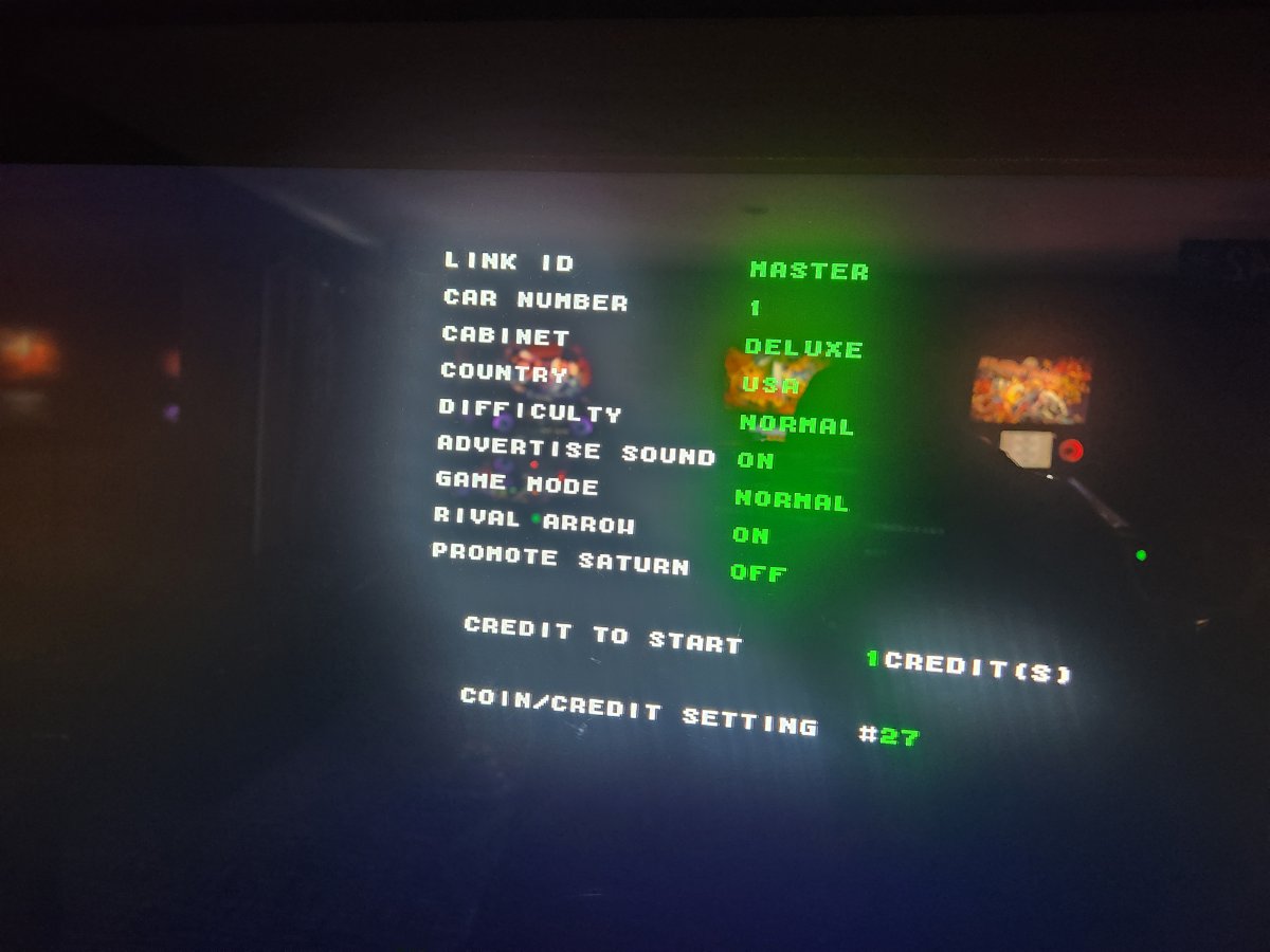

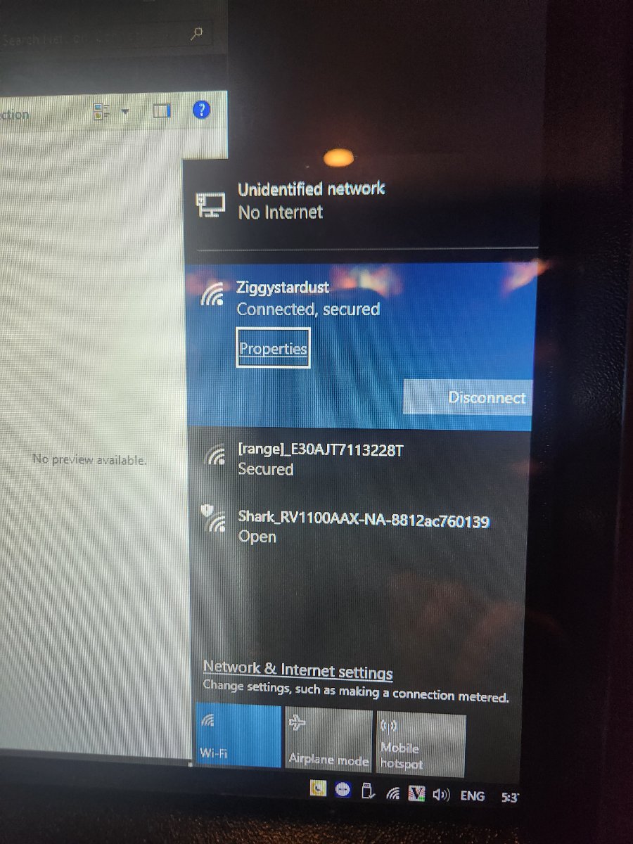

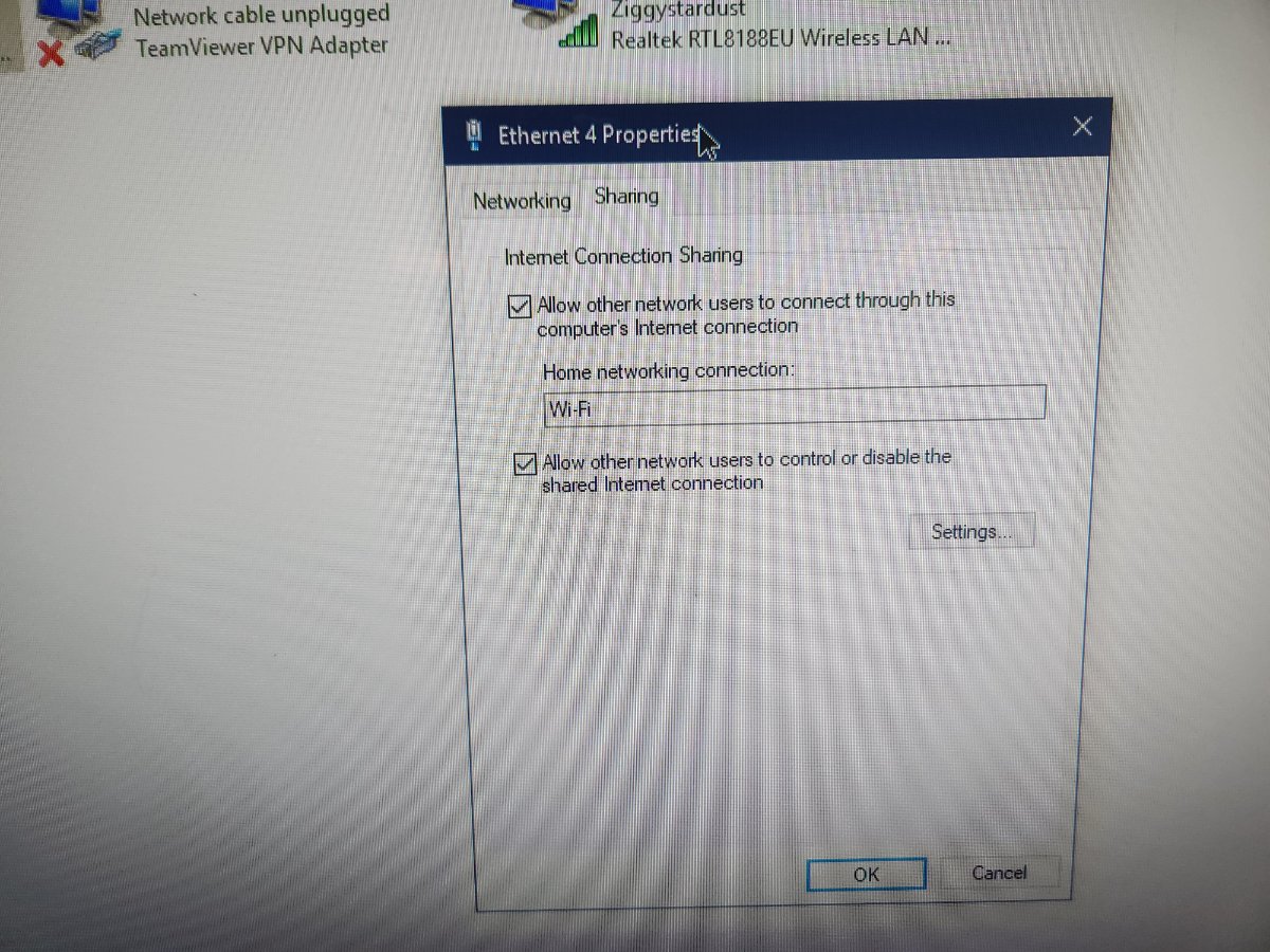

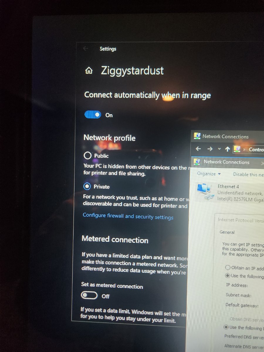

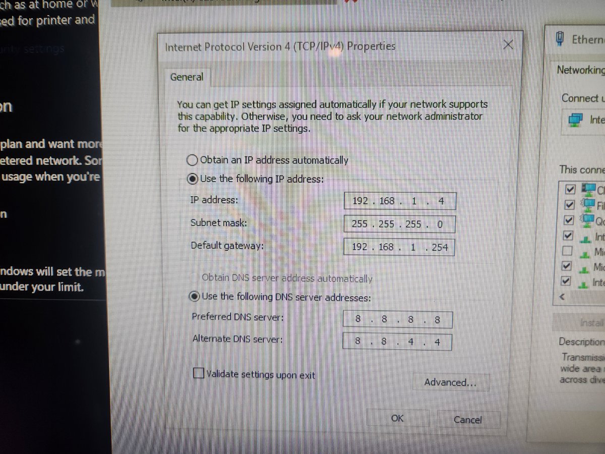

Here are the player 1 settings

When you say "set the network configuration of each emulator in the "Multi" folders of Racecab/Emulators folder of cab 2" How do I do that? I don't see what I should be doing. I think this is the step I am missing
The m2lagfix error you get can come from several things, I think it's easier to put Model 2 games aside for the moment, as M2lagfix patch is involved in addition to emulator and windows network config, and need Jumbo Frames to be enabled (read this : https://github.com/njz3/BFF_gameassets/tree/dd185d82ea3829033a4d99a65767b3a4739778cc/image_njz3 )
Focus on Supermodel or TeknoParrot first, it will be easier.
By "set the network configuration of each emulator in the "Multi" folders of Racecab/Emulators folder of cab 2" I mean opening to supermodel.ini in Supermodel LINK folder for example, and set the address of the current cab and the adress of the "other" cab, iirc.
For TP, launch TP, select a game and set the network properties in the GUI

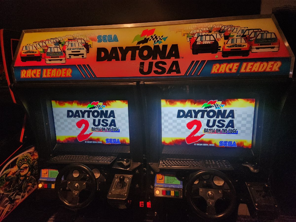

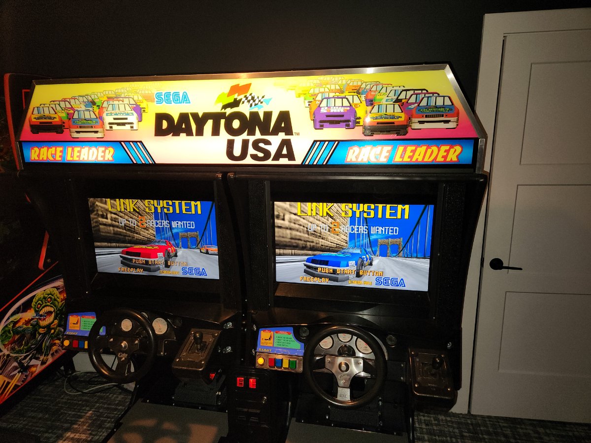

Ok it's been a couple weeks but I finally got a chance to take another stab at this. I have successfully gotten supermodel to link! It definitely wasn't as easy as I had hoped but it's working now. I will attempt teknoparrot next when I get some time. Still no go on model 2 link but im probably missing a detail somewhere.

Having fun playing some linked racing finally! I have all the supermodel games configured and working well. :)

Ok I checked out njz's model 2 files and have now linked model 2 games! So that means Daytona is finally working as it should! :)
