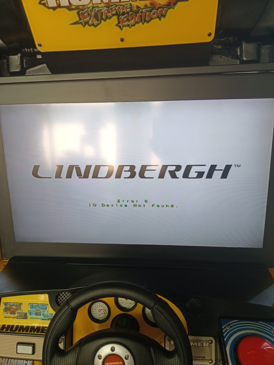

The LED on the Jvs card glows amber. When I remove the video card, it lights up green, when I reinstall the video card, it lights up yellow and gives error 6.
I think a component on this card is defective. I have another one of the same card in my hand, I think I will check it one by one. I will share this with you at the end of my experience.

The problem is clearly visible in the video link I sent. I couldn't find a solution.

Baseboard JVS card failure is a common issue & has driven up the cost of the cards way beyond the value of a used system.
