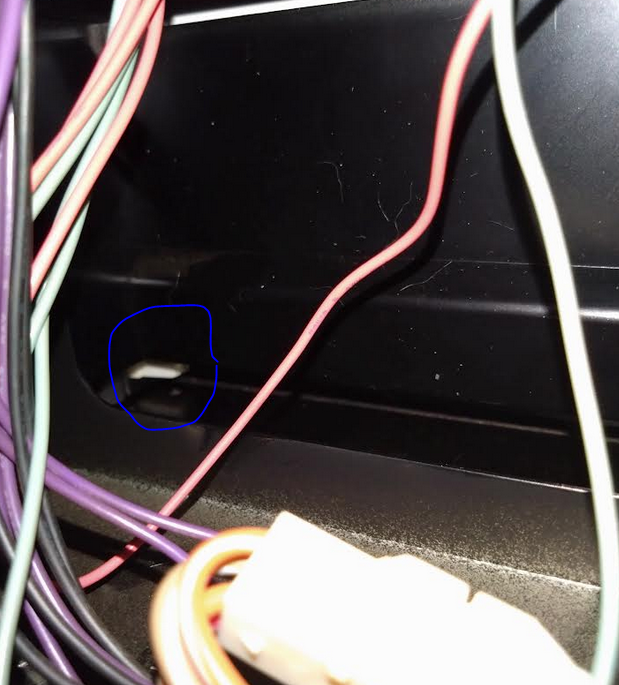

Specifically thinking of this photo; my setup is basically identical to this when you remove the back cover. The stock wiring on those speakers is very much not long enough to reach any of the ports on a commercial monitor like this, but maybe I'm just missing something very obvious.
What ports? The connectors? They're separate from the screen.
As long as you use the same enclosure and fit the new monitor inside it, there is no issue.
The speakers are not connected to the monitor. The speakers are connected to the audio amp which is behind the coin box.
Interesting; I watched several videos of disassemblies of this and must have just missed it, because with the monitor back on the cabinet (albeit speakers unconnected), I just don't see how one would do that.
Do you have to reconnect the speakers before you put the screen itself back on? I took a photo from the back door of my cabinet but I can't even see the speaker connectors from where the audio controller is on the front.
EDIT: Never mind, I found the problem; the two shorter connectors were originally connected to longer cables that were either yanked apart when I took the monitor off and didn't realise it or were unplugged at some point. I'll just have to re-plug them. Thanks for the tips!
