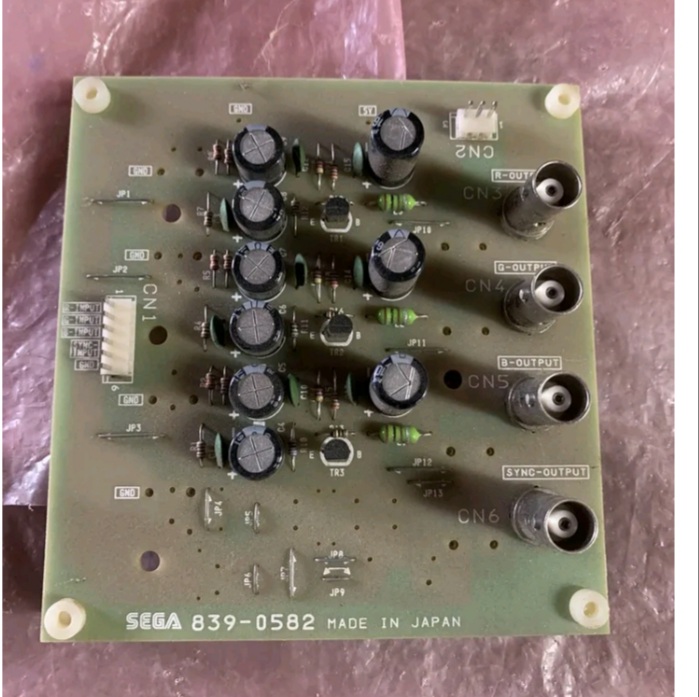

Not true.
That board is for making the video levels safe for the RPTV. Model 2/3 output high impedance video.

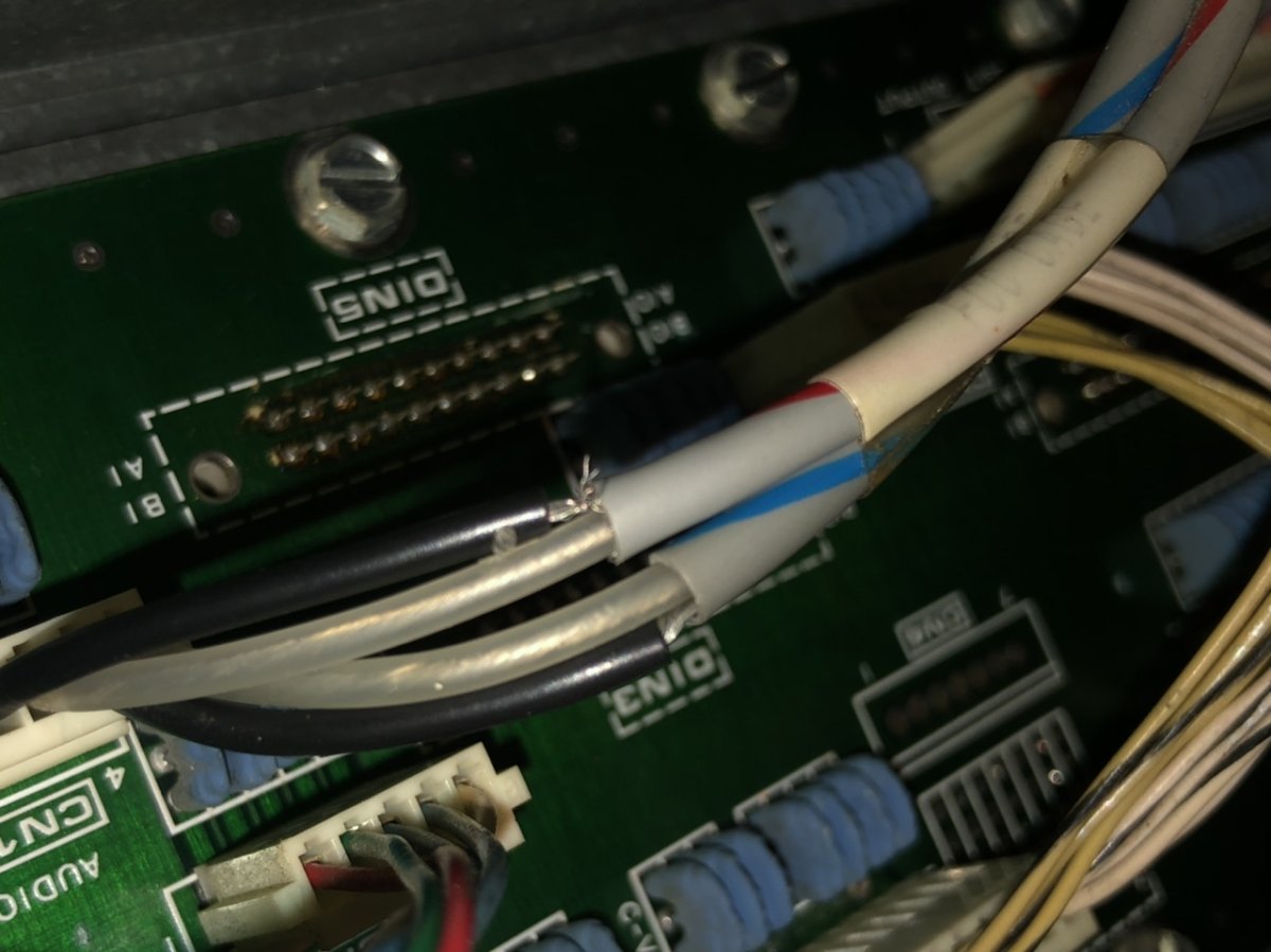

I’m working on restoring a Virtua Cop 2 and I ended up botching a wire repair on the wire that runs from the game board to the audio amp. Does anyone have a spare or know where I can purchase a replacement? Here’s a photo of the wire (before I messed up lol).
What's broken? You can just join the wire together with solder or a crimp or whatever. The connector on the sega side is JST NH if you want to rebuild the cable entirely. It as probably 22awg wire plus or minus.
https://www.arcadepartsandrepair.co...ctors/4-pin-098-jst-connector-housing-jn1001/
https://www.arcadepartsandrepair.co...ns-female-22-28-awg-cut-strip-10-pack-jn1016/
@dos would probably make one, custom (just let him know what's on the other side...)

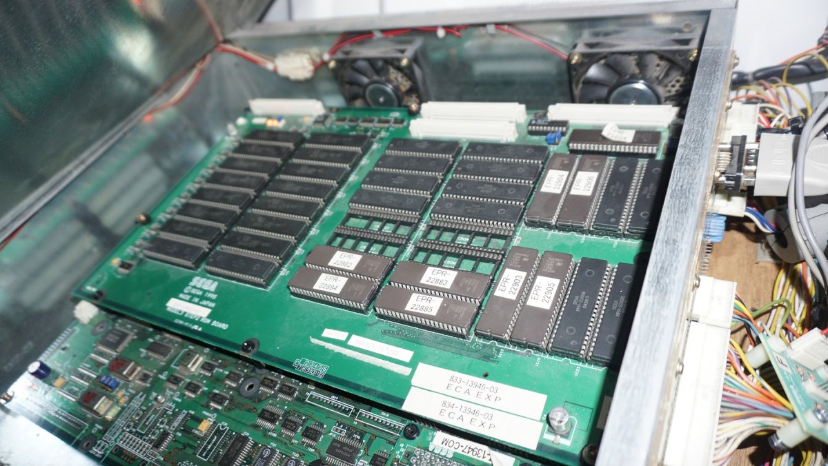

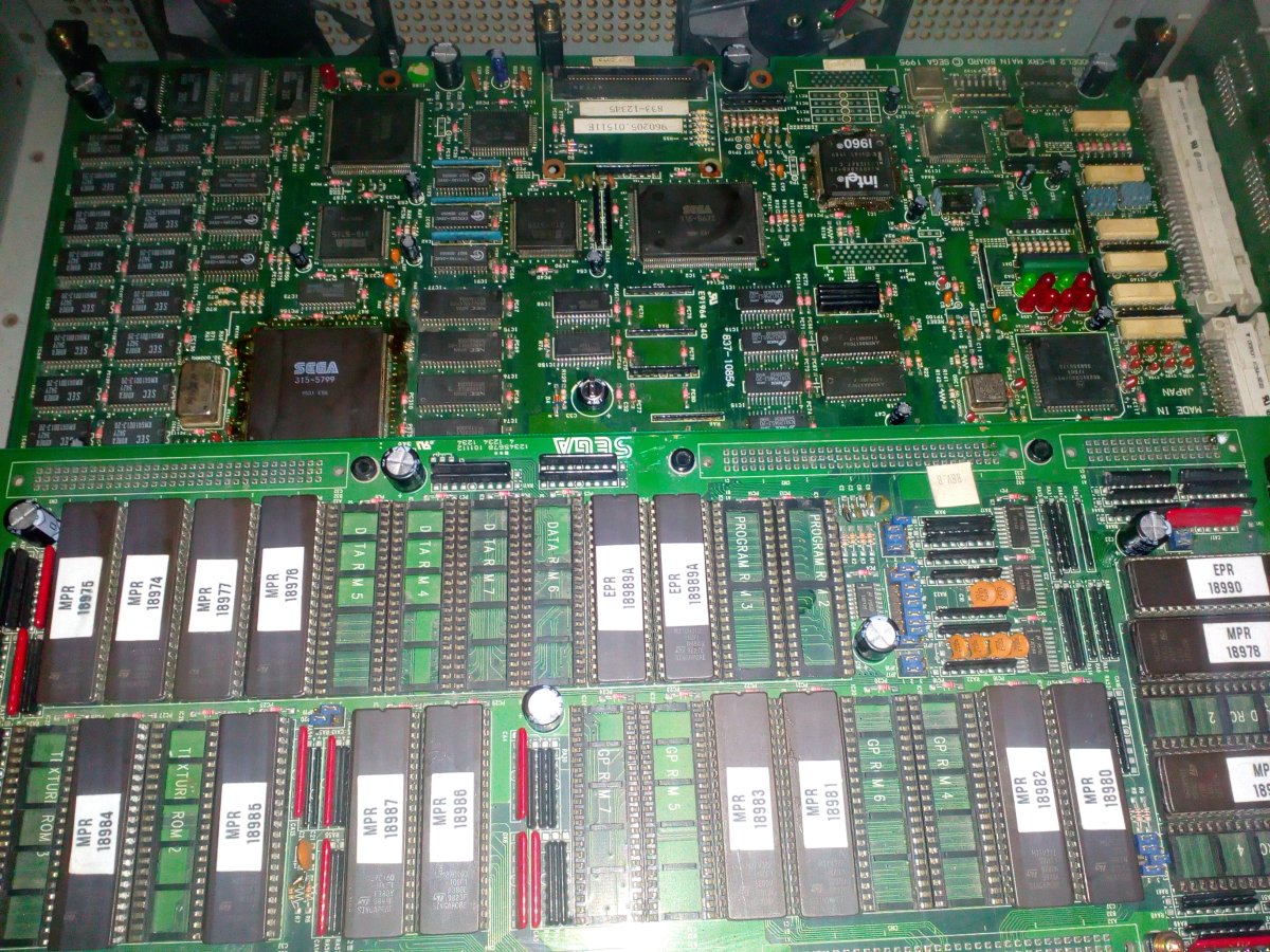

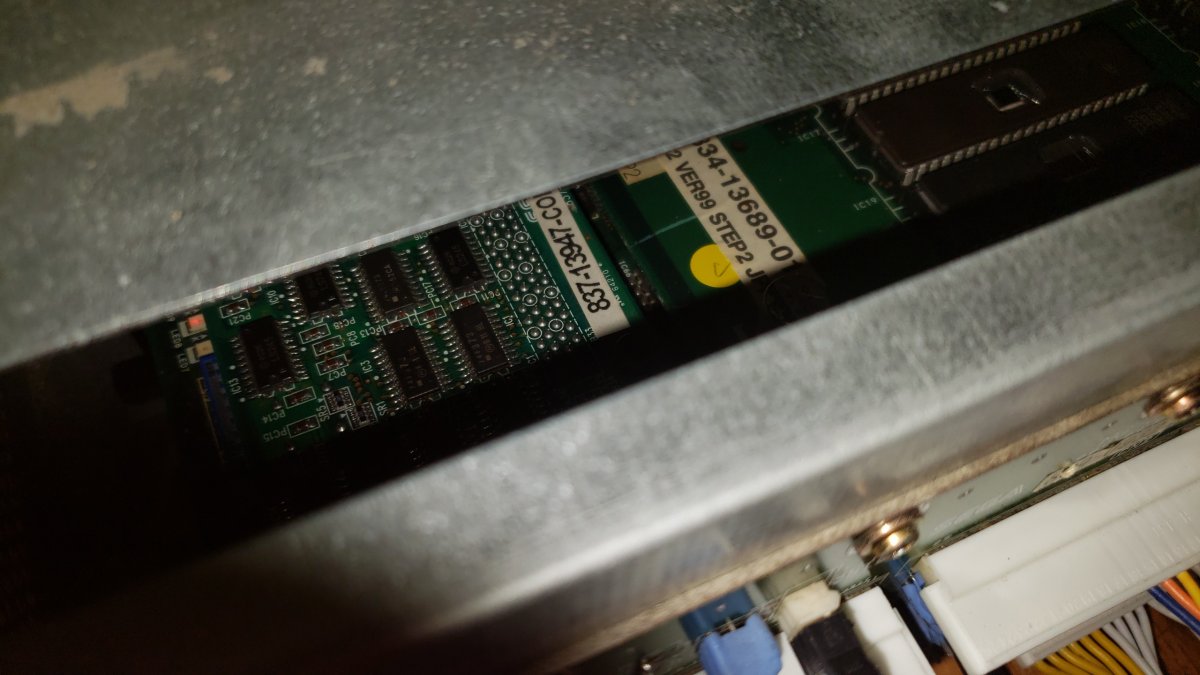

Hi, I got a Sega model 2B CRX with GunBlade game for free from a friend.
After starting the game, it only showed a white screen.
I replaced all capacitors (47uf, 100uf, 10uf, 470uf and supercap)
I cleaned all the pins on the Eprom, some were broken, I soldered them.
And the game starts and is playable, it just has a special problem.
The helicopter flies in the buildings (That's not right) and in the third mission (the ship).
The enemies themselves fall into the water and you win without a shot..
I suspect a damaged one (EEProm or Romboard)
Graphics and sound are ok.
Does anyone know which part of Romboard is causing this?
I know this is a difficult answer, but if anyone had a similar problem...
cmos roms
Program roms
Data roms
Texture roms
TGP roms ????
The test mode should run a test on the program roms, but if you have a programmer to check the code it's not that much trouble to just validate them all against the mame set. Also in your photo there are two chips with the same label, so that's a little weird. 18989a
Thank you for the answer,
In this GunBlade game, the test is quite limited, it controls only IC and checks all of them correctly.
I changed the labels myself, those floods were ugly, just pieces of paper with a number.
I printed the same number twice, but I tried to switch them between them (Epr) and it didn't help.
I also checked the jumpers on the Romboard according to the image on google and they are ok
The only option is to buy a programmer and check the CRC with Mame.
And upload damaged,
Thank you very much for the answer.:)

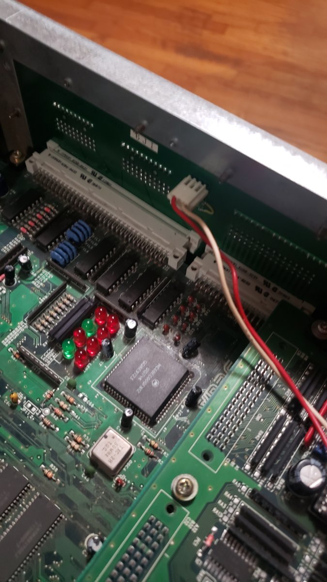

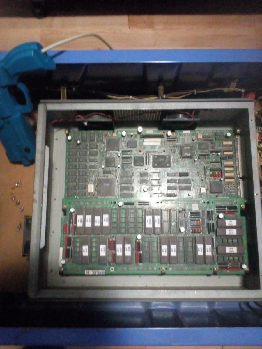

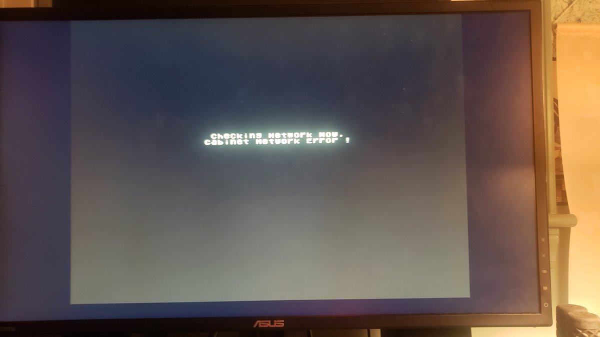

While we're on the subject of ROM Boards, I had successfully converted my Virtua Striker 2 '99 ROM board to Emergency Call Ambulance after changing the jumpers.
I burned the Japanese program ROMs, but as I was booting the software into my Daytona 2 stack, it had shown a "Network failed" message and stood to that screen for about 2 minutes until the game finally loaded up. Supermodel has been coded for the game to skip this screen via the Games.xml.
Is there a way I could patch this message to be skipped on real hardware? Temporarily using it in my Daytona 2 stack until my spare Harley-Davidson arrives, which I will be using a donor board since I already have LA Riders in my collection.
Special shoutout to Vamino/Ringo of UKVac (Ian) for selling me his ECA security chip, required for the game to boot.
Glad the package arrived OK.
No idea why it's doing that, mine boots straight up as you can see in my YT ECA attract video.
Are your jumpers set the same as in the following (blurry!) pic?
Is the network board attached?
Whoa snap! That's supposed to be removed? I had thought about that earlier. It makes sense since yours seems to be the dedicated stack. Sega sold some ECA chips and the sec board as a conversion kit for D2. Maybe I'll try removing it from the Harley tomorrow if all goes to plan.

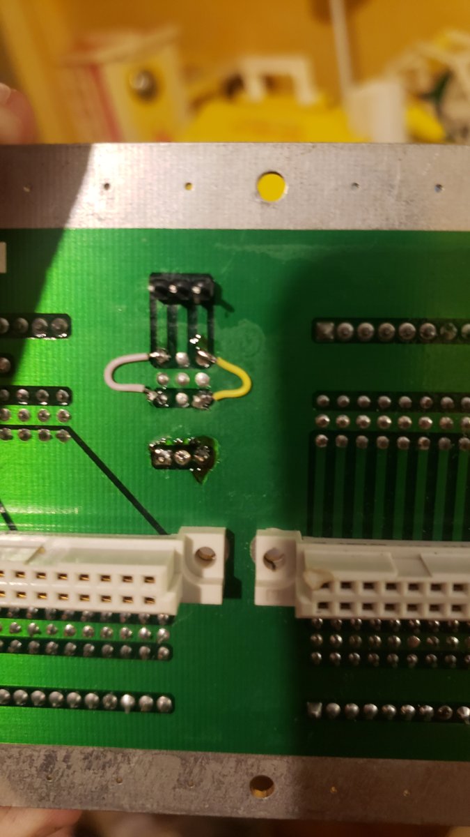

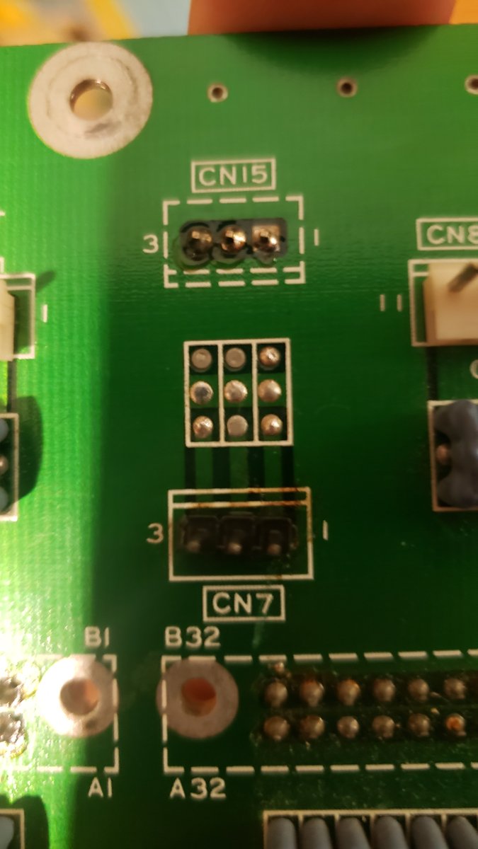

The Model 2B/2C filter board has two unused connectors on CN7 and CN15 that seem to bond together. 2A has these in a different spot also.

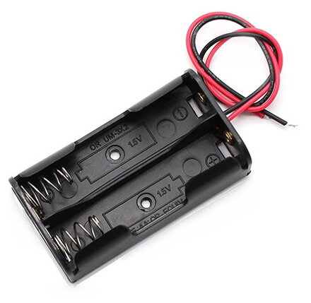

Hi,
I solved this problem like this..
I used two rechargeable batteries (1.5v).
I put two batteries in series so that they are together (3V)
I connected primo, from the bottom side to the pins (Supercap)
I left the supercap connected
I left the game off for a week and the high score remained saved,
After a week, the batteries dropped from (3V to 2.9V)
Batteries are charged while playing.
It's working fine so far
