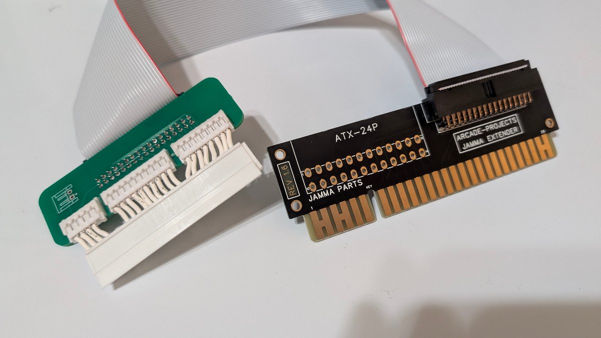

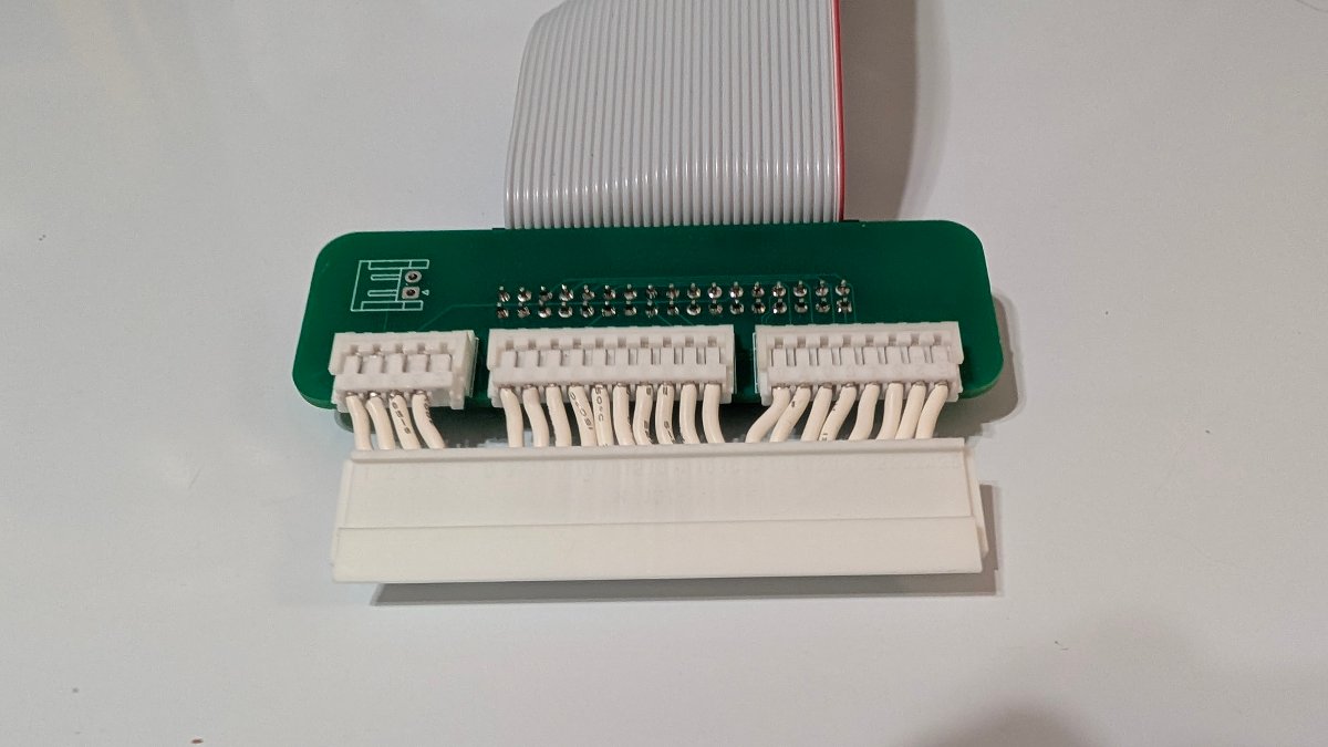

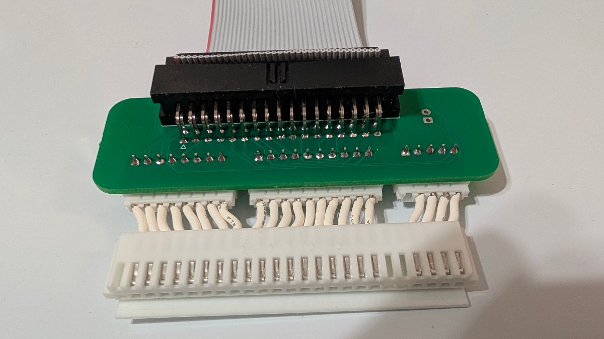

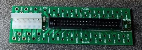

I bought this Jamma + ATX adapter from YAJ, so I can test if my Model 2 board works correctly.
https://buyee.jp/item/yahoo/auction/r1160975137
Now that I know it works fine, I will start making a harness to power it from the 15A JVS PSU I bought a few weeks ago. And then convert that board!
Lol, that's the one listed in the first post of this thread. Glad it works for you, I hope the proxy+shipping wasn't too bad.

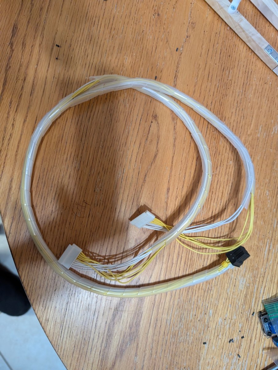

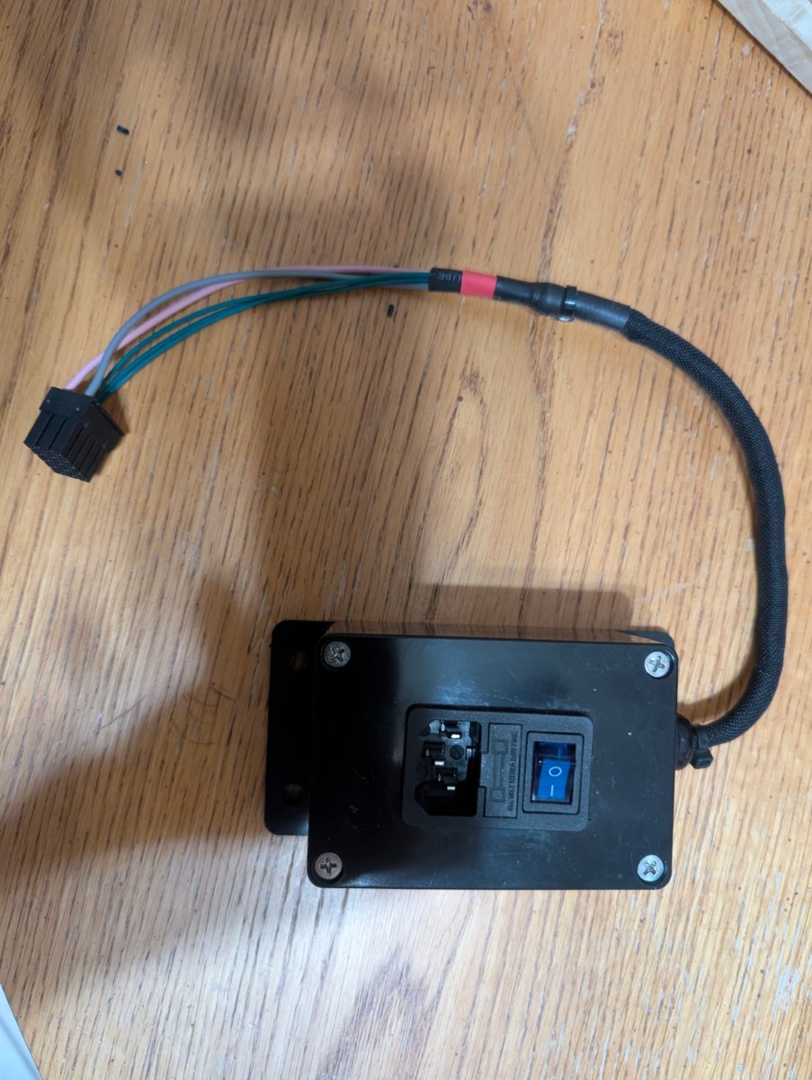

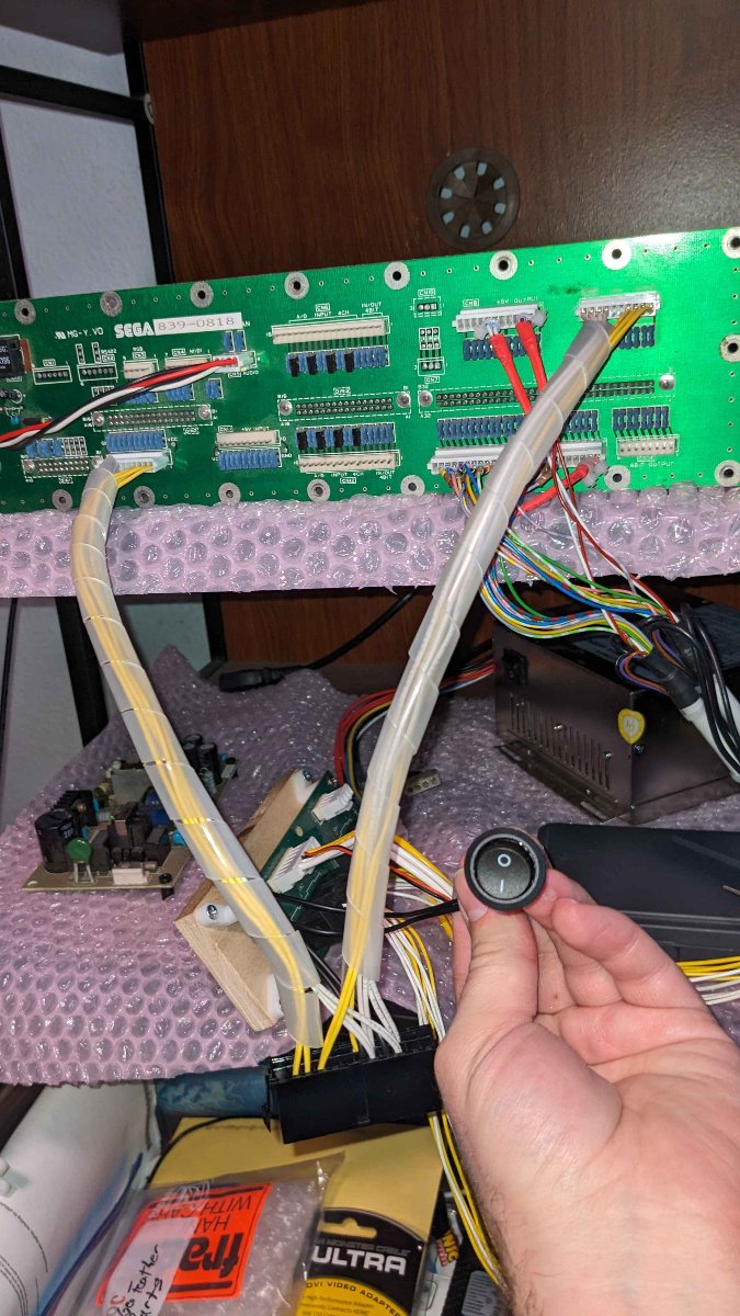

I actually dabbled in making an 24-pin ATX cable for @AkedoJune with good results:

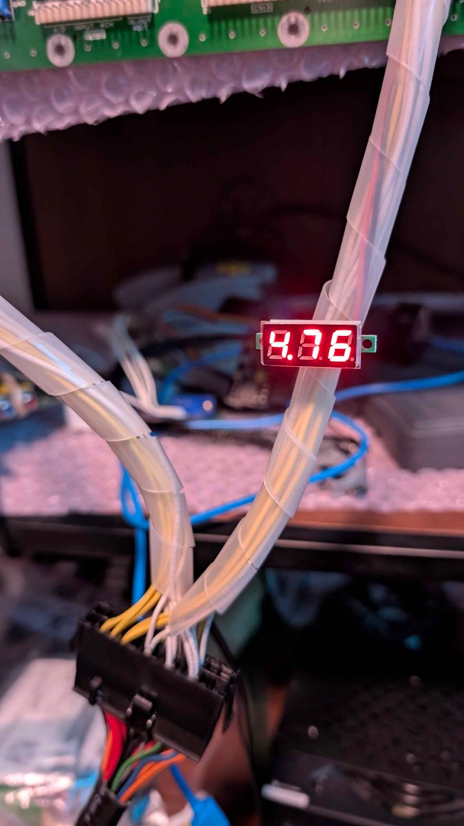

You should test the voltage at the board as not every ATX will produce the 5v proper and it may "starve" the chips on the model2 board.
