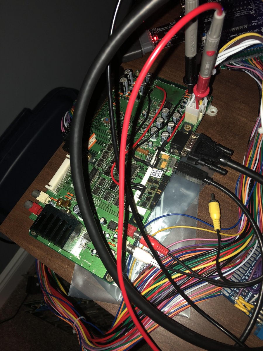

Just the 8pin cable from the IO board to the 8 pin on the naomi
Just fired it up again this morning and working perfect

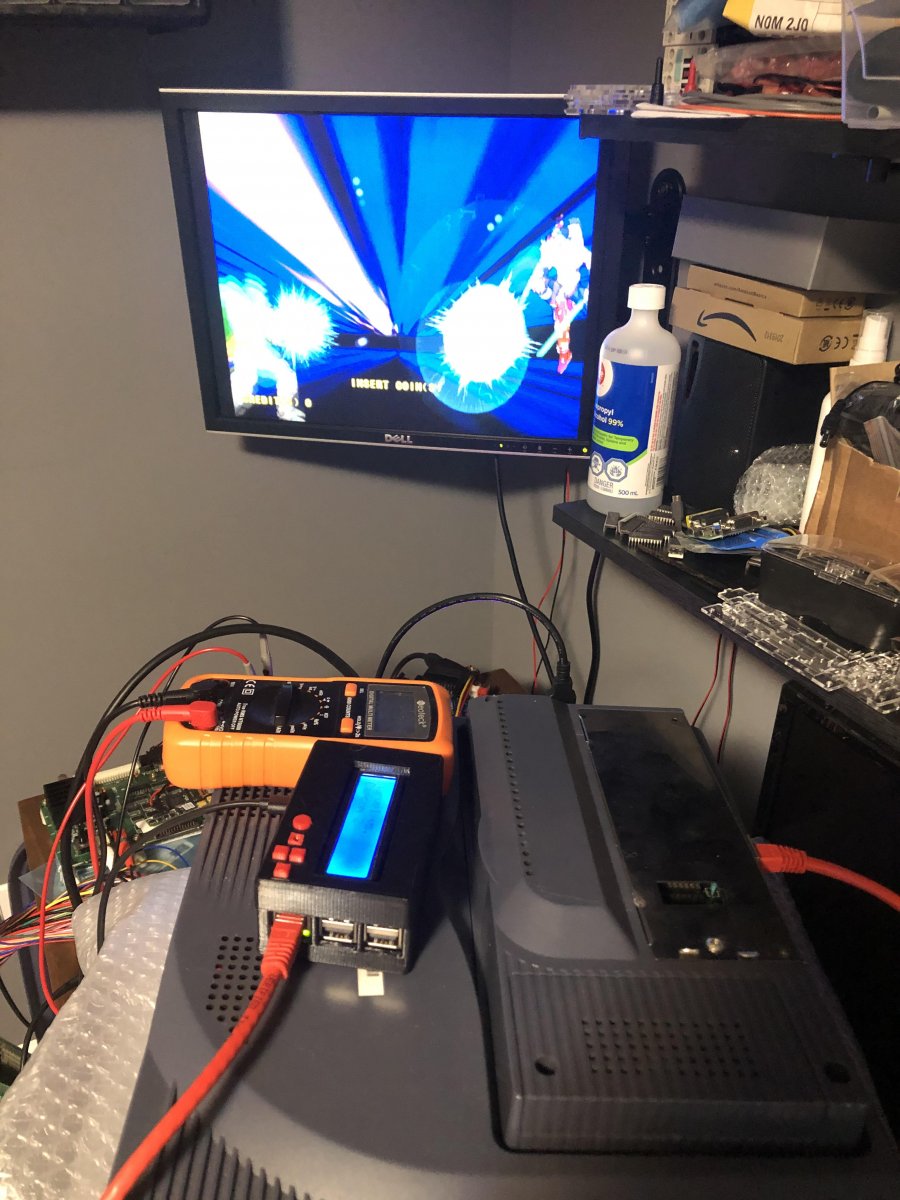

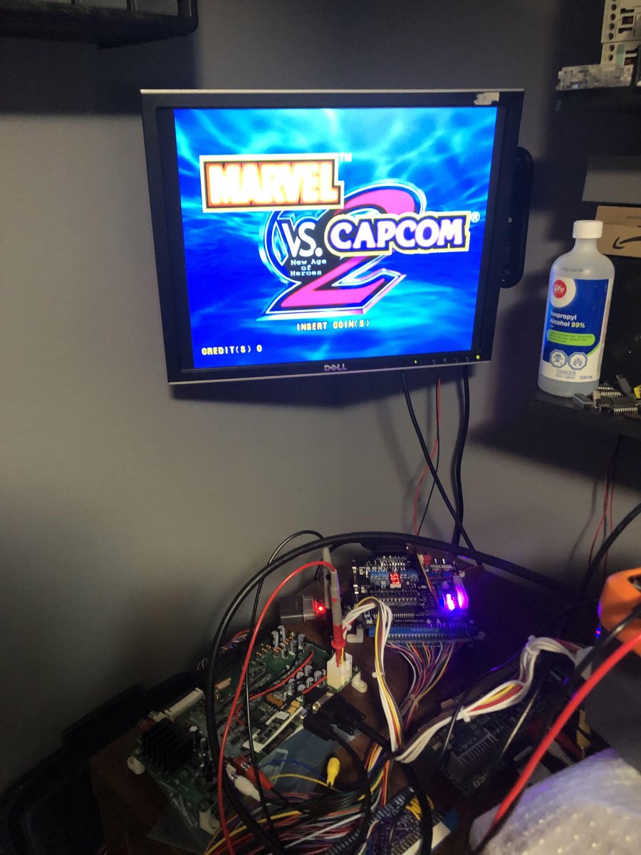

Here are some pics - hope they help
If u need some other pics let me know

Well I can tell u that it seems to work fine for me and I have left it running for a few hours - no issues
