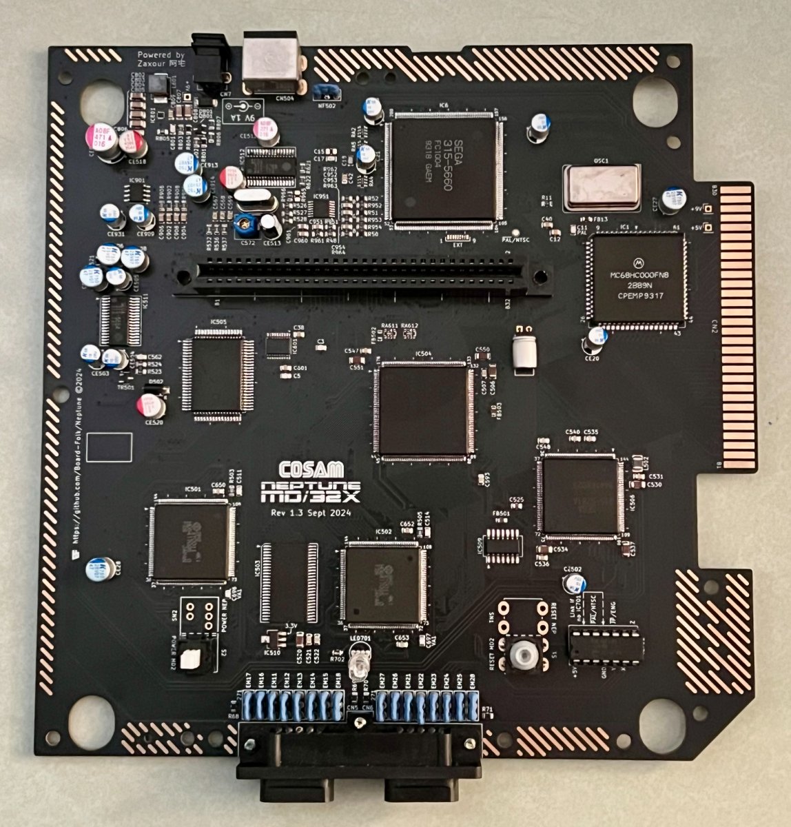

Here is my finished build.

Another question - watching Tito's video again - he removed 3 capacitors as he was building a NTSC version - it looks like you left the PAL resistors in, so must have a PAL unit, or was that specific to his build?
@leonk I used them as I had bought them a while ago and on standby.. those are very low ESR. But I'm sure regular electrolythic caps will work fine.

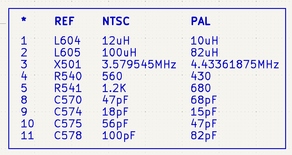

@mathewbeall good question - I swapped all the capacitor and resistor values for NTSC signals, see attached image. In the build C15 and C576 are not populated. R965 is a jumper used to bypass the built-in RGB THS7374 low-pass filter.
