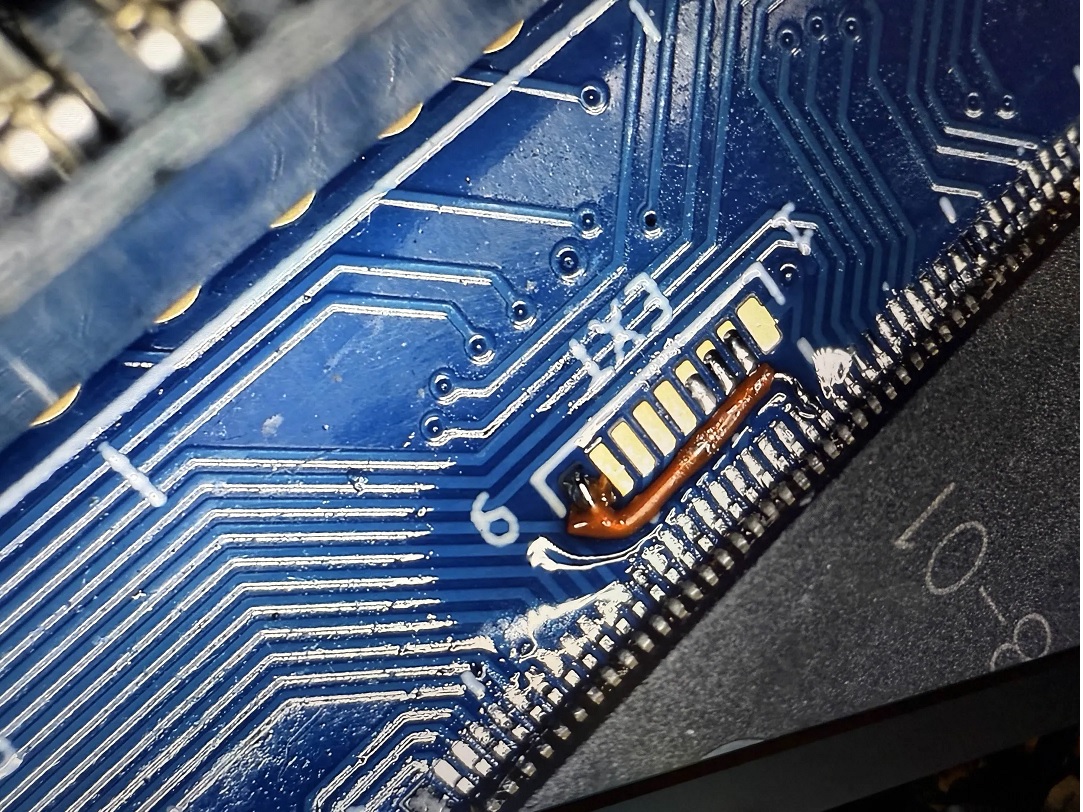

Wanted to update everyone an issue was found on the Neptune boards that causes the Region to be erratic, serial not to work properly, and CRAM dots. Been working on this for over 2 weeks in Discord and thanks to dr-goobur, we have a fix. Please see the issue and the fix on the Git. https://github.com/Board-Folk/Neptune/pull/5.
Special thanks to donutswdad for discovering this issue, although it drove people mad for a while cause nothing made sense. lol. noobguy for relentlessly looking for the solution and creating the Git issue and everyone else that contributed in Dubesinhower's discord attempting to figure this out.
This affects every Neptune board in existence. A fix will be applied to the Gerbers for future boards.
