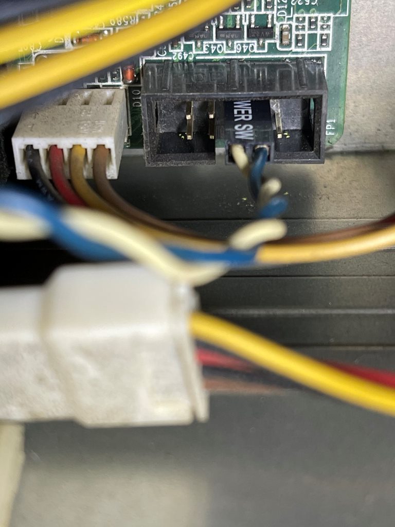

What pins did you attach the switch to on your video??
so thats the upper row? also you removed the other jumper?
Yes. You need to remove
I been busy but tried the switch and my PSU still clicks and power to the motherboard shuts off. I need some time but will try a reg PC power supply when I can
