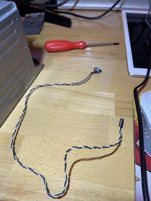

I have removed this cable from an old pc. Exactly were i need to plug in?
For a power button? Pins 6 and 8. Should be the two under the missing pin in the 2x4 pin block under the graphics card. Then try cycling the power a few times (other thread said that helped).
Looks promising, should now just need to setup the CMOS settings that got cleared. I think you can do this from the test menu, accessed by using one of the two buttons on the rear board above the ATX plate (not sure which one).
Edit: tested it on my end. SW1 will go into the setup menu where you can set the clock.
But can i take off the cable and the switch? or must be there for ever?. Let me check :)

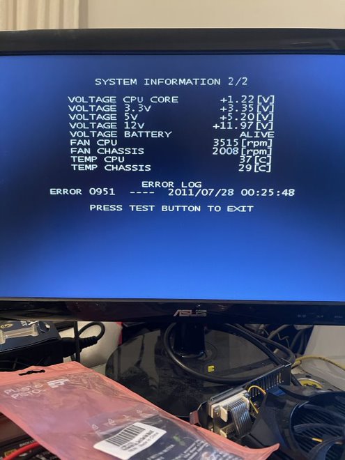

This non working Sega RE2 board, now its alive. Thanks @Kujako for 24h of support. This cable did a great job.
Now, i can join the test menu and set time and date.
As you can see here, the voltage and battery seems to be ok:
Thanks also @stj for your answer.

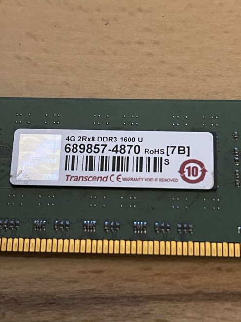

I will upload a video to youtube in 5min. How much ram i can put in?
Edit:
I think you're stuck at 4GB. I suspect it's running 32bit Windows which limits the addressable RAM to 4GB (2^32/1024). In fact, I seem to recall that due to overhead Windows XP can only use around 3.6GB.
