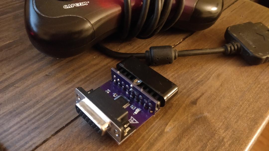

I think I soldered it correctly. "Front" is facing out. If I did something retarded I can probably desolder it. Even if I can't I have spares as OSHPark makes you buy 3 PCBs minimum...
I am using one of those groovy SF Anniversary controllers.
I am using one of those groovy SF Anniversary ccontrollers.
Ok, that is the correct orientation. I've only tested this adapter with official PSX and PS2 controllers, and a small handful of third party controllers. It could be a compatibility problem with that particular controller. Do you have an official PlayStation controller to test with?
I might. Will have to dig thru some boxes or ask some buddies if they have one handy otherwise. I'll see what I can find and report back. Thanks man.
