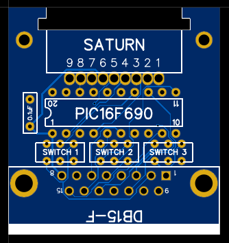

How do I start a continuous shot
You mean rapid / autofire?
The particular adaptor you show is an older version with no such feature. The newest design by Arthrimus has autofire and button mapping.

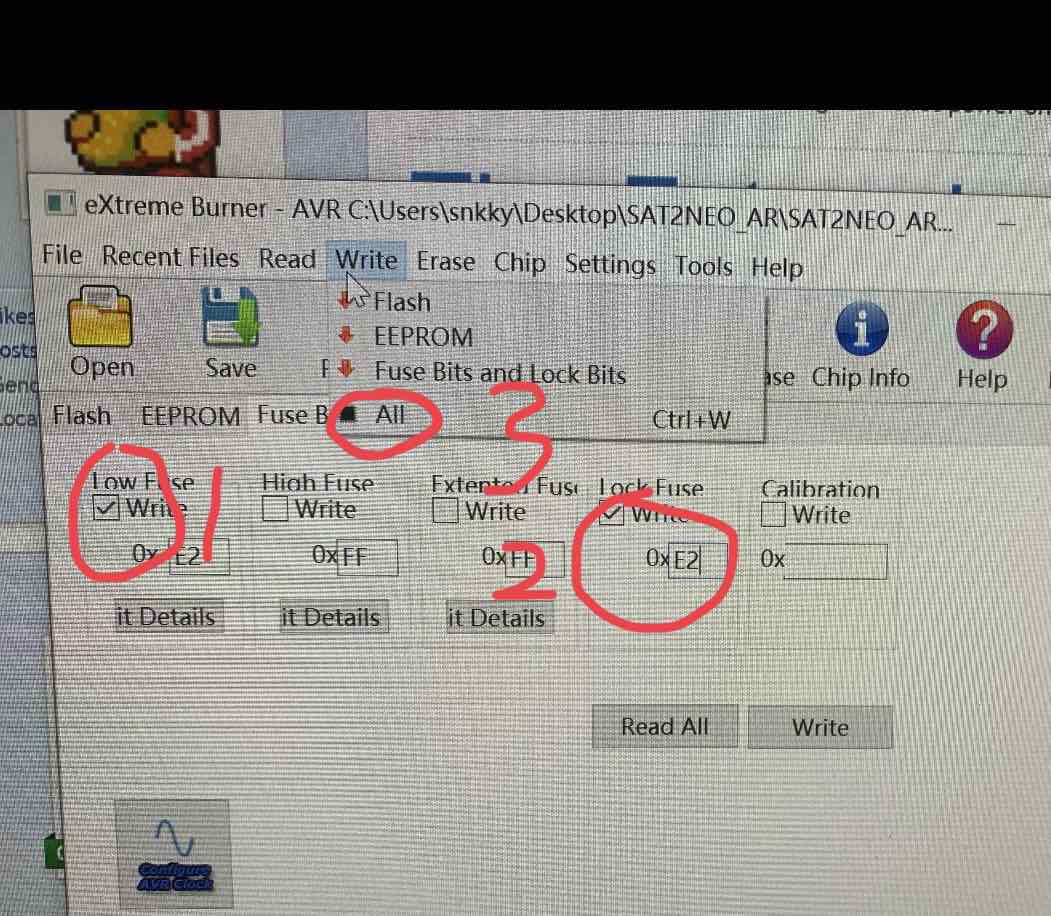

No reaction after inserting the game machine,The LDE light on the adapter is not working either,Ask great God to teach me this what problem
Soldering on a few of the Saturn connector pins looks light.
Once you have it working, don't forget on first power on (after a fresh program) you need to map the buttons.
Only the directional keyboard works at present,The coin can only be pressed at the beginning +AB at the same time, no other reaction,The LED lights are not on,Please advise the great God
Low fuse is good.
No other fuse settings need be applied.
As mentioned in the instructions and my post above, upon first use after programming the buttons MUST be mapped. This only needs to be performed once or when you wish to alter mappings.
Plug it in, and hold down START plus any two face buttons for a few seconds...
This enters button remapping mode.
Press button A once, then button B twice, and so on until all buttons (ABCXYZ) are done. This maps button A as input 1, button B as input 2 and so on.
Then press START again to exit button remapping mode.
Your LED is soldered on backwards.
I believe your LED is connected backwards. That's the only thing that would prevent it from working. :)
